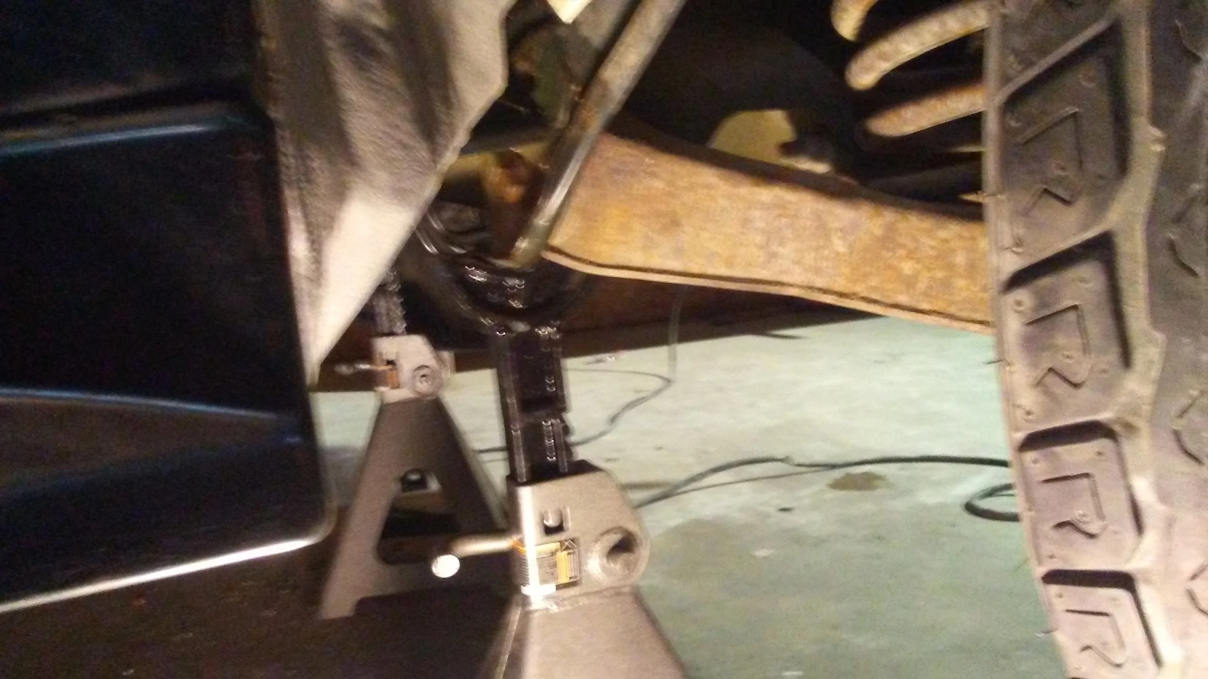

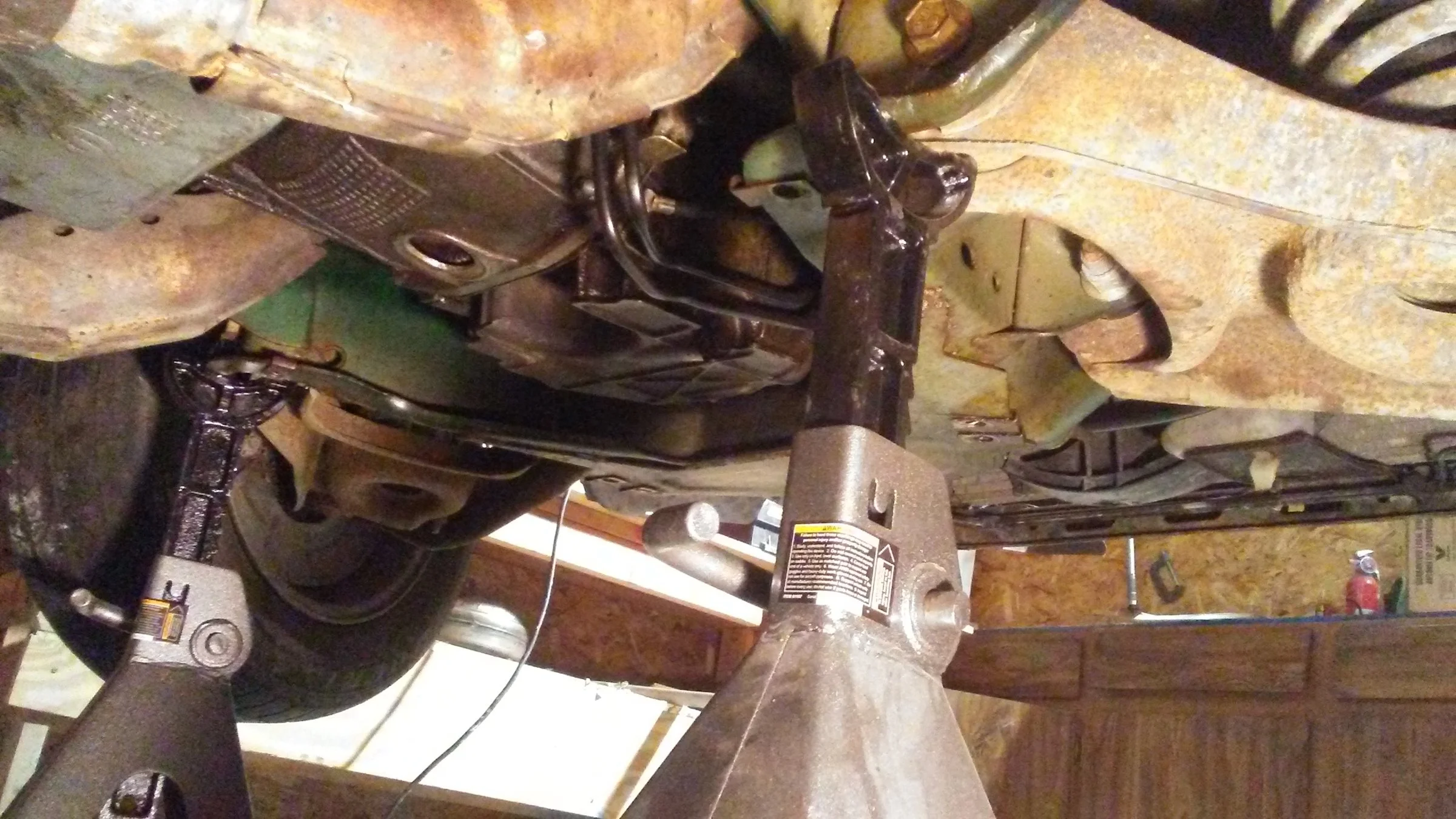

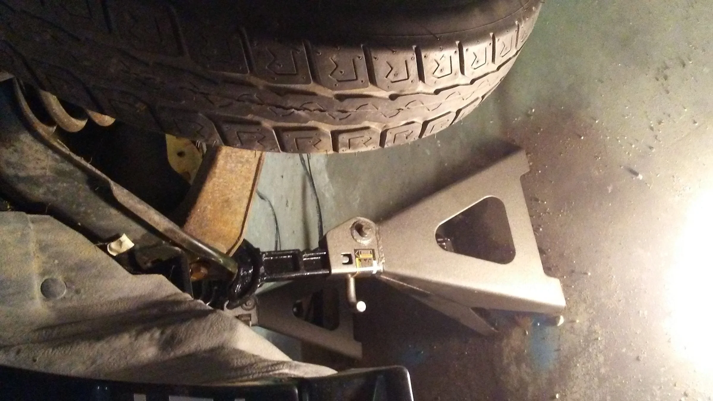

i removed the k member and did it from underneith, though my egr tube was broken. Had to use a 4ft breaker bar, the flange bolts are tough to break loose! Heat and penetrating oil was a must. 2 of 4 studs broke, $9 to replace
Not sure if its the best place, but was most convienient for me being able to remove trans & exhaust
