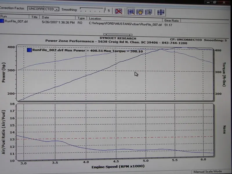

I love low-end torque....car's like an automatic. If you wanna pass someone all you have to do is give it some gas.
I also like top-end pull...nothing beats being pinned to the seat at 5000 rpm.
Now, of course I'm boosted (only running 7-8 PSI)....but when I had a N/A dyno pull I hit my 300 at roughly the same mark. The heads are cheapy windsor Jrs w/ a bit of a port job, cam at that time was still a blower cam w/.536 lift (1.6 RR), and the intake is a ported 94-95 cobra. This was running LTs and a BBK H with borla cat-back. You figure that it's a pretty low budget build-up as the intake came on the car. Heads and cam I got for $850.
every 2v and even the 3v I've been in just felt like a dog. The only one that felt decent was one with gears
