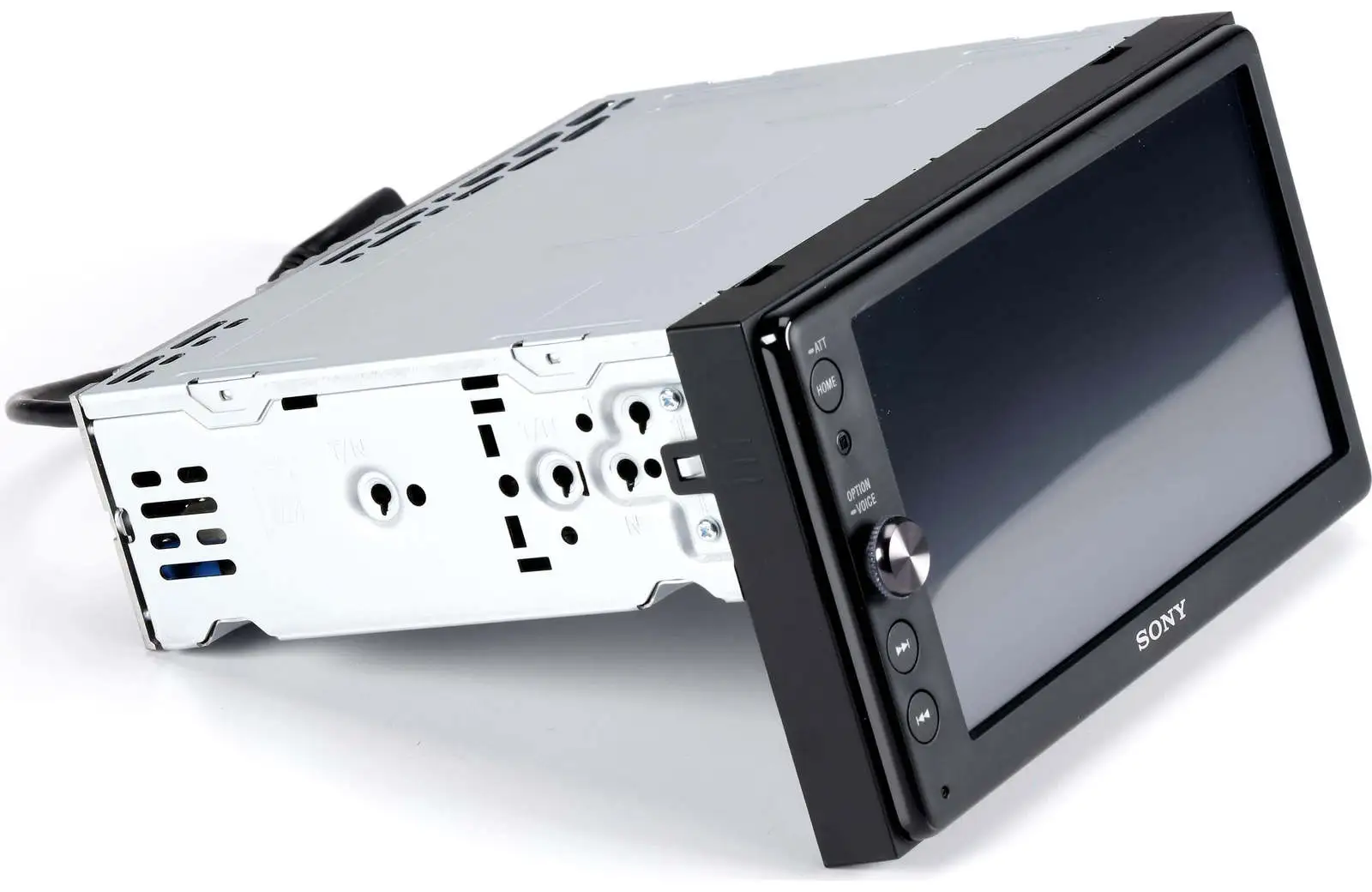

As much as i love having the OE CD player in my fox, i think it's time to modernize. Part of this decision is due to having to relocate the amp under the passenger seat for the aftermarket seat mounts.
Anyway, looking at doubledin units like the Sony XAV-AX100 lack the CD player so they are reallysingle din radios with the DD faceplate, so they should clear easily.
Question is...are there any no drill options for mounting this? I do NOT want to drill into my console with 4 phillips head screws. I haven't pulled the radio out yet to see if the opening would support the radio itself without an external mount kit? Above radio looks like it could almost mount like the stock fox setup.
Finally, i'm tryiung to decide on a nice radio to use. I'd like one with BT and app support. It doesn't need to haveGPS but would be nice if it supported WAZE. A rear camera would be nice as well. Would like something with enough power to power the speakers without an external amp. I don't want to spend crazy money either as it's a car i rarely drive.
In mustangs you don't need that wonky screw on faceplate. The hole is the right size already. With a single din all you need to do is remove the cubby from the factory radio and trim the plastic bracket on the top of it. It'll pop in right below the aftermarket radio. It should fit behind that radios screen.
I hate seeing people screw into the console for no reason.
A regular double din will fit also... but the bottom rear corner will hit the top in the trans tunnel. A few whacks with a BFH solves that problem easily. It only needs a little more room.
