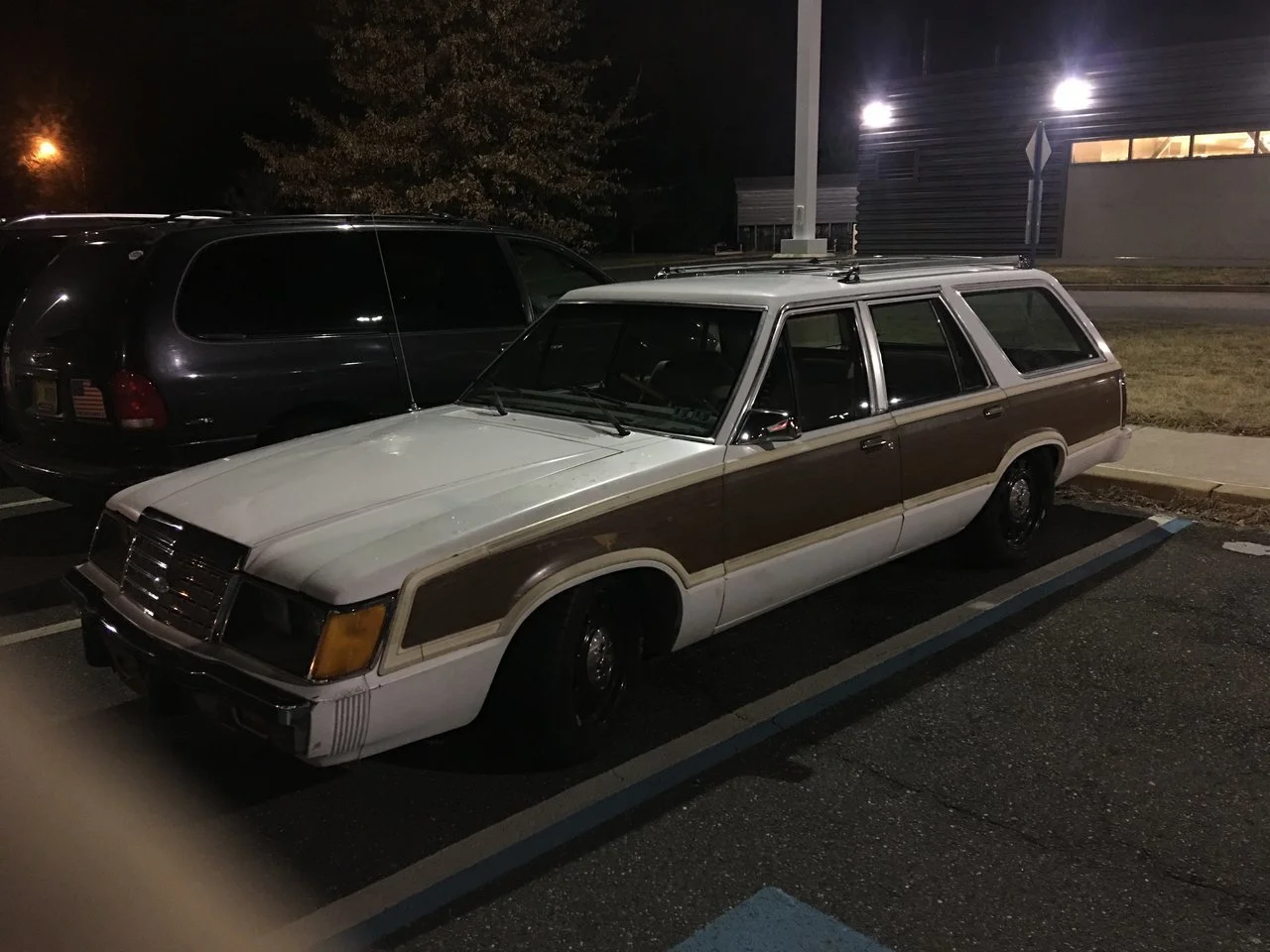

UPDATE!! The water pump issue has been corrected for the time being. Regardless of what brand of water pump the gasket supplied is wrong for my application. My timing cover is late model fuel injected truck and the coolant ports are unique. All previous 302 and 351 timing cover ports are different. Enough of that... I gooped a gasket.

The exhaust leak necessitated a new h-pipe. The water pump and h-pipe were replaced at the same time. The Daddywagon is running!

My assessment: This swap rocks!! I took the engine from a lightning pickup. The previous owner of the engine added cobra roller rockers to the valvetrain. This provides increased lift compared to the stamped steel rockers. I took that engine and converted it to a roller camshaft. Not just any camshaft. I used a stock H.O. fox body mustang camshaft. 75mm throttle body and spacer. The computer is stock mustang A9L. The injectors are 24lb’ers matched to the air flow meter.
This is how I see it; Take the stock 302 foxbody and add 49 cubic inches. To compensate for the increased displacement add more fuel and more air but leave all aspects of engine timing stock to minimize driveability problems. No need to modify the computer.

It’s not perfect. Sometimes at partial throttle there is a little bit of hesitation. 87 octane. That’s what I’m running. It starts runs and drives. I’ve been driving it all week since the friday evening before the super bowl. My confidence is growing with every mile. I am beating the piss out of it. I bought a video camera so I can share the driving experience. As soon as I figure out the camera I will take an idle and walk around video to share. Then a driving video hopefully.

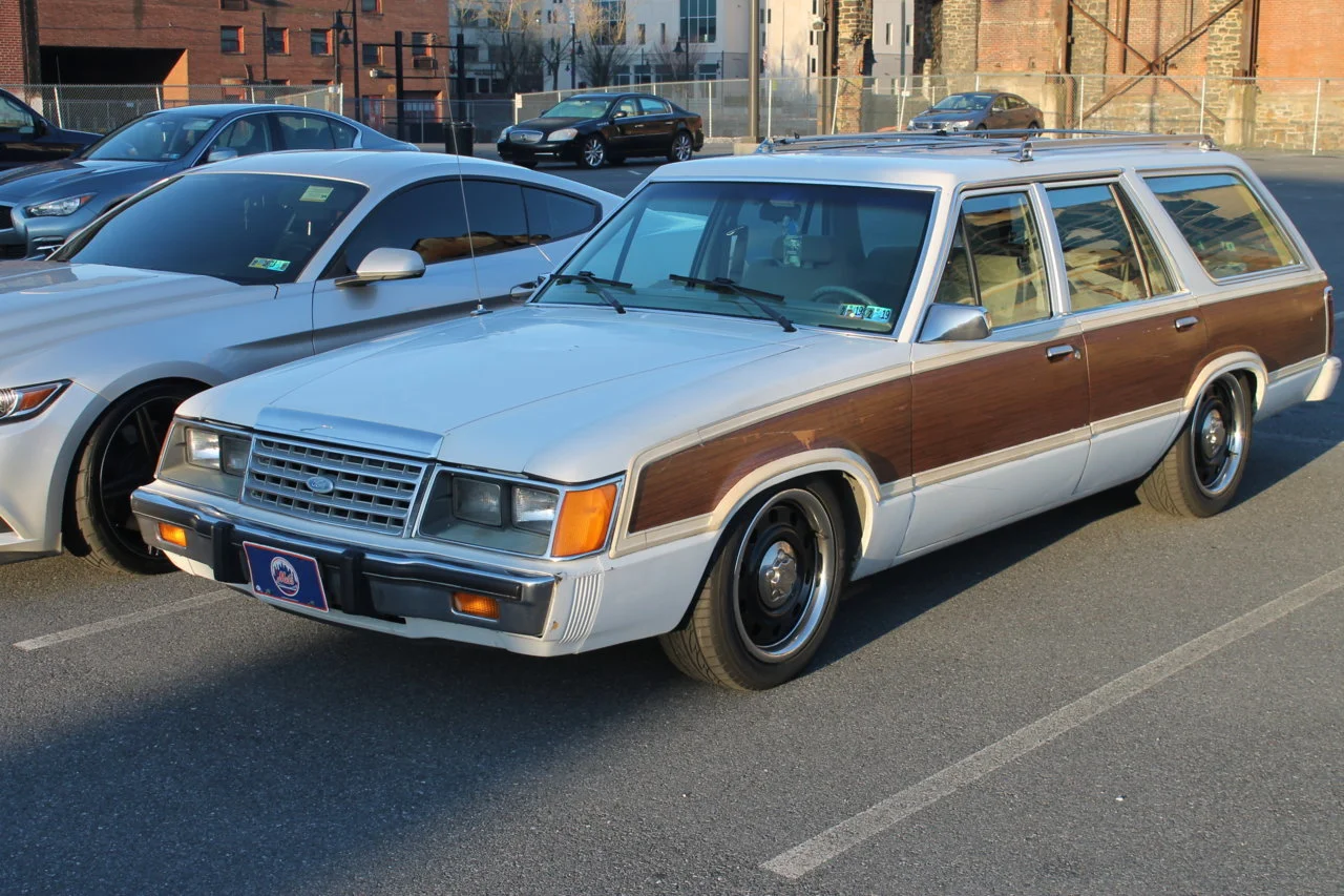

It’s been over 2 months since that last post. The Daddywagon is almost a daily driver. I routinely spin the tires leaving lights and pulling out of places. Today the Daddywagon made it’s first “show” appearance. I drove out to the Cars and Coffee in Bethlehem, Pa. It was a good time and I honestly should’ve stayed longer and enjoyed the experience more. But all in all a successful first show outing for the Daddywagon!
