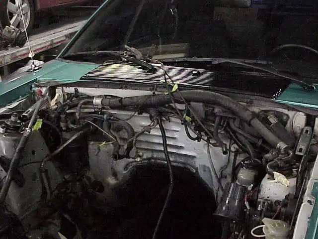

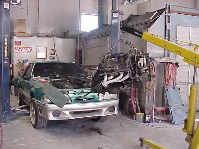

Here is my engine outside the car, its quite grimy lol....

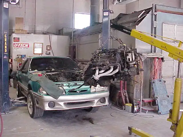

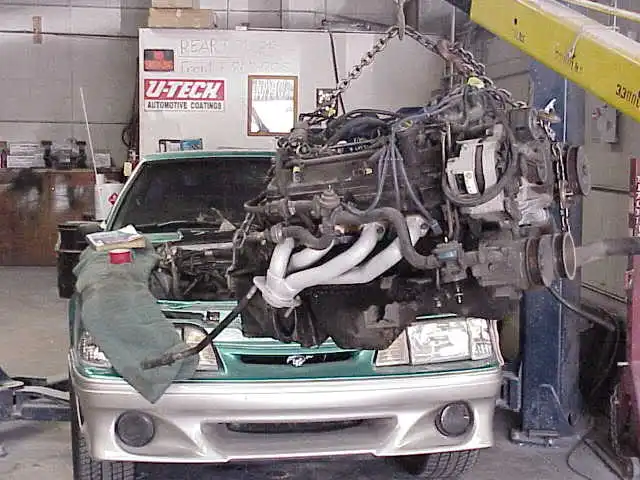

another
always gotta get a pic sitting in the empty engine bay don't ya?? Isn't it standard procedure??

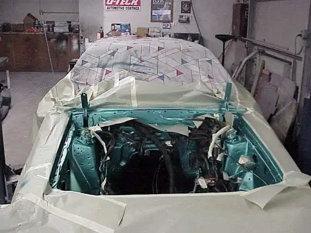

These pics were this morning, now i've gone home, taken a nap, and I'm back at the shop for the duration of saturday night, and I just degreased the bay, and dried of the car, now i'm gonna take a pic of what it looks like (basically where everything goes, cuz i got lotsa stuff to take off the strut towers and the firewall to paint them green w/ the car.... And i can't wait till it's all done and I can finally pop my hood at a car show!!!!!!!

Nice! projects are fun, but they have their times where they get the best of your patience.
What exactly are you doing, just painting the bay? Rebuild and paint?
got a fresh 302 short block, bought set of edelbrock rpm heads, cobra upper and lower, and e cam, and now the enigne is out, gonna paint the bay, which actually i just laid the paint down 3 minutes ago, didn't clear yet, gonna get a pic w/o clear first (dnno why) and gonna clean everything and paint all the brackets (alternator, a/c, etc..) and put it in and have a show car engine bay appearance, the engine bay is SOOOO HARD TO PAINT!!!!!!!! I boughta little aresol can, that you can put your own paint into, that way i could reach some hard to reach areas (w/o an air hose connected to my gun) and the clear is only gona be on the firewall (top of the firewall actualy) and the strut towers and fender wells.. you'll see in a min)

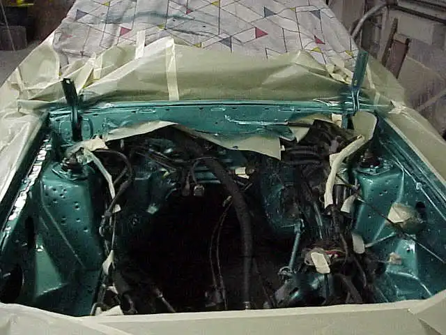

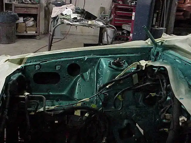

UPDATE ON PICS - JUST FINISHED PAINTING HERE (1 hour ago)
UPDATE = Just finished clearing that paint ^

well, the old motor is gonna sit on an engine stand next to my new motor, on an engine stand as well. I wil take the oil pan off my old motor, and with my new oil pump installed, will use new gaskets and put it on, than i'll tape off the head section and paint the block BLACK. (can't do blue cuz it would be to much w/ the green color) than i will install the new edelbrock aluminum heads (leave them aluminum looking) and chrome valve covers, install the lower intake (all polished aluminum cobra intake upper and lower) than plug all of the fuel injection shi*t up, using my old motor, and convert the car to mass air while i'm at it, which means taking out my old computer (churches auto parts needs a "core" unit to sell me a new one, for like 93 bucks) and replacing it w/ the A9L and installing my C&L 76mm mass air meter.... the old motor will sit at the shop after new motor is complete until i find someone that wants it for parts, or i junk it..... the block is good, just bearin went. I beleive the stock cam is still good, and the short block i have I'll be removing the stock cam out of that as well and that is bran new (replacing with E cam) the motor is really too old, its got 112,000 miles on it....

Heya, what size are those shorty headers you have installed there? They look thick. Are those 1 3/4?
