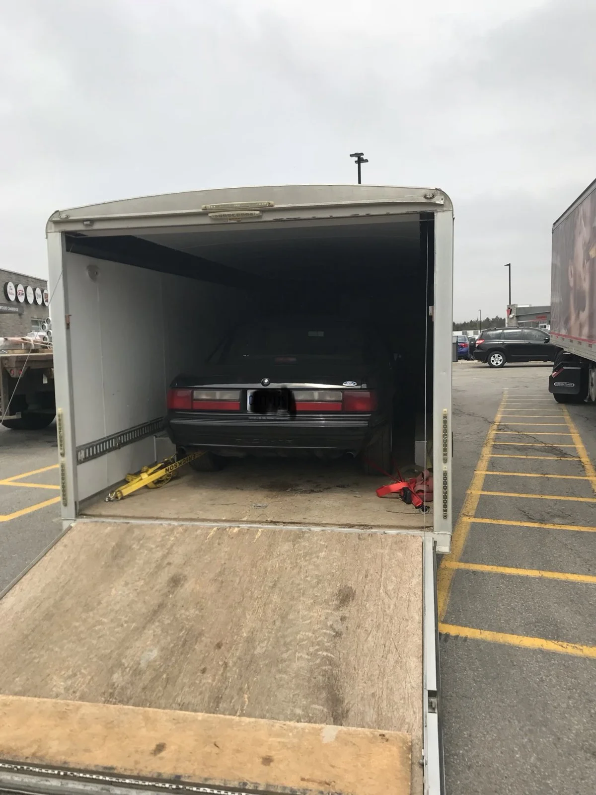

Thanks again boys - currently at a truck stop right now with the truck and trailer grabbing some lunch on way to the new tuner.
It’s about a 4hr round trip for me but I’m sure it will be worth it if he can get it running right.
Ready to roll
