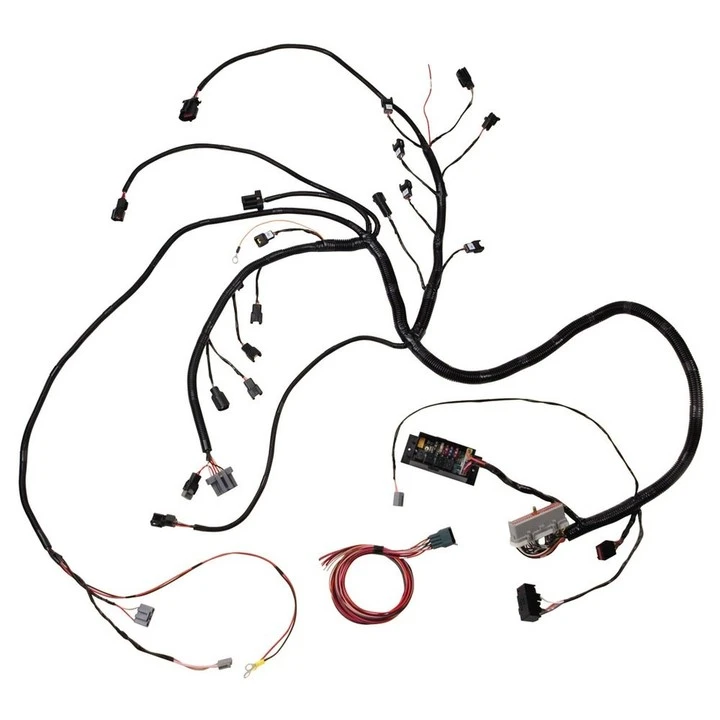

The simplest way is to spend $550+ bucks for a swap harness made to put the Mass Air EFI system on older Mustangs. It works, and you'll have all the parts except the A9L mass air computer and MAF in the kit.
See http://www.cjponyparts.com/ford-racing-engine-harness-efi-for-5-0-liter-engine/p/M12071A50/?

But anyhoo- You mentioned the wire harnest from CJPonyParts...Couldnt i just use the computer and wire harnests from the 95??
No i dont have much money at all which is one of the reasons i would like to put that motor into the Convertible instead of buying another commuter car. Not to mention the V6 was rebuilt in '11 and the thicker head gaskets were installed.
The answer is no unless you are really good with automotive electrical wiring.
It is not a simple bolt in swap. The 94-95 Mustang uses a CCM module that has all the relays and a lot of the power and switching functions in it. You would either have to figure a way to wire the CCM module into your existing car or design a relay & control box to do the equivalent functions.
The closest you will come to a simple installation is the 86 Mustang speed density computer wiring harness. Even that requires some electrical smarts to figure the proper way to supply power to the EEC and fuel pump relays. That doesn't begin to cover the additional wiring required for the fuel pump, O2 sensors, and NSS switch for the computer to sense if the transmission is in neutral.
