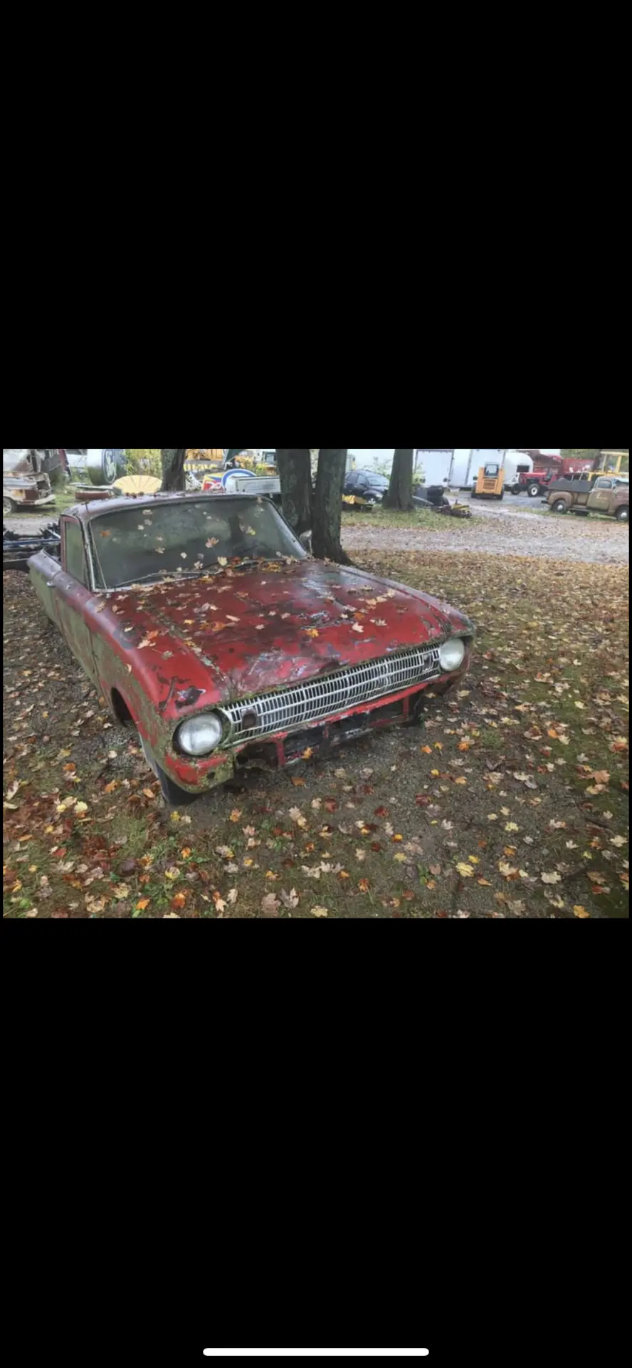

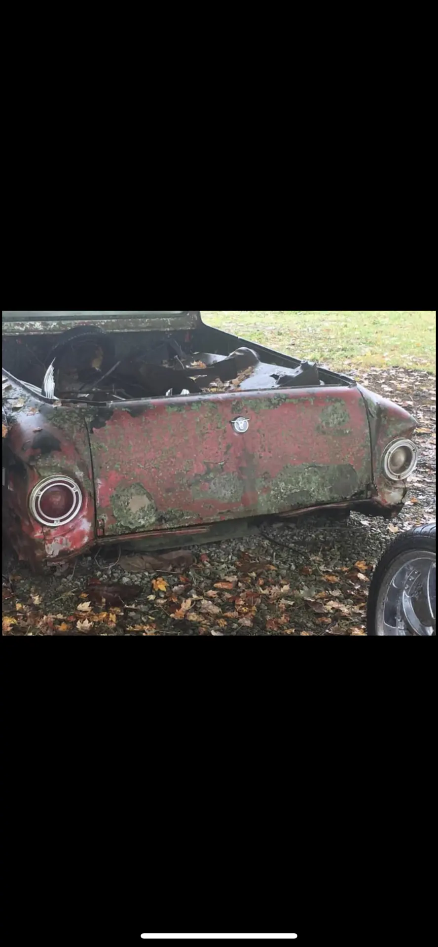

I found the perfect car for your experiment-
now hear me out-it’s Falcon-esque’..
It’s rough enough,you won’t care to cut it up.
It’s solid enough to be a drag car.
How sweet would that be as a gasser.
I’m sure Mike Hates it lol.
Downside
It’s rough
It’s rusty
It’s in Kentucky
Mike probably hates it lol

@RaggedGT I think you are joking, but a built Falcon Ranchero could be really cool. Specially this one.
Edit, auto correct changed my attempt at typing “Just not this one” to “Specially this one”. How did “Specially” even end up in Siri’s vocabulary?

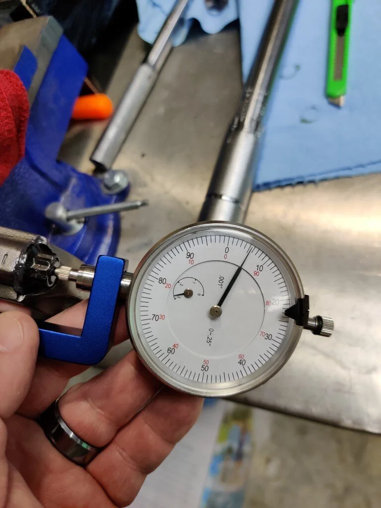

I've read similar before. My question is How do you know it's accurate without a huge assortment of weights. If you set it to 50 ft lbs, set 50lbs one foot out on the handle and it clicks...is it clicking at 50? Or maybe it's really clicking at 30???
In my case, ARP says 50 ft lbs should stretch the rod bolt .005-.007. My dumb self didn't use moly lube. So I'll use Moly lube and see if old Crafty or new Pitty come close to the stretch at 50 ft lbs. WO moly the Crafty at 70 ft lbs only stretch it .004. But by feel when loosing with a breaker bar, that seemed MUCH looser than how they came out of the box.
Not that I am sure if Crower torques every rod bolt to spec before it leaves.

Well, I thought I shot a video of me taking the rod bolt that was torque to 50 ft lbs with the Craftsman and then torquing it to 50 on the Pittsburgh.
I guess I didn't hit record.
What the video would have shown is the socket turned another AT LEAST 20 degrees. The stretch went from about .0035 to the just a hair over .005 you see below. 11.99 torque wrenches FOR THE WIN.
I still need rod bearings. The Clevite 77P are just too tight still. They have about .0011-.0013. For a performance application I would like to see them a hair over .002. The stock type replacements are right at .002. I found ACL bearings makes race bearings for the 2.3 and they also make an oversize set. So I am going to order a std set first and see where they are at. Actually I ordered a std and a .001 oversized set. I'll send the one I don't use back.

The instructions I read say after securing the socket drive in a sturdy vice, use a piece of tape to mark the specified distance to the middle of the handle. Then you can move the hook or wire loop the weight hangs on to before and after the mark to make sure it clicks at the right weight.

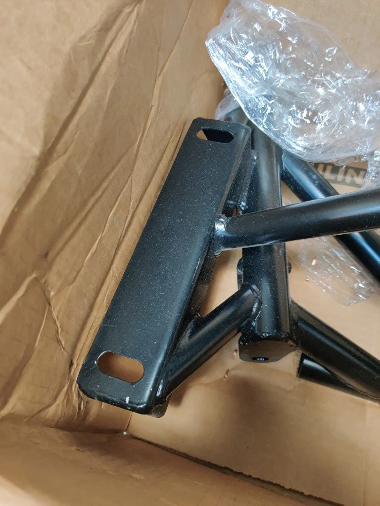

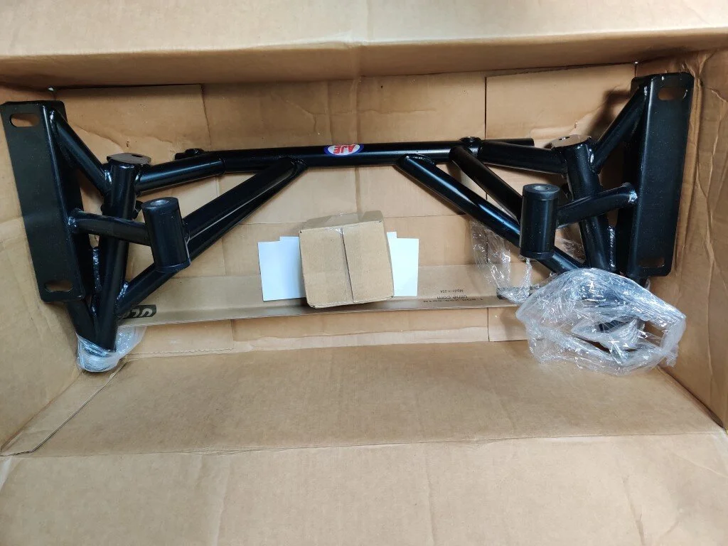

On the road to pickup the future 2.3 home.
Reactions: Flatfoot
CarMichael Angelo
10,641
8,909
Birmingham, al
Oct 31, 2020
#560
  • Oct 31, 2020
  • #560
Soooooo.....you’re not telling anybody what the future home for the 2.3 is?
And here I always just thought that the “ home” for that engine was the stand that it’s attached to.
You provided a pic of some “whazthatfit” AJE k member,....Tell us mystery man.
* Never mind....The k member fits a 64-70 mustang. Since you’re not going with that, it’ll also fit a maverick, falcon, comet, or.....ranchero. My guess is the latter..and if it is that.....I hope to hell youre not buying the one that’s turning into forest floor, and have opted for Rick‘s car.
Of which surprisingly, I kinda like.
