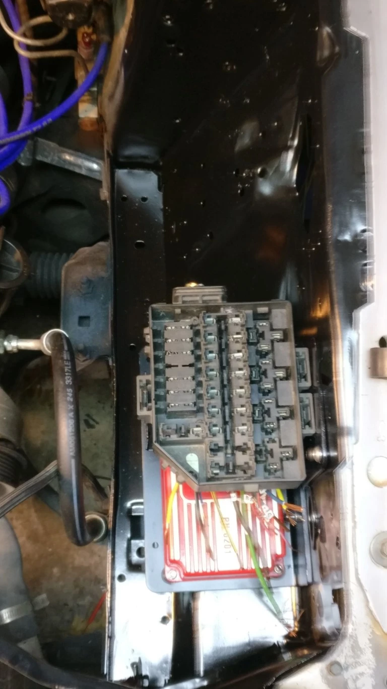

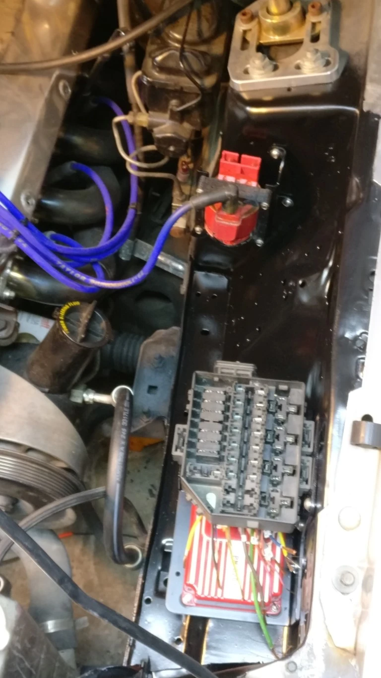

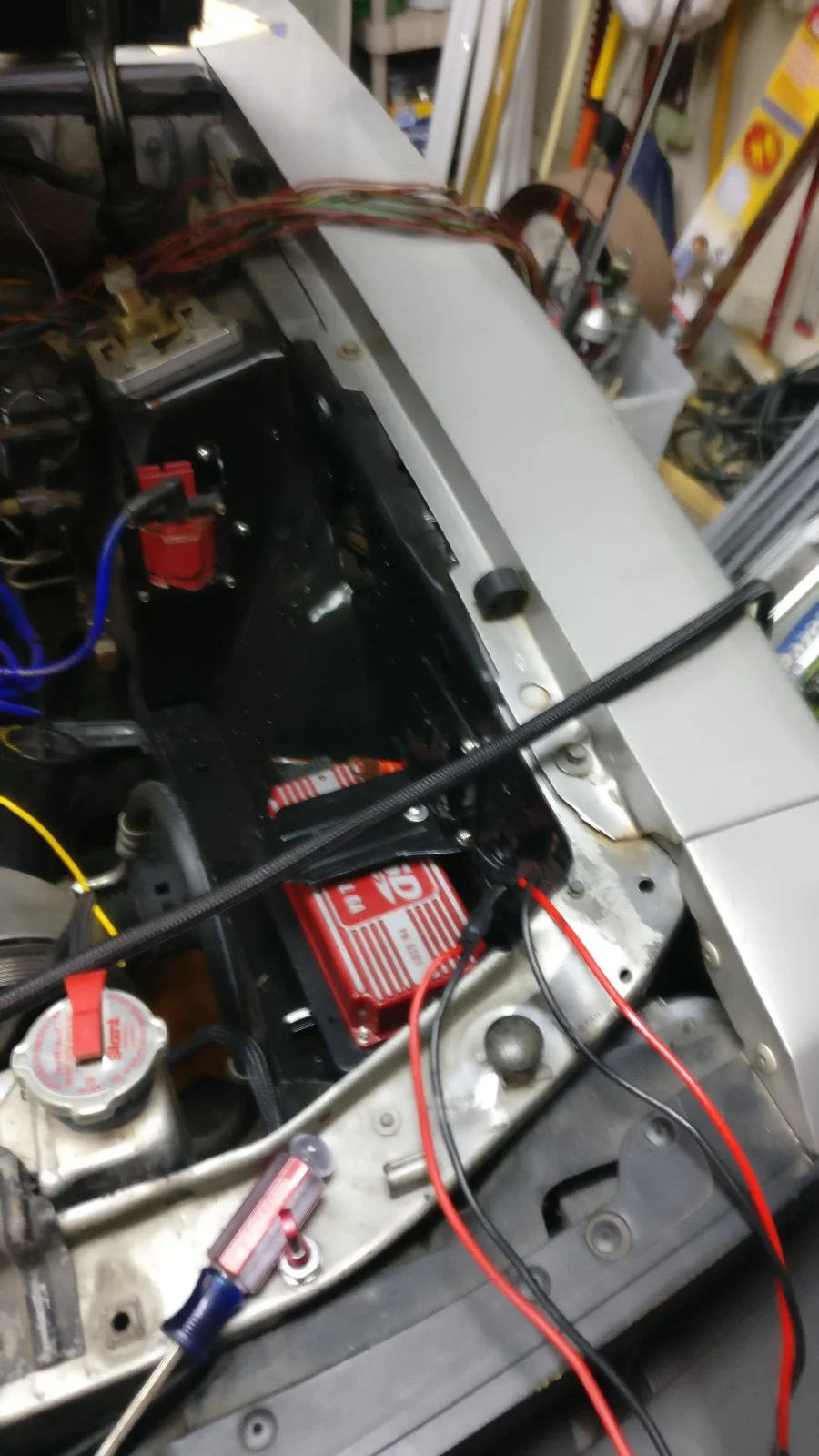

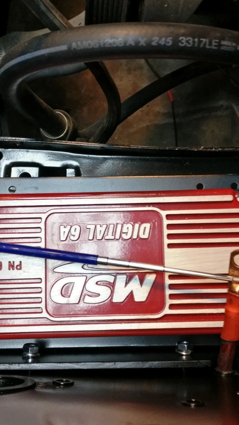

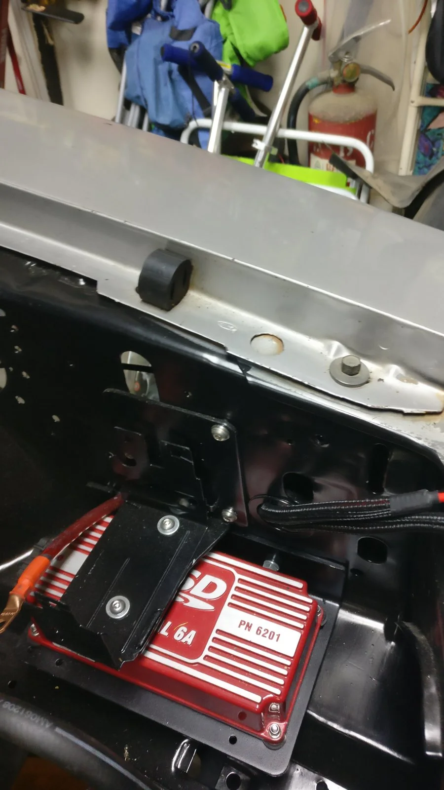

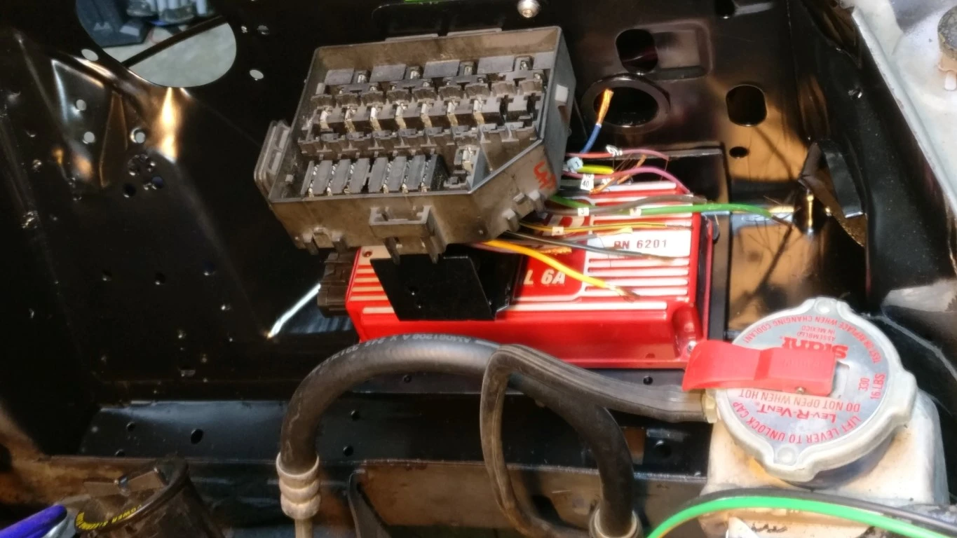

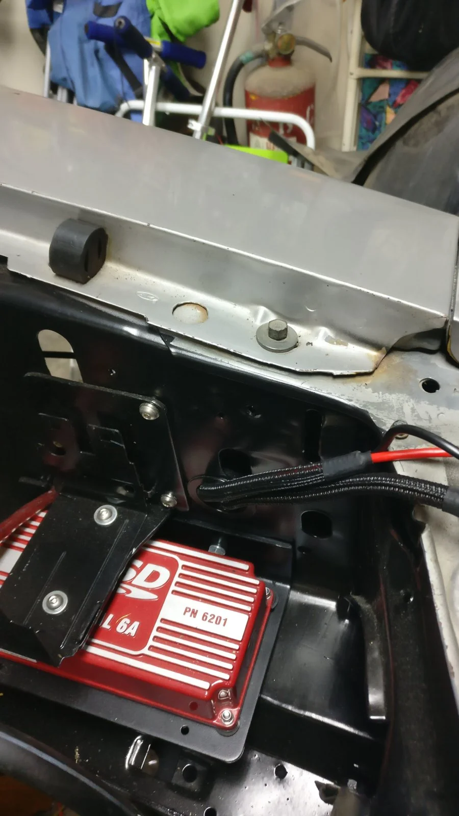

It only took an hour, but I feel like this project moved forward about a year today! I was able to use a magnet to fish the lock washer and nuts in to mount the MSD. It's about 3/16 off the fender apron and the fuse box mount just clears the top of the MSD box by about 1/2". Now it's time to stock up on solder and heat shrink. First I have to do a diagram. I already labeled every wire on the fuse block.

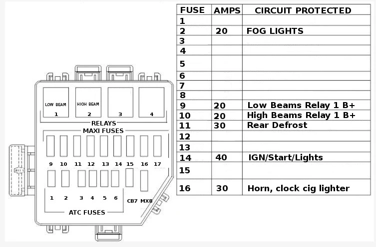

I'm trying to wrap my head around all the :poo: I cut out back Labor Day weekend. Luckily I have a wiring diagram, an EVTM, and I labeled most of the stuff as I have identified it. Now to setup my fuse box. I brought out the GIMP and started making a diagram. I can't believe a program like GIMP is free.
Damn, I just noticed my screw up above...both fuse 9 & 10 go to Relay 1. :stupid:

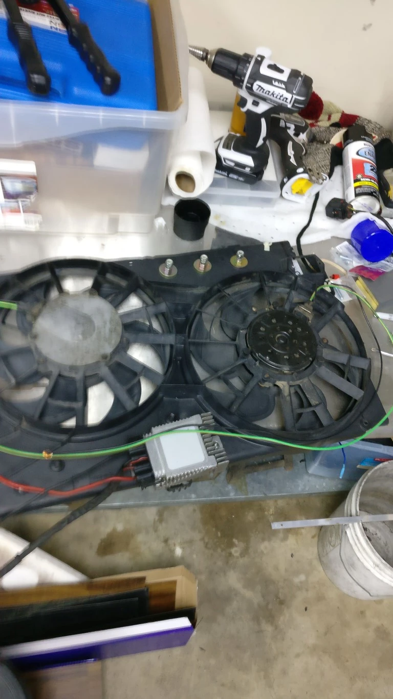

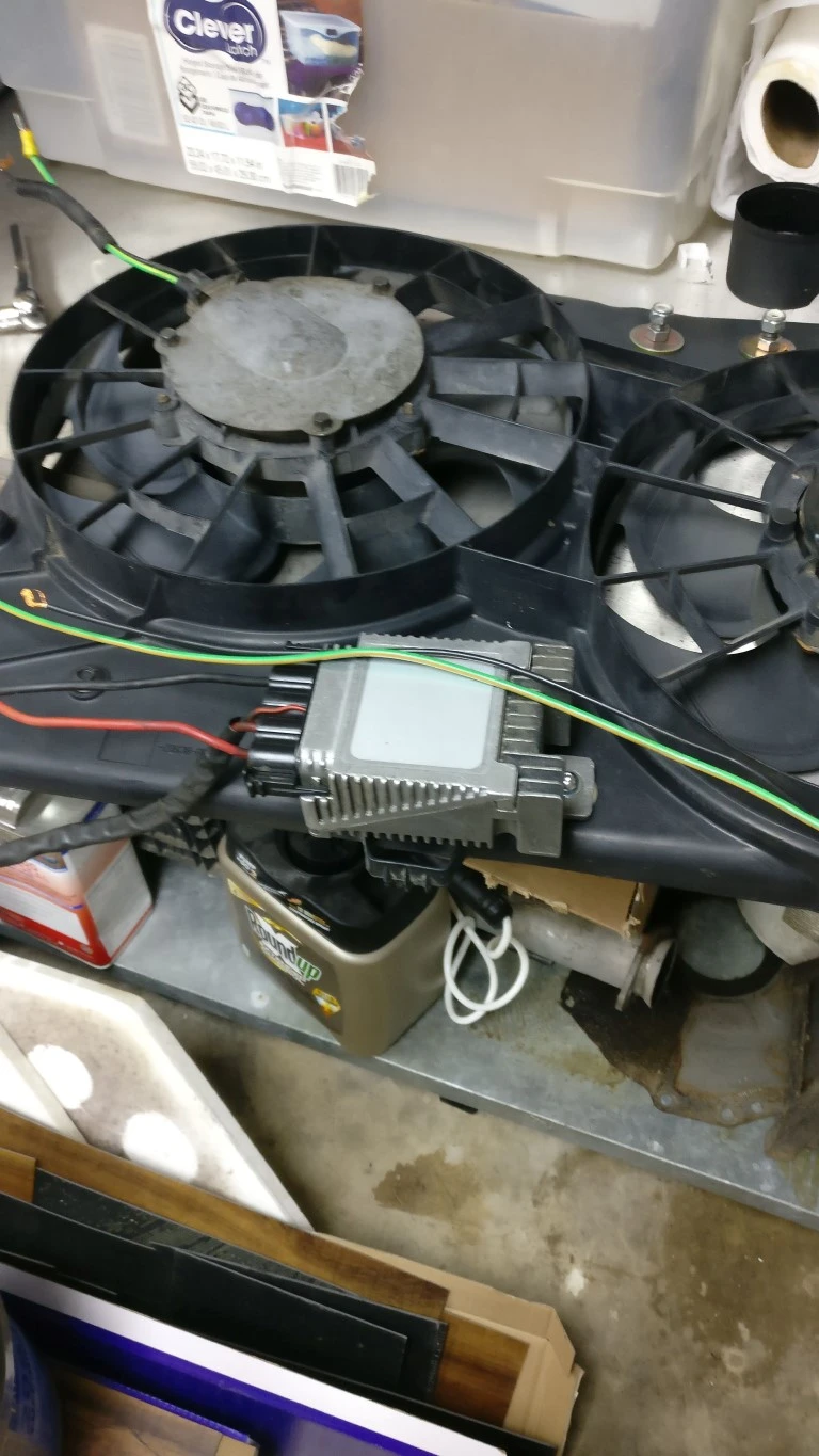

I went to Pull a Part about a month ago and got the PWM fan controller off a Fusion. Since I have the fancy smancy HP EFI, I am going to use PWM to control my Contour fans. I was going to use the Fusion fan because the PWM contoller mounts right too it nice and clean, but the damn fan in a Fusion is wider than my radiator core.
So I've gone out there a bunch of times and looked at the engine bay....where to mount this box. I even looked up dimensions of a C6 fan because it uses the same controller and again mounts to the shroud nice and neat.
I finally said today, no the Contour fan fits my radiator like a glove...find a place to mount the box. So I pulled the fan out and found on the bottom a perfect place to mount it. I had to drill one hole. When I go to put this back in, I am going to use some blue Loctite just to make sure these screws don't fall out.
Now I need to solder my fans to the power leads of the PWM box and put it back in. I'll probably clean and paint that left fan motor cover while I have it out.

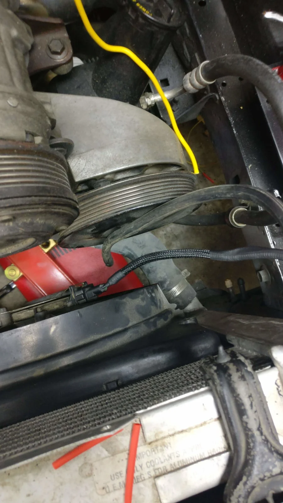

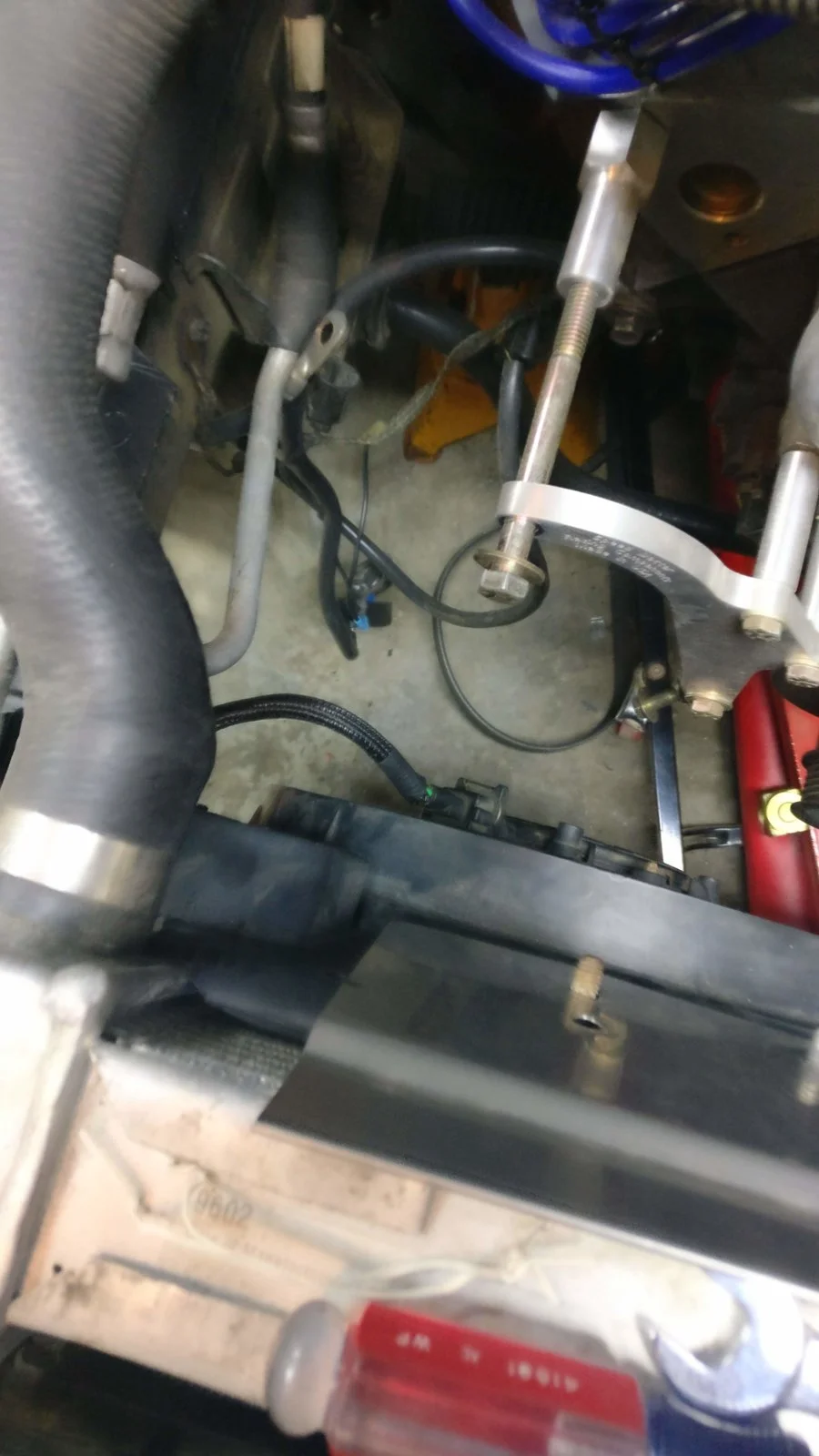

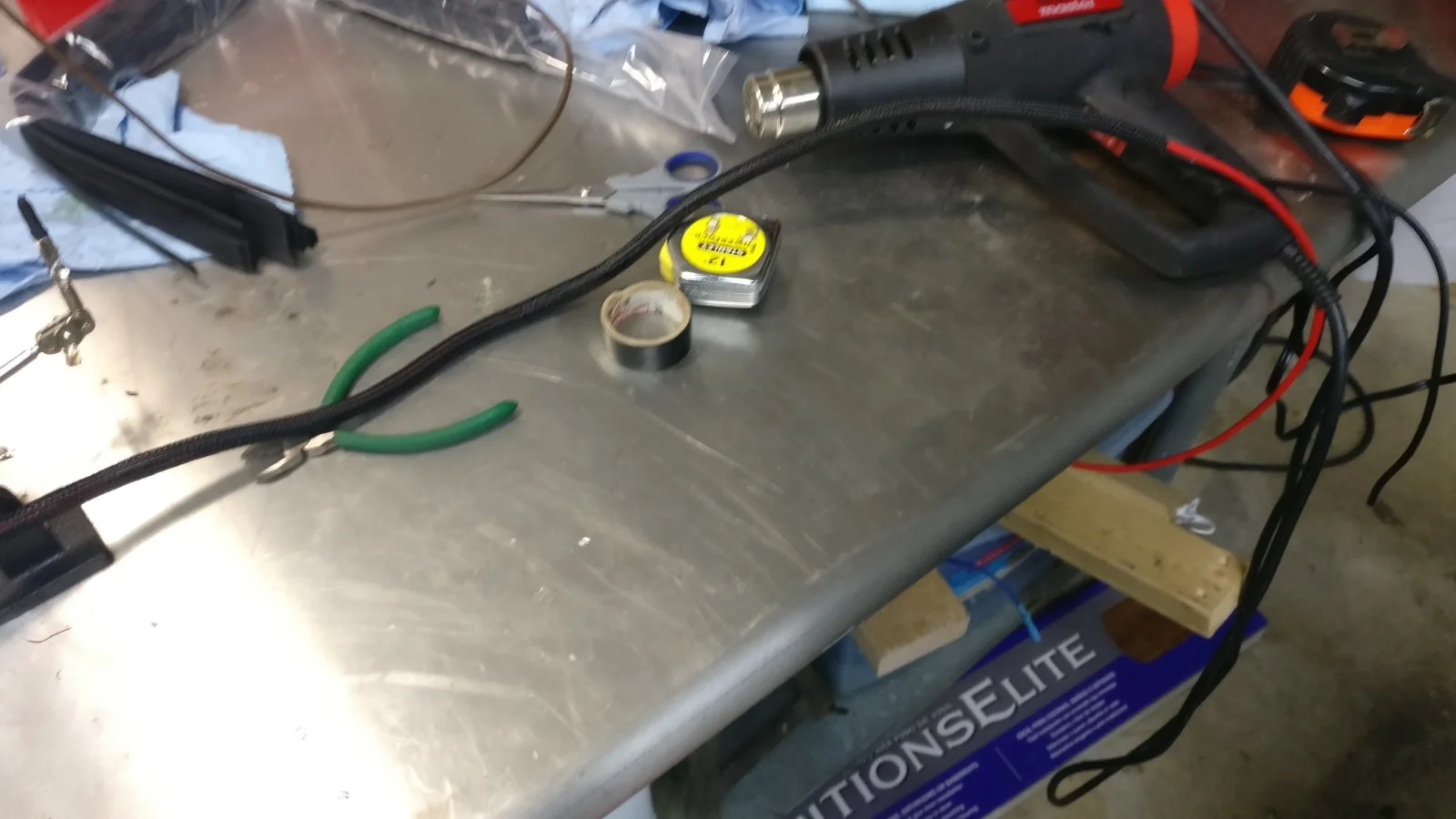

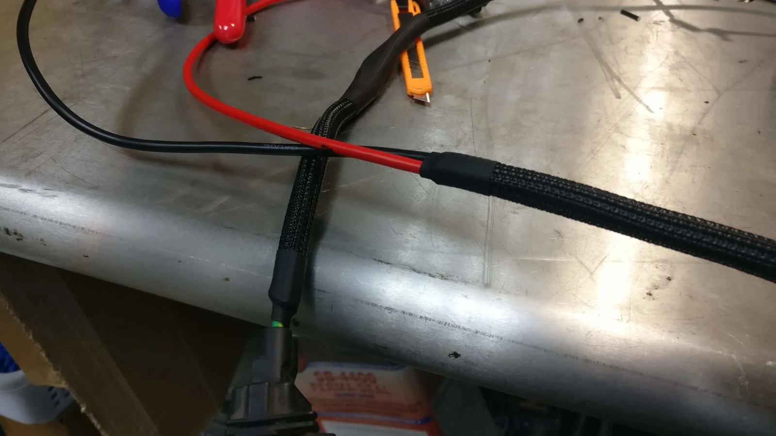

So with the simplification in mind I started to work making fan harnesses to go to my relay/fuse center. Yesterday. I bought a nifty little solder station on Amazon...oh maybe a year ago, for all the soldering I have to do. It had a tip assortment so I put the fat one on. I cranked it up on high. And attempted to solder 2 10 gauge wires together. I waited and waited and waited and it would never get the wire hot enough to wick the solder in. So, I said I need more power. So I went to Autozone and bought this cheesy ass piece of :poo: Dorman 100w gun. FAIL. Took that :poo: right back and got my $19 back. Well, I lost $.50 in the gas to make the 1/4 mile round trip twice. I ended up using a micro butane torch I had....but that was less than optimal. It burned the insulation and I knew sooner than later it would burn my fingers. SO I went to Lowes and found a good old weller 100/150w gun. AND I read the instructions. All this time on dual wattage guns I thought the first click of the trigger was low and all the way was high. NO. It's the other way around. Having the right tool made the job much easier today.

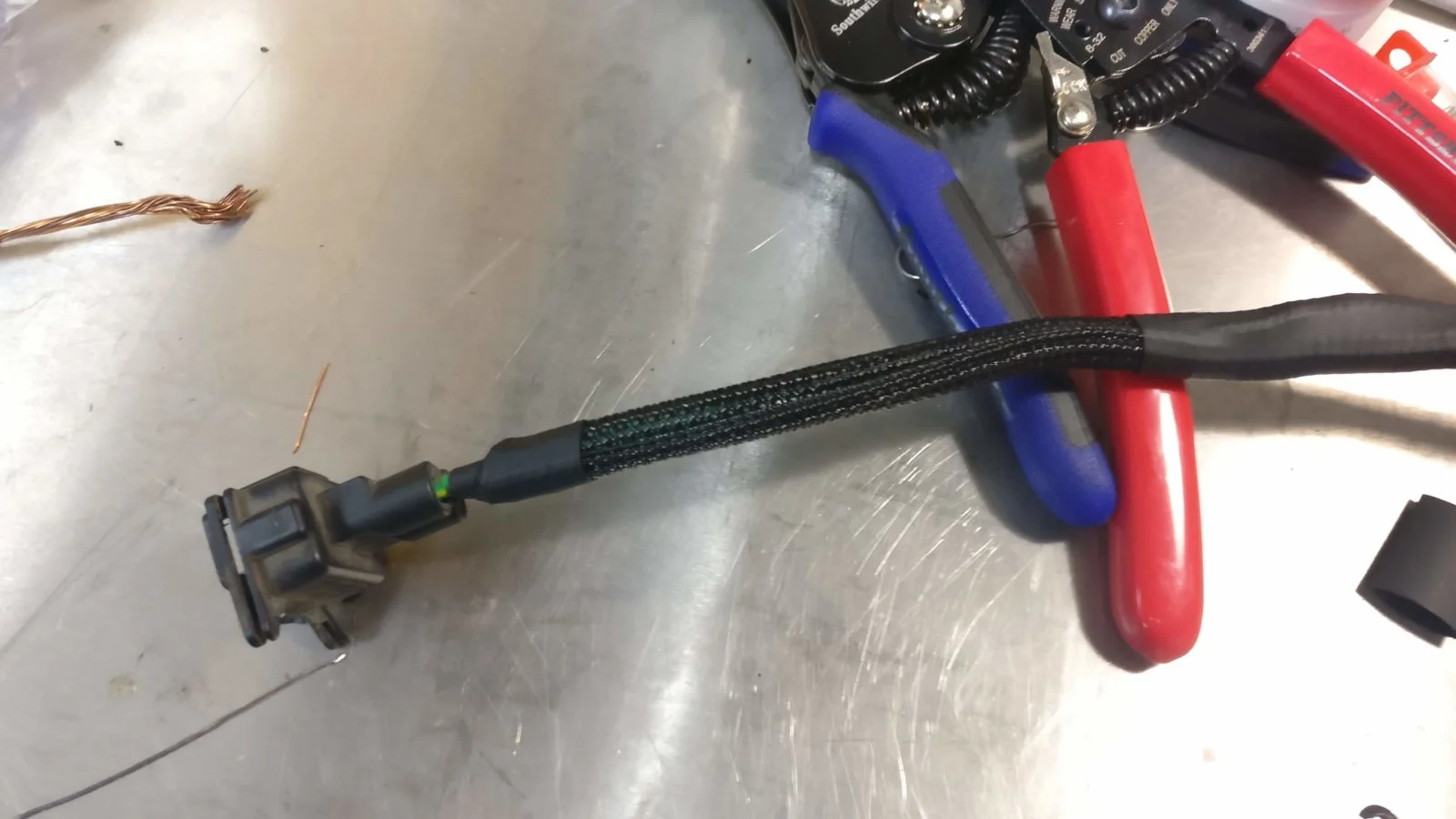

I then covered my harnesses and my power feed cable in this nifty split loom nylon braided stuff I got, at least 3 years ago! (I hoard up parts) I finished that off with heat shrink and it looks pretty damn good. Now if the heat ever breaks so I can put a table and stool over by the front of the car and start soldering the fuse center in. It was 92 in the garage while I was out there. Too hot for me.

I've got parts of three days to play with the 85. First things first if anyone is awake. Can you take the fenders off a Fox without taking the front bumper off? I don't really want to take both off right now and keep up with all the hardware. I just want to take the DS off to make space to get in and route all of my wires.
Yes, as I said in chat, now let me add, if you have good paint, heck if you have any paint on the car, tape up the front door edge and the edge of the bumper, an extra pair of hands would be nice, note any shims and where they went.
Reactions: Vettn71
Well, this never happened today! Maybe in the morning I'll decide if I want to take the nose off or just work in place. It would prob be better to have the fender on so I make sure I route everything where it will be out of the way.
