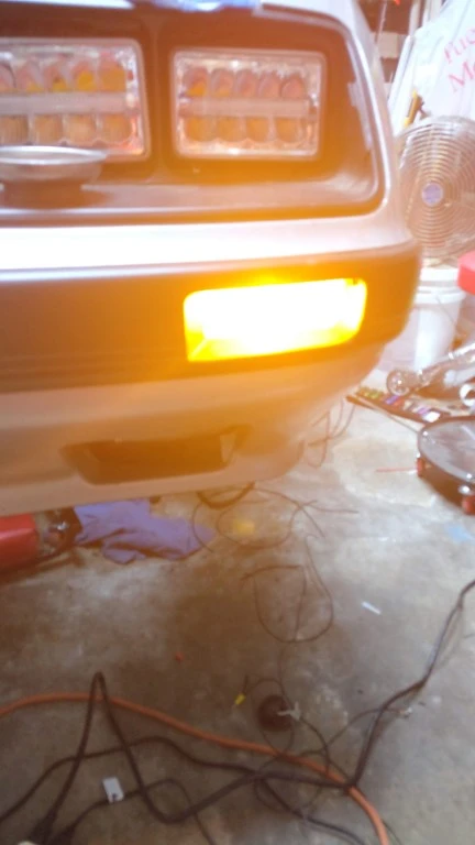

Foglights. Nothing. Strike 1. Check the evtm and see which fusible link they were. Trace that wire to the fuse box thinking..aha, another fuse I forgot. Nope there's a good fuse. Strike 2.
Check to make certain I wired the power wire to my foglight harness, yep. Full count.
Remember that the fog light switch was kinda 'picky' about where it was actually on when you moved it, from last time I was driving it 3 years ago. So here's the pay off pitch. Strike 3 game over or a walk off double to left center???
:noesrun:
I firmly operated the foglight switch off and on about 10 times and could hear the relay start to click. Voila, foglights. Game over, I win today!!

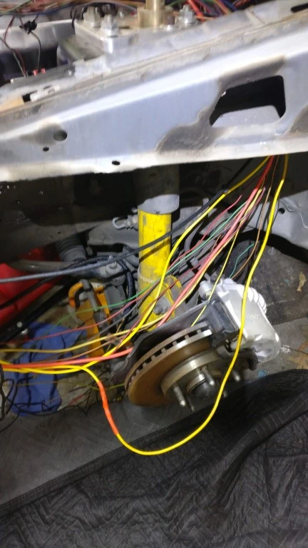

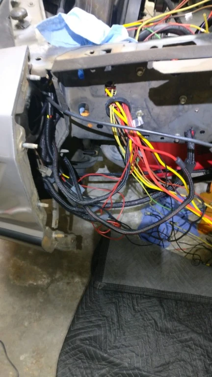

Damn I am lazy and slow. I spent an hour looking at where all the wires are and holding up the inner fender line. Looks like everything clears or will clear with some encouragement, zip ties, cable clamps, and the application of a heat gun. I almost put a hole by my MSD box to route the wiring, but realizing it would come out right into the liner. So it took a while to work an alternate plan out. The wires will go thru the same hole as the wiring for the fuse box. It's not the most beautiful solution but it works. I connected up the coil connector and routed for the power and ground. Just to be safe I am grounding the MSD off to the frame rail by itself. I figure it's a pretty noisy electrical thing. I also order a power filter, which is fancy 10x cost speak for a capacitor to filter the power going to it...knock down any spikes. Maybe make it last longer.
I also got a Cool It express sleeve and wrapped up my harnesses that pass between the radiator and condenser, trimmed to fit and installed. I will use the remainder to put around my clutch cable. It's pretty close where the bracket that holds it off the frame is, so a little insurance is in order.

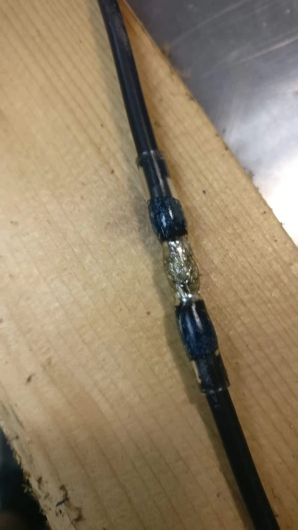

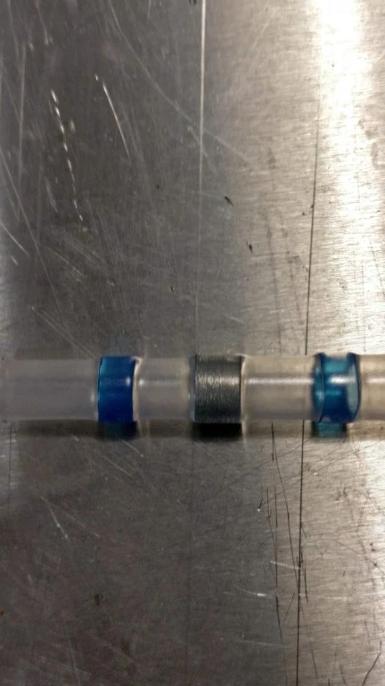

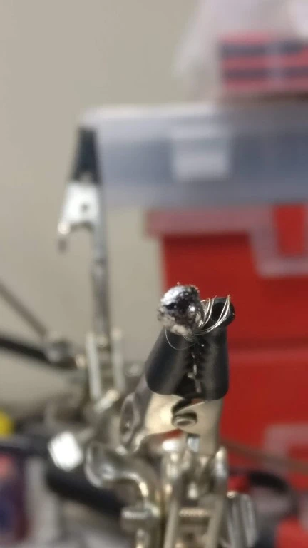

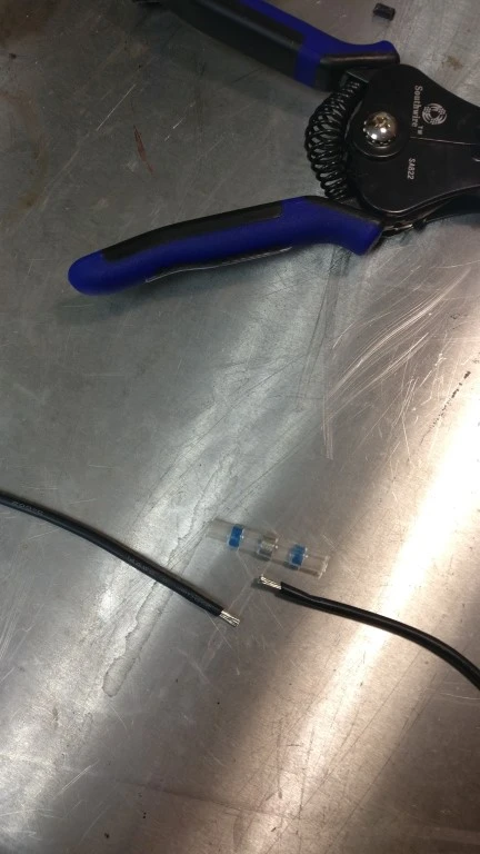

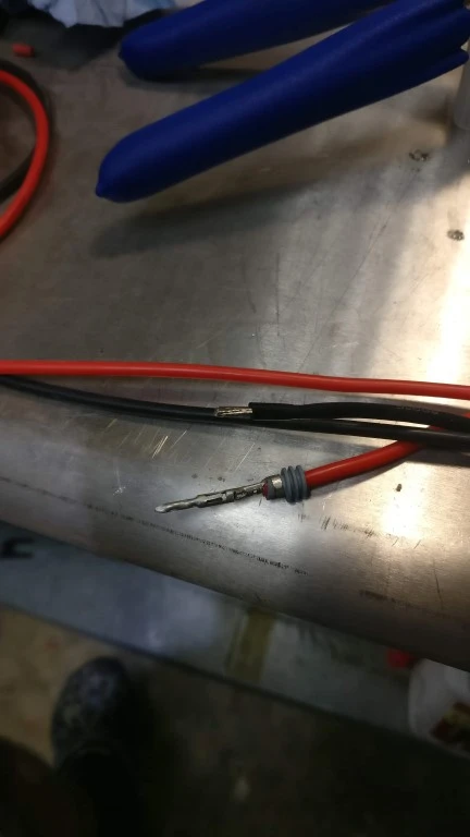

As I was catching up on @a91what build thread...amazing work. I saw him mention solder seals. I've never heard of them. And I just HAD to have them. So Amazon Prime to the resue. If you're not familiar with them, they are solder and heat shrink in one. Can be applied with just a heat gun. I have been wiring my fuse box in by using bare metal crimps, crimping 2 times on each side, then applying solder thru the hole in the center of the crimp and to the ends. I know it's rock solid, but time consuming and next to impossible to do 10g or thicker with the soldering iron. Pretty much have to use a mini butane torch.
But can you really get a good solder with just a heat gun. Without actually applying heat to the wires and having the solder wick in. I got mine yesterday and decided to check it out. I used the strip the ends then push them into each other, then twist together method. I used my heat gun for a good 40 seconds or more to get as much heat in as I could. You can see the shrink tube shrink and the solder melt. I cut off all the shrink tube and tried to pull apart. I can't.

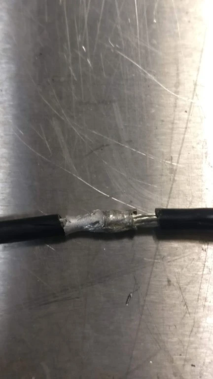

But is the connection really solid? If you take solder and drip off the soldering iron onto your wire, it doesn't penetrate, is a poor connection and is called a cold solder. Expected to fail.
These are mechanically bonded pretty damn tight, but cutting the joint open shows no solder penetrated. So is this a cold joint? Is this bound for failure? Has anyone used for long time on something with a decent amount of current? I'm on the fence.
I did make a video showing the soldering melting. The quality of the heat shrink is top notch and it has a blue ring on each side of the joint that melt and look like they totally seal the joint. I also used solder flux, hoping that may help the solder flow.
And yes I am 100% sure the solder didn't flow, because I can take needle nose and fairly easily pull strands out of the center of the joint. I am wondering if most of the pull a part bond is just the heat shrink?
Solder Seals
I'm about to go Nuclear Google on these things. But if anyone has some factual experience, I would love to hear it.
