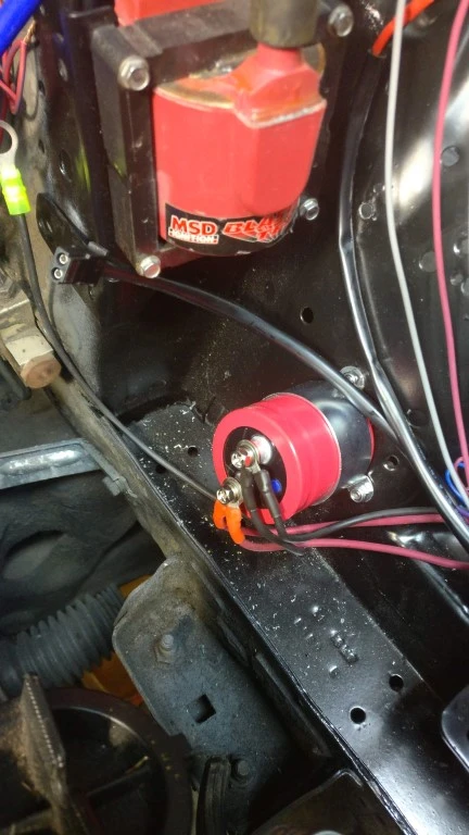

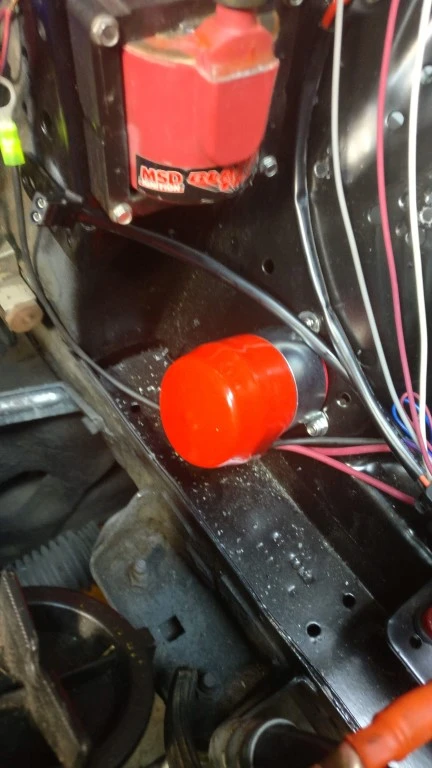

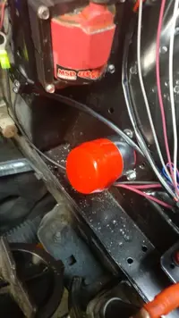

Speaking of which, I wired up the MSD to the power filter (capacitor). I used crimp on ring terminals. I cut the cheap hard plastic insulators off. I then crimp the :poo: out of them and cover with heat shrink. I used the non-insulated side of the crimper which dimples the terminal. Pretty sure that wire won't come out.
I mounted the capacitor to two existing holes in the fender well. I don't want to drill any more holes. I used button head screws to minimize the protrusion towards the tire. I am going to ground it to the bottom coil bracket mount bolt on the strut tower. I also want to get a braided ground cable and run that to the back of the drivers side head to make damn certain the MSD and the coil are grounded very well.

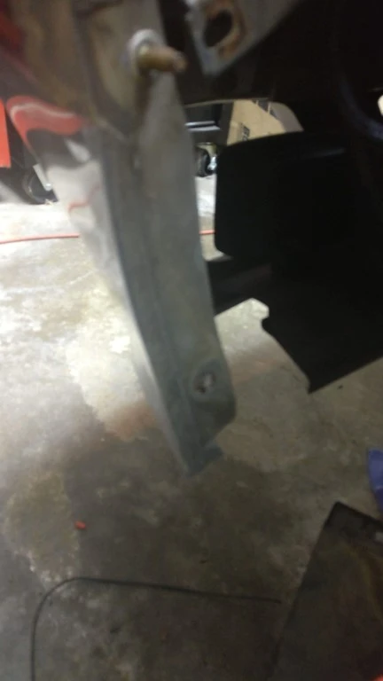

Ok, so when I removed the fender to make room to get in there to wire everything up I broke off 2 bolts. What's the easy way to fix this? The one I am concerned about lives in the bottom of the bumper. Looks like it goes thru and is made to a metal brace that runs up and captures the bolt above it. Funny thing, the bottom bolt was almost rusted away. The one directly above looks new. Must be a bad spot to catch road wash. So, does that metal piece come out of the urethane? If so I can just easily drill it out and tack in a new bolt. What says the experience body guys @Davedacarpainter? The first pic is the bolt broken off in the spat or whatever the piece of molding that's on the bottom of the fender to match the airdam. I can just get another bolt for that one. And maybe a nutclip if I have to destroy it to get the rest of the bolt out.
Yeah Drew, that's all I did with mine was to cut out the old one and spot weld in a new bolt. Nothing real tricky.

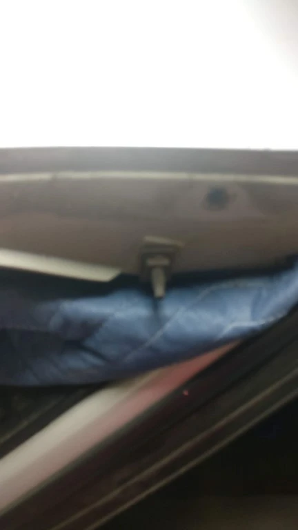

First my son's 2005 Volvo XC90 had "square" steering...in his words. I finally figured out he meant notchy. I figured the steering U Joint was starting to freeze up. Removed the floor grommet and sprayed some penetrating oil in it. Worked it around and then sprayed some lithium in it. According to him it is fixed. And then it took almost an hour to get that damn grommet back down to the floor. My big ass couldn't get both arms in front of me because that tiny POS is just too small. I am actually surprised and proud that once I explained to my son, there's a lip on the floor, there's a spring around the bottom of the grommet and it's got to go over that lip while you pinch the spring with your right hand and push the whole thing down with your left, he was able after about 15 minutes to do it. So at least he can change a tire and put the steering grommet on his car. And check the oil, trans fluid and power steering fluid now. So not too bad for today's 17 year old teen.

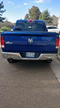

That went so well, I decided it was time to change the exhaust on my Ram. The only thing I didn't like about the V6 was it's not offered with the factory dual exhaust. I love the look. I found out all the exhausts Hemi, V6, Eco Diesel are the same from the muffler back, as long as the chassis is the same. So I found a take off hemi exhaust a few weeks ago on a Ram Forum and finally gave up looking for a used bumper and bought one off Ebay this week. I had my son help swap bumpers and then he had to go to work. I finished the bumper swap and then changed the exhaust. The V6 muffler was a little hard to get out, but other than that, the swap was simple. Maybe 45 minutes top. Now I have a factory dual V6 Crew Cab Ram. I'm happy. It doesn't sound much different. Maybe a little more raspy. But as long as it wasn't obnoxiously loud, I just want the look.
