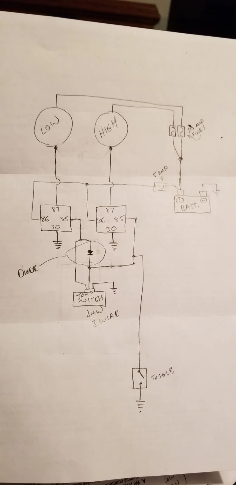

With the bmw sensor you could use two relays and a diode. The low speed would ground the low speed relay by itself. The high speed fan relay would have two wires coming off the trigger....the one going to the low speed would have a diode in it. That way when low speed is triggered the ground path can't go to the high relay... but on high it would allow flow to both.
I like this thinking. And there's someone on ebay selling a NPT plug drilled and tapped for the metric thread of the BMW sensor!!!

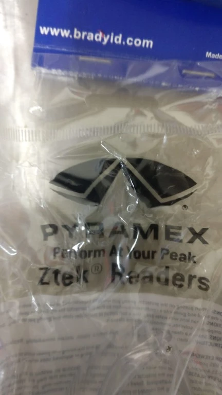

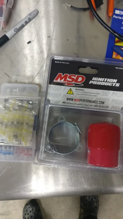

droopie85gt said:
I also picked up a couple of goodies this week. A MSD power filter for the Digital 6. And the most amazing thing (to me) READER power safety glasses! Because sometimes you have to be grinding AND need to read the instructions or you have to lay on your back with your face about 1 foot from where you need to drill and grind and it helps if you can see the piece clearly!
Getting old isn't for the faint of heart, my 87 year old dad always says that.
And yes, these are SAFETY Crocs
If this was me posting the pic, I would've retaken it if I had my shadow, or foot in the shot. ( What can I say, I'm just weird that way)
Where did you get the full reader safety glasses, and what power are they? The only ones I've ever been able to find have the "reader" parts at the top and bottom of the lens' and forces you to tip your head to be able to look through the magnifier.

stanglx2002 said:
You are not going to find a factory fan switch that will come on that low. I do not know of any manufacturer that runs there engine coolant that low as most range from 190*-195*. The typical turn on of a fan is 10*-15* above the thermostat due to the fan not running all the time. If you have a 180* thermostat you should really have the fan turn on around 190*-195* if you are trying to keep the temps down.
Yeah that's what I figured, so I think I'll go with the idea to have the BMW dual switch trip both relays with a diode in the 2nd fan to keep the first one on. I need to draw a diagram so i can see how that works.
I read the description wrong on Amazon. They are readers...like bifocals. Still good when cutting and trying to follow a line. I am sure that @Noobz has the procedure you need to find such a beast.
Do you have a quick diagram on how that looks. I am pretty sure I understand, but I also say I usually understand and then let the magic smoke out.

I'm no electrametician.... but....
I have 20 amp fuses on my contour fans and they work well. Most manufacturers use 30amp fuses...except the old fords used 40amp.
Running the fans with ground triggering means you can run a wire in the car for a toggle without worrying about burning the car down.
I'm not sure about the orientation of the diode. They only allow current flow one way. This schematic would allow the high and low fan to be cut on with the toggle. The power wire to the 5amp fuse could be run to ignition power instead of battery. The way its wired the fans would stay on until the car cools to the point the switch cuts them off. ( most manufacturers will run fans after ignition is off ).
Manufacturers nowadays always use ground triggering circuits. It keeps live 12v wires out of the interior.
