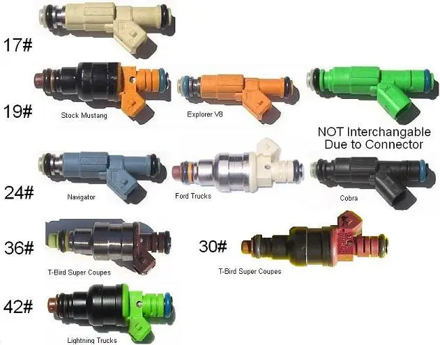

There is an O ring that seals the injector to manifold gap. If those O rings drop down into the manifold because the pintile cap that holds them in place is missing, you will get a vacuum leak.
Notice the brown cap on the end of the 19# injector. That is the pintle cap that retains the O ring that is the injector body to manifold seal.
