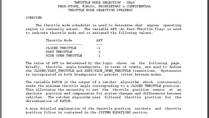

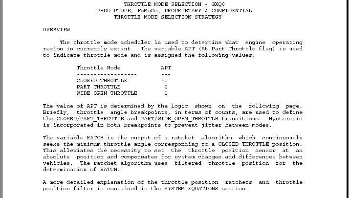

the idle speed is likely to raise when you raise TPS voltage with the engine running. this is because you have just shifted it into part-throttle mode. after turning the car off and restarting, the new "base" value for the TPS is recorded and the idle should be back to normal.
as evidence for the falsity of the TPS ".99999" myth, i offer this excerpt from an internal Ford document that was originally intended for their engineers:

And appreciated indeed.......the point I'm trying to make, and the source for the comments, is that the TPS is a non-adjustable device, it's a pass/fail, or G-NG (Go-NoGo) variable the system is capable to provide for w/out problems, as long as the operating window (no failure codes) is complied with otherwise, the problem usually lays elsewhere.
If you look at the strategy, the systems identifies TP state as -1, 0 or 1....-1 being the CT state (minimum reading within .5vdc to 1.19vdc) now, base idle could be set mechanically to 700 rpms and a TPS value of .7 vdc, which would be the same as 700 rpms and a TPS value of 1.09 vdc....anything less would make a carburetor setup gain the upper hand.
