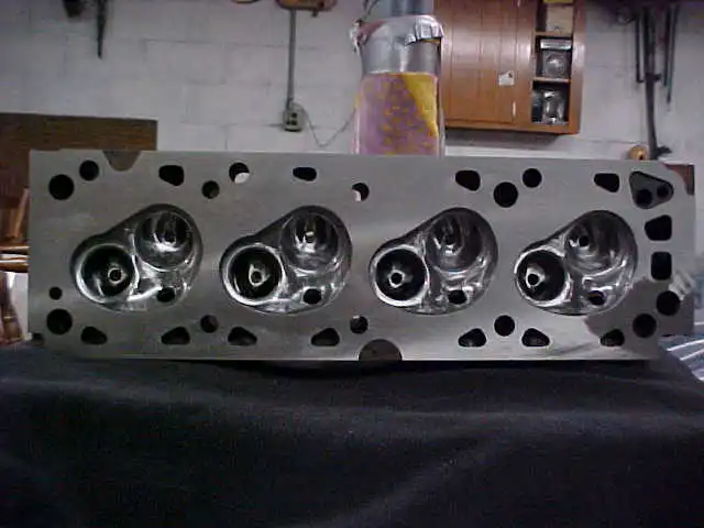

Welp i got the head back finally... the original head was cracked beyond repair so they said "Your head was junk so we have found another one so its starting process all over again" and i end up with a heart chamber head.. this is un-acceptable no? Smaller combustion chamber means more compression wich isent good for turbo applications

Bummer....it looked pretty bad in the pics. How about calling Bo and see what he can do. He can probably open up the chamber on the new head to get you the proper shape and cc's plus he is the 2.3 head expert so he can offer up advice to get the most out of your head. Much along the lines of Chip and Shannon, Bo is a good guy and super knowledgeable. His shop used to be out of Fremont but he may have moved to Reno now.

All I can think of is to have Bo open up the combustion chambers. More chamber volume = lower compression ratio. Or you could try to do it yourself but, be careful. It's easy to go through. I know.......I've done it! Ruined a perfectly good head! Bo's prices for chamber work seem reasonable. As I mentioned before, 2.3T heads are few and far between. Others have run modified N/A heads on turbo motors with success. It's not optimal but the motor should run fairly strong. Also, IIRC, American Cylinder Head is in the area of Golden Gate Fields. American Canyon ain't that far away. I'd run down there, make an appearance and demand some answers!

Also! I left American cylinder head a very "stern" voicemail to say the least and they finally coughed up and said they couldn't find me a 2.3 head. they did offer to re-chamber my head (free of charge) I'm probably going to take it down to them since they seem to want to make this right. anyone have information on the CC's of the D port head? these guys might need it

This guy opened up and polished his chambers on a N/A head and put it on his 2.3T motor. He said he opened it up to 67cc's and that gave him a 7.6 compression ratio.
