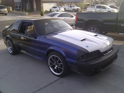

I'm running 18x9 and 18x10 on a 93. Tires are 245/40 and 275/40. Nitto 555's. They don't rub at all and I'm using Ford racing B springs, 02 spindles, 02 Moog ball joints. And Monroe sensatrac struts and shocks. It rides incredibly well, doesn't rub. And doesn't have horrid bumpsteer from the 02 spindles.

18x9, 18x10 didn't roll any fender and used B springs
Yours fits because you are using an 18x10 with a tire that could fit on an 18x8.5. The tire is probably stretched which lowers the profile even more and takes the corner off the tire giving even more room for movement.
