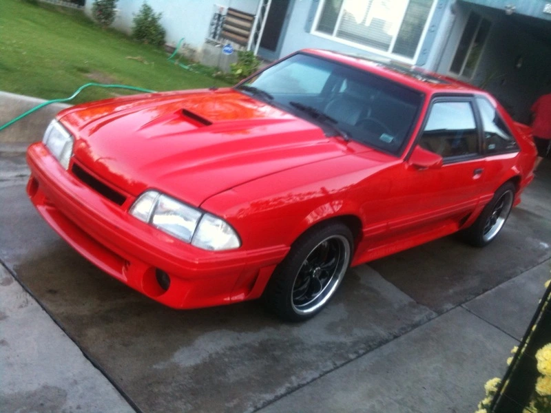

i used 18x9 front with 255/35/18 tire and 18x10 rear with a 275/35/18... stock 4x4 height

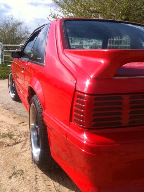

it depends on your drop and tire size you want to go with.. i got these and i got good clearance, i haven't lowered her yet but i think 1.25 should be good.. and i used 94-95 front spindels and 91 ranger axels (2 drivers) and with what i got i dont rub..
