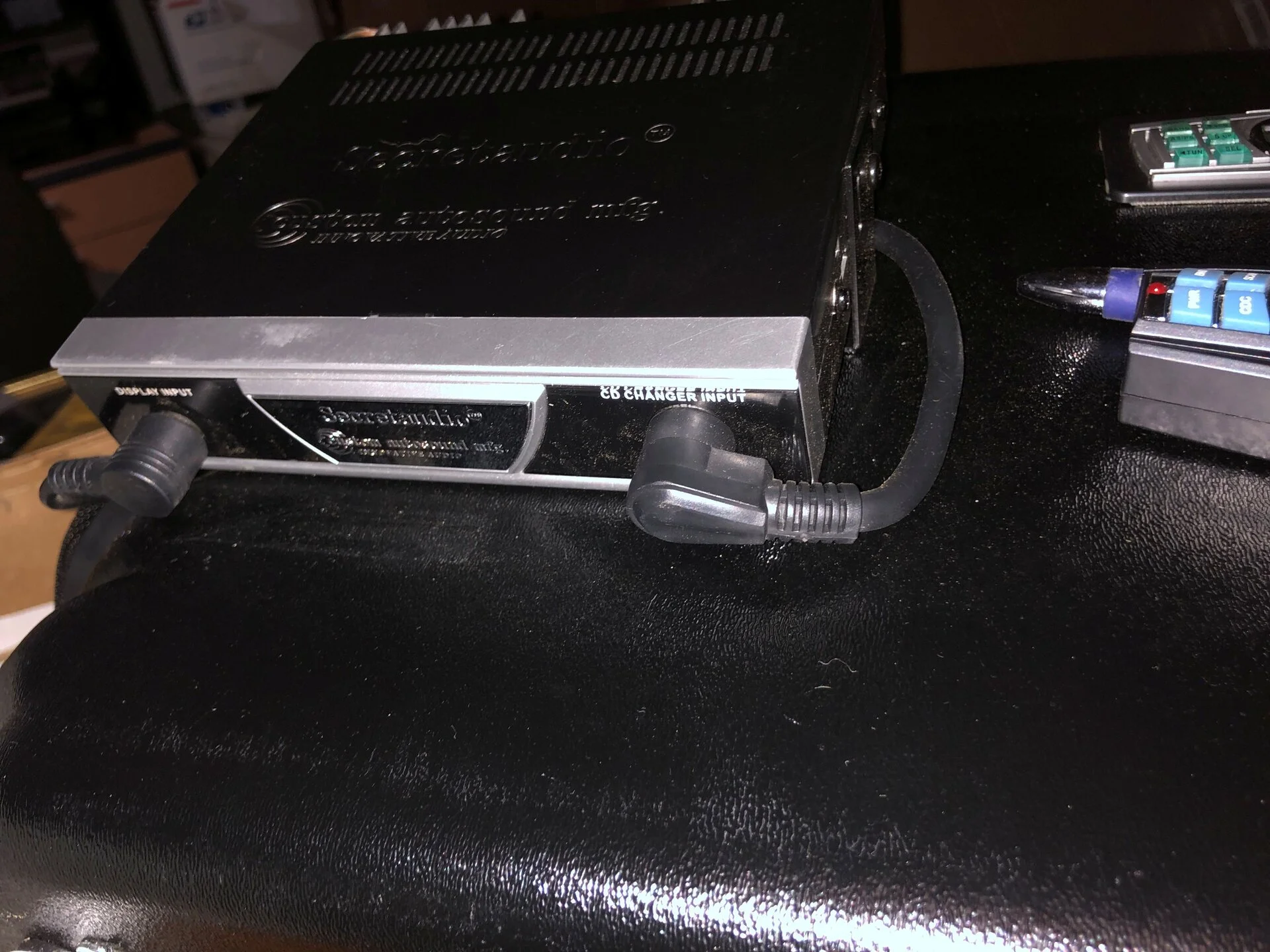

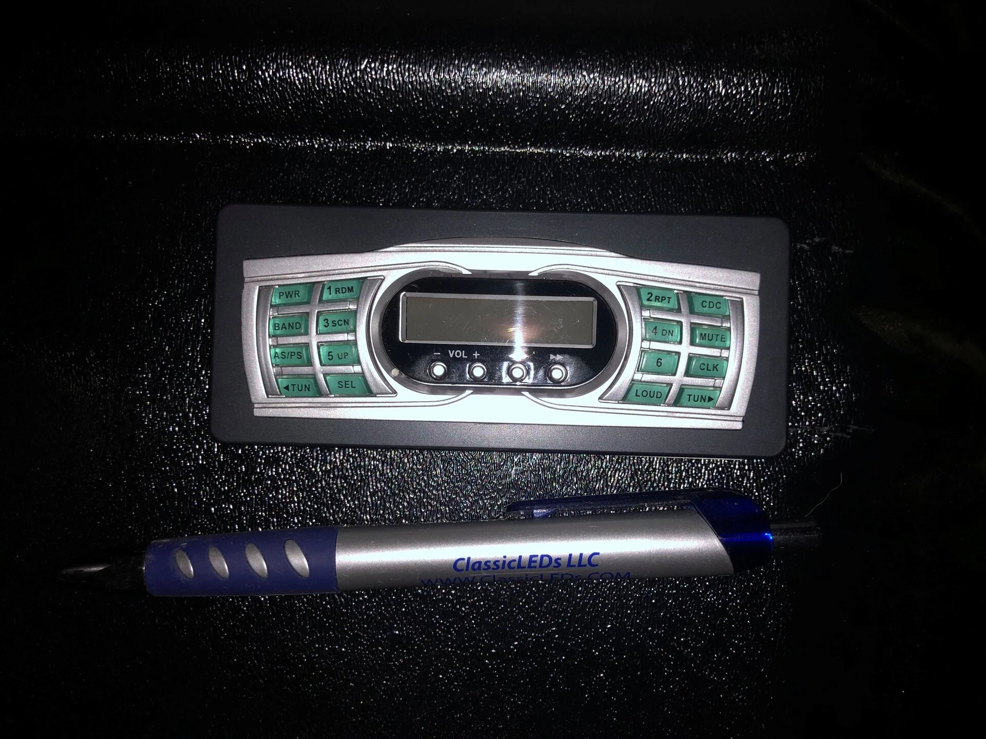

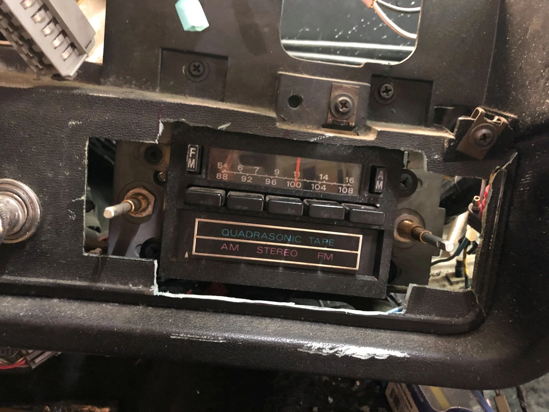

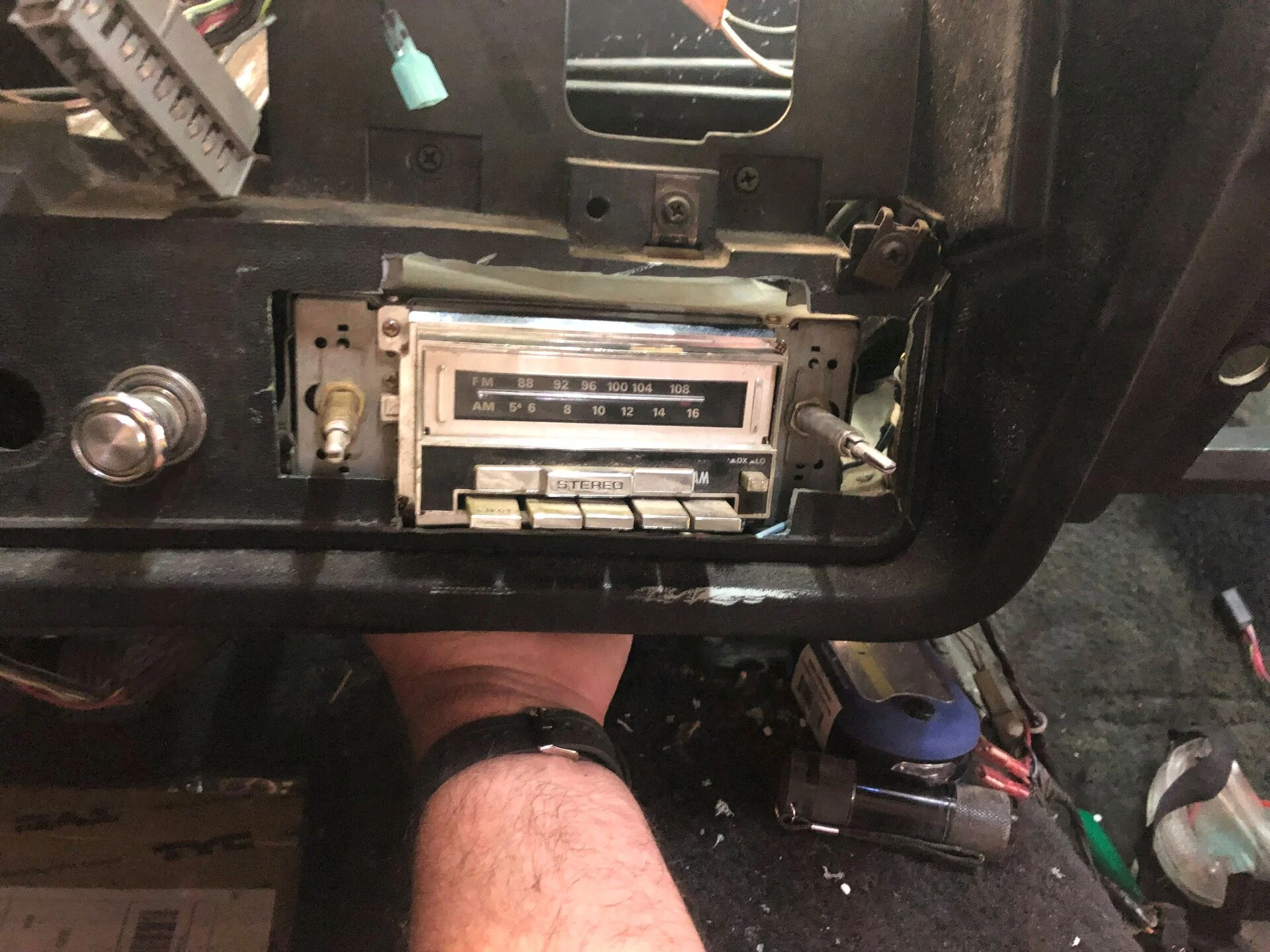

Finally having time for the stereo 8 Track installation. It seems neither of the players I have work. As mentioned before way more expensive to repair then I am willing to pay. I will still look for a working one, but for now I am moving on. I have a black face and silver face radio. thinking the silver will look better as most back then were silver. Still need to repair the massive hole in the dash. My secret audio system is from my display. I sold these at car shows. Tested it yesterday. Found a bunch of CDs still in the player. Wondered where they had gone..... The display is, as shown, very small. Just need to figure out where to put it without having it look odd AND being able to read the display.... It is remote controlled so don't really need to have it somewhere I can reach. Comes with an amp. 4 X 35. Just enough power. Monday I am leaving for a 10 day vacation. Wife has a very stressful job so she wants to go on another cruise....this time to the Panama Canal. So all my projects get to sit for a while. Then the holidays then the Bowl season is upon us............GO OREGON DUCKS! Have enough points on my CC to get an airplane ticket for the PAC 12 Champ game in Vegas..... Cheers.

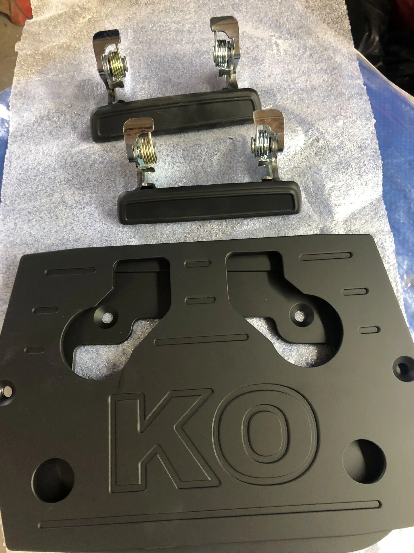

Hello again. I have returned from our cruise thru the Panama Canal. It's still there working fine. Picked up parts I had power coated black before I left. Must say they look good. Also had an aluminum battery box done. Finally got my new heads today. Purchased from a company in Fresno Cal. Found them on ebay. Hope to start working on my engine in January. Need to get back to wiring next week. Spending this weekend in Las Vegas going to the PAC 12 Championship game.......GO OREGON DUCKS. Game on Friday night on ESPN. My wife and I will be wearing yellow so look for us.....We will wave. I also have a plastic yellow duck hat... Just think of a big rubber duckie for the bathtub with stuff stuck into it with flashing LED lights.............Been seen on TV. At the Rose Bowl and on the old TV show about Southwest Airlines.....Wishing everyone a most blessed and safe holiday season beginning this weekend and throughout the month.

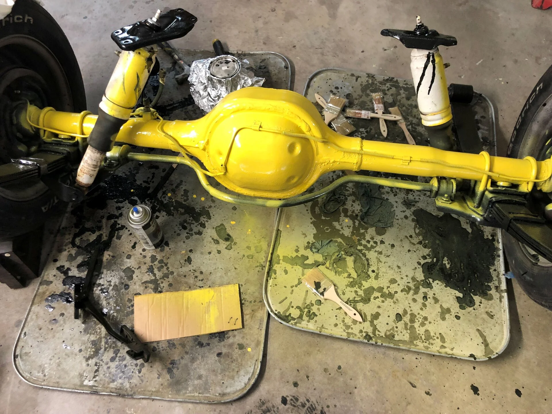

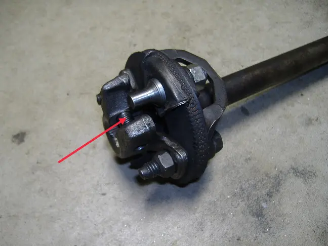

Been working on the rear axle and brake lines. Painted the rear axle yellow and installed new brake lines. Painted sway bar and such black with POR. Painted air shocks yellow with black. Hope to have this installed tomorrow. At least hanging on the body. Also installed new brake line from the rear to front. Start on front suspension next. Tried to take the connection between rack and pinion and steering wheel shaft, but the bolt seems to be stripped at the input shaft end. I think I have this written correctly. any ideas how to get that off???

Do you mean the bolts at the rag joint? Or the bolt that clamps the joint onto the splined shaft at the rack? I do know that the bolt at the top of the intermediate shaft holds it to the steering shaft through a notch in the steering shaft, but the lower bolt is just a clamping bolt as I recall.
(Stolen from FEP member mrriggs)
I'm assuming you're talking about that bolt. It should only need to be broken loose for the shaft to separate from the rack. Of course it will need some persuasion, but it should separate without having to remove the bolt. It's probably rust-welded so soaking some penetrating oil wouldn't hurt.
Now, if you weren't able to get it broken loose..... I'm not above cutting these things. :D Or maybe heating it with a torch could help. I don't remember there being any Loctite on mine, but it's been a long time and not out of the question so heat might just work.

Mine was stripped. It's a fine thread if I remember correctly. Difficult to find a replacement. But after doing everything suggested above, it finally came out. While in there replace the dampener portion of the rag joint.

thanks for the information. That is the bolt. I have begun spraying with penetrating oil. Will begin tapping on it to break up the rust and help oil soak the bolt. Will give it time to soak in while removing the shocks/A frame and and springs for replacement with coil over. Then will do this as I need to replace the rack and pinion. Power steering pump was filled with water when I got the Mustang.

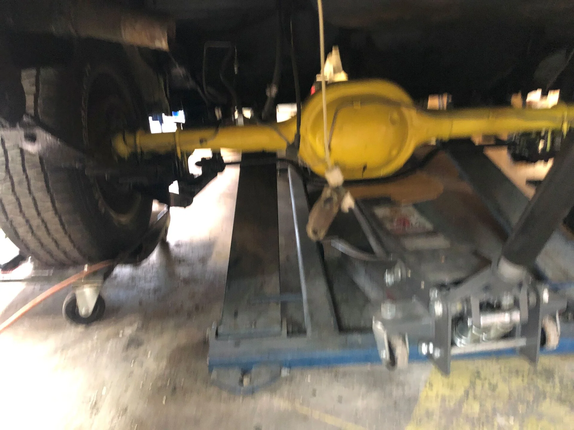

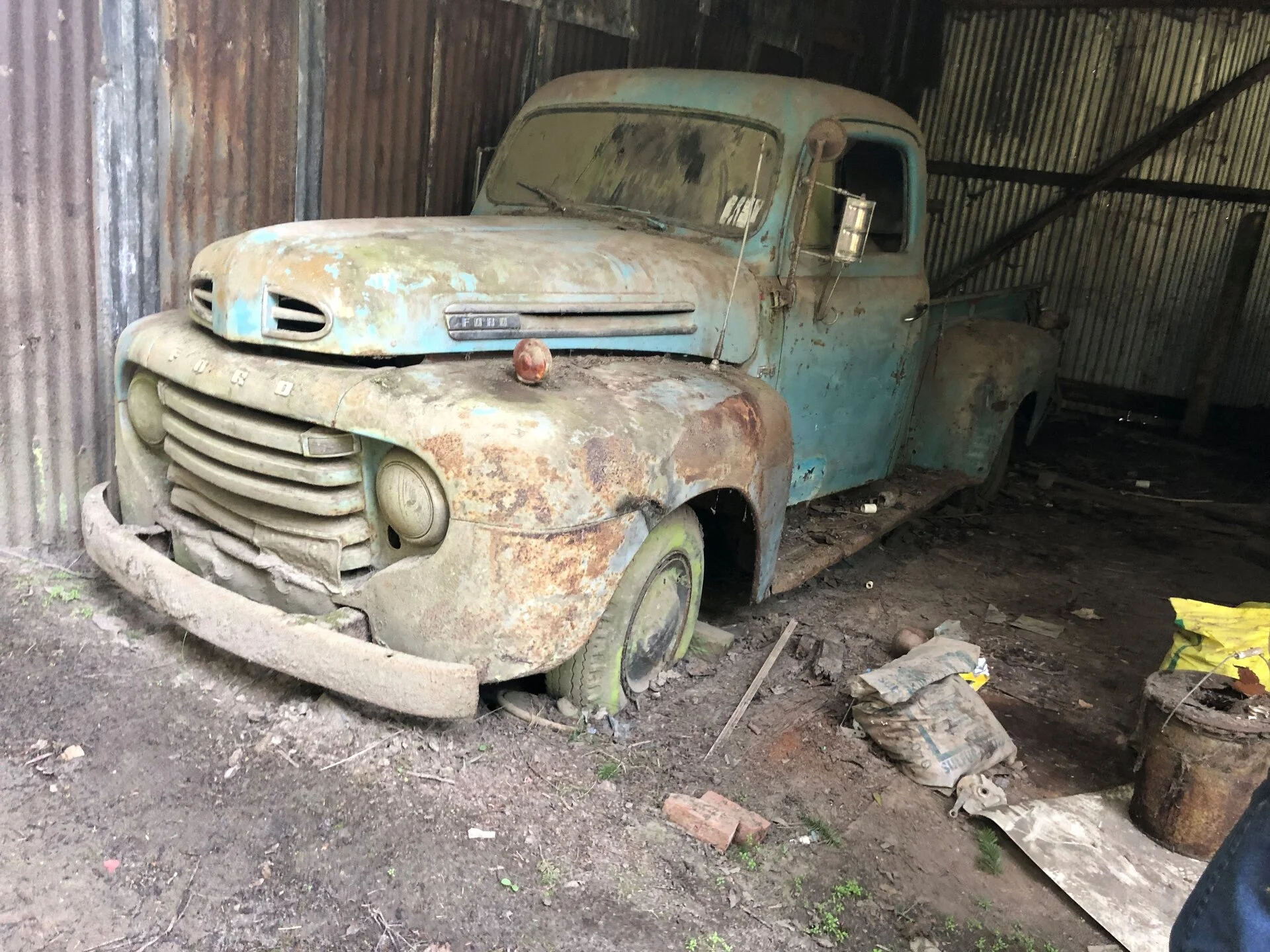

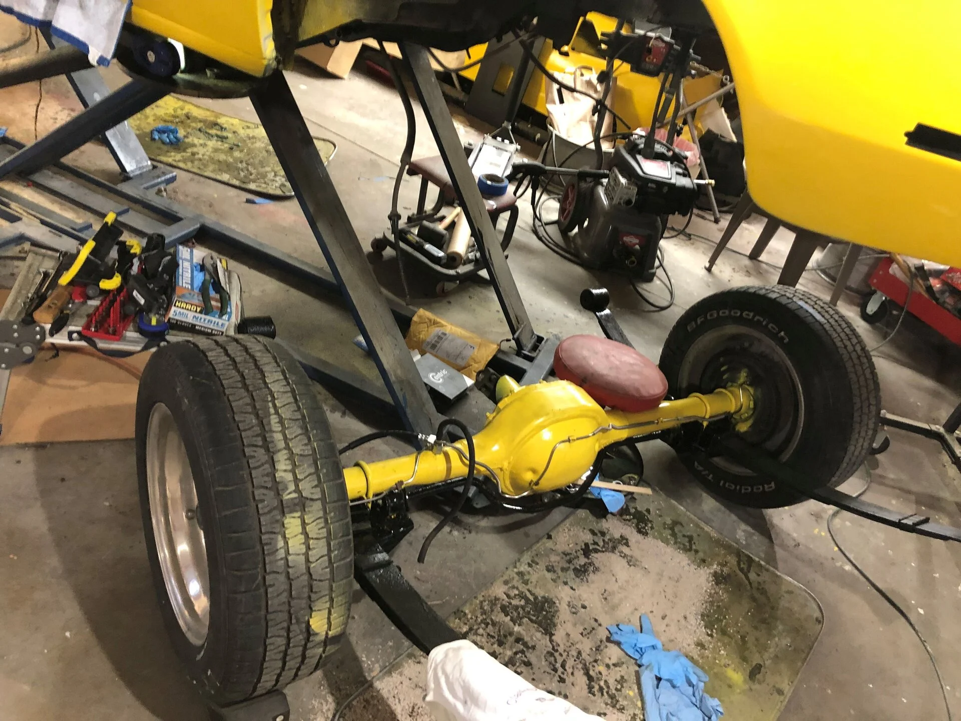

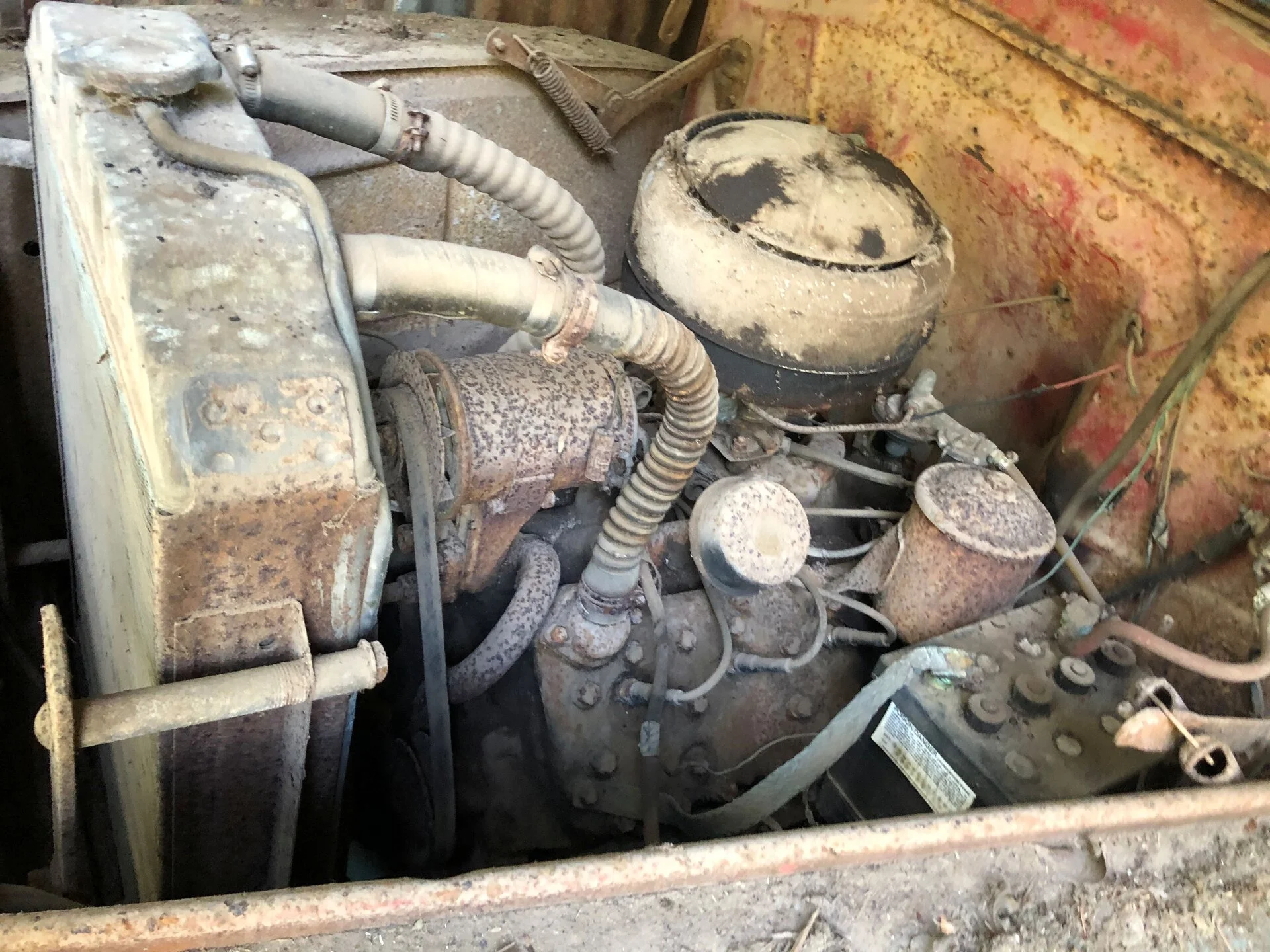

Rear Axle has been attached. :banana: Also installed new brake line from back to front. New air shocks painted and almost installed. Just need to attach to axle. Then front stuff. As a side note. Had to drive my wife to Bandon Oregon for a meeting with someone she is doing so work for. Instead of sitting around during this I was taken on a tour of the property......lots of it and many old burns/shops. And this 1948 Ford pickup jumped out at me. No really it did. Been sitting there for 25 years. Has bad generator so why fix it???? found out it may become a flower pot in front of someone's business. Truck is complete down to the really old lic plate and OEM flathead. So, if the underside is as good as the rest I want to get this. Just need to convince my wife this is a good deal........Also found a 1971 Thunderbird with a 429 thunderbird engine. Thought these were bringing in good money. Found out not anymore. Body in good shape, but front is kinda ugly.....no real market for that year. Also a 35 Chevy, complete. Just walked pass it.
