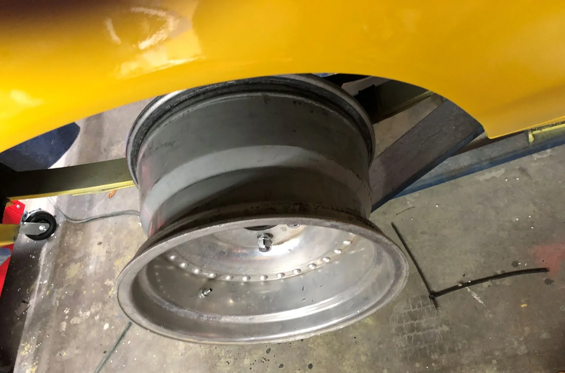

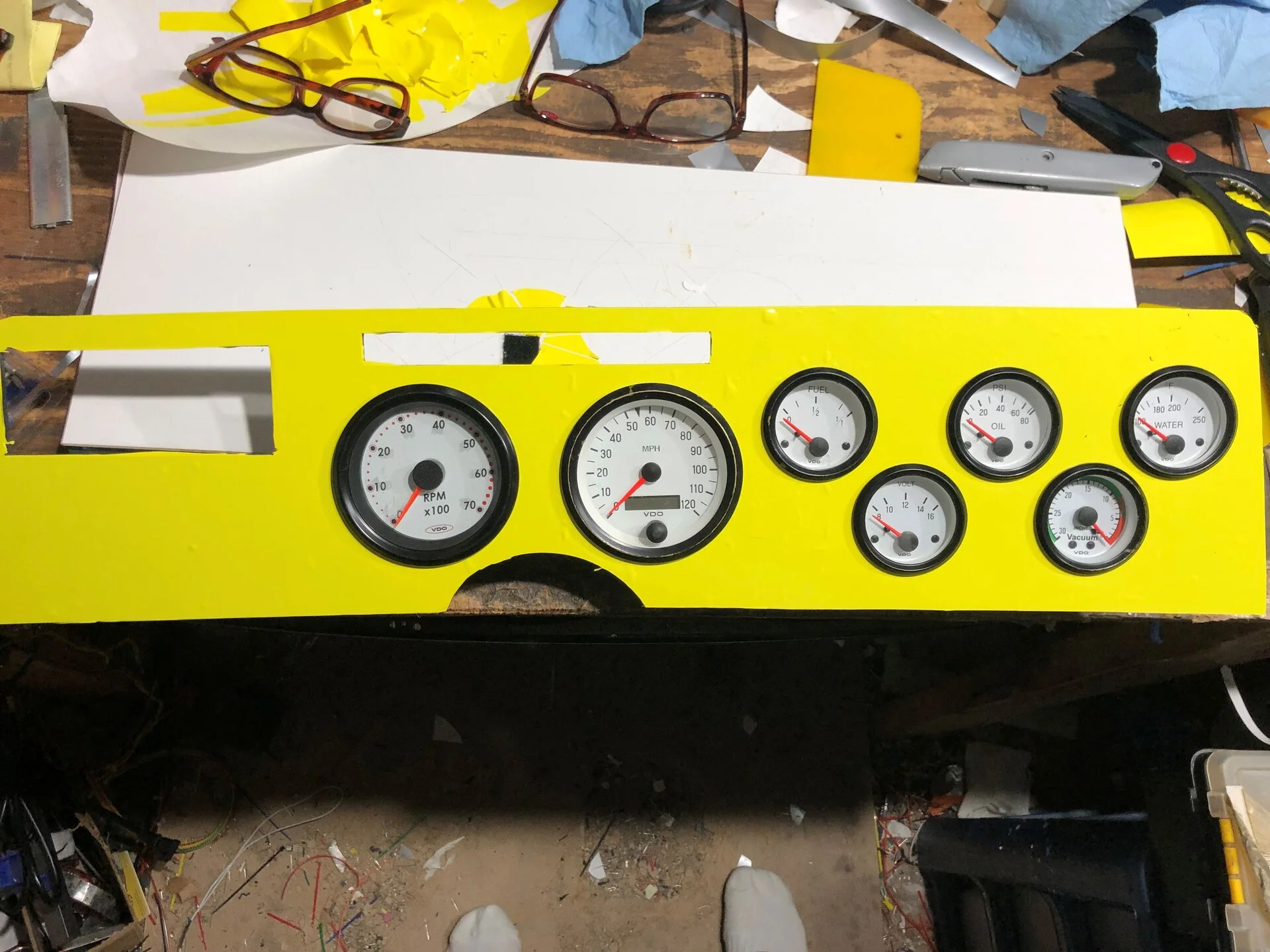

The rims I have talked about arrived today. Test fitted and they are way to big, as the photo shows. Gave it a try, no worries. Feel free to buy them. Finished first test fit of the gauge support for the dash. Painted the support yellow. Will be trimmed in black. don't know if this is to much yellow, but will test fit into Mustang soon.

The rims are way too big? Do you mean they're rubbing on the springs and/or body? Or do they stick out too far?

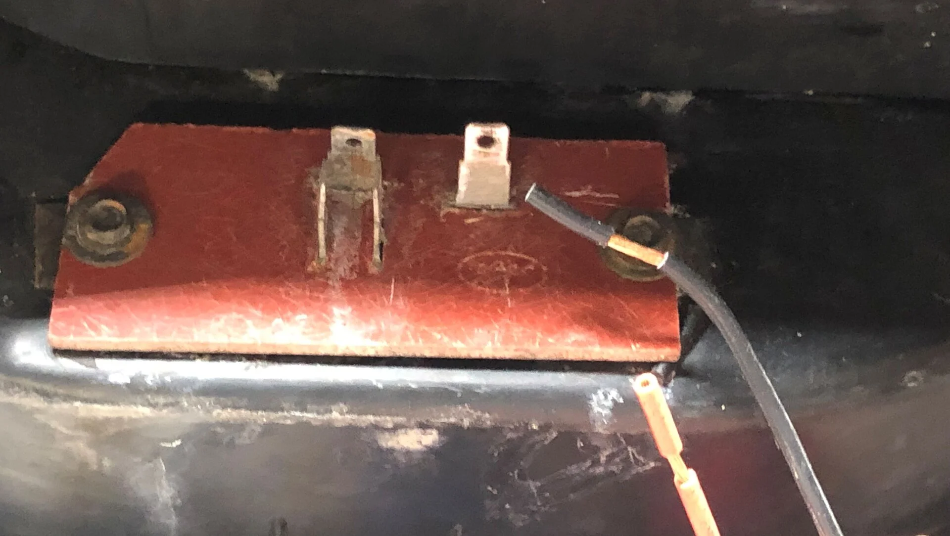

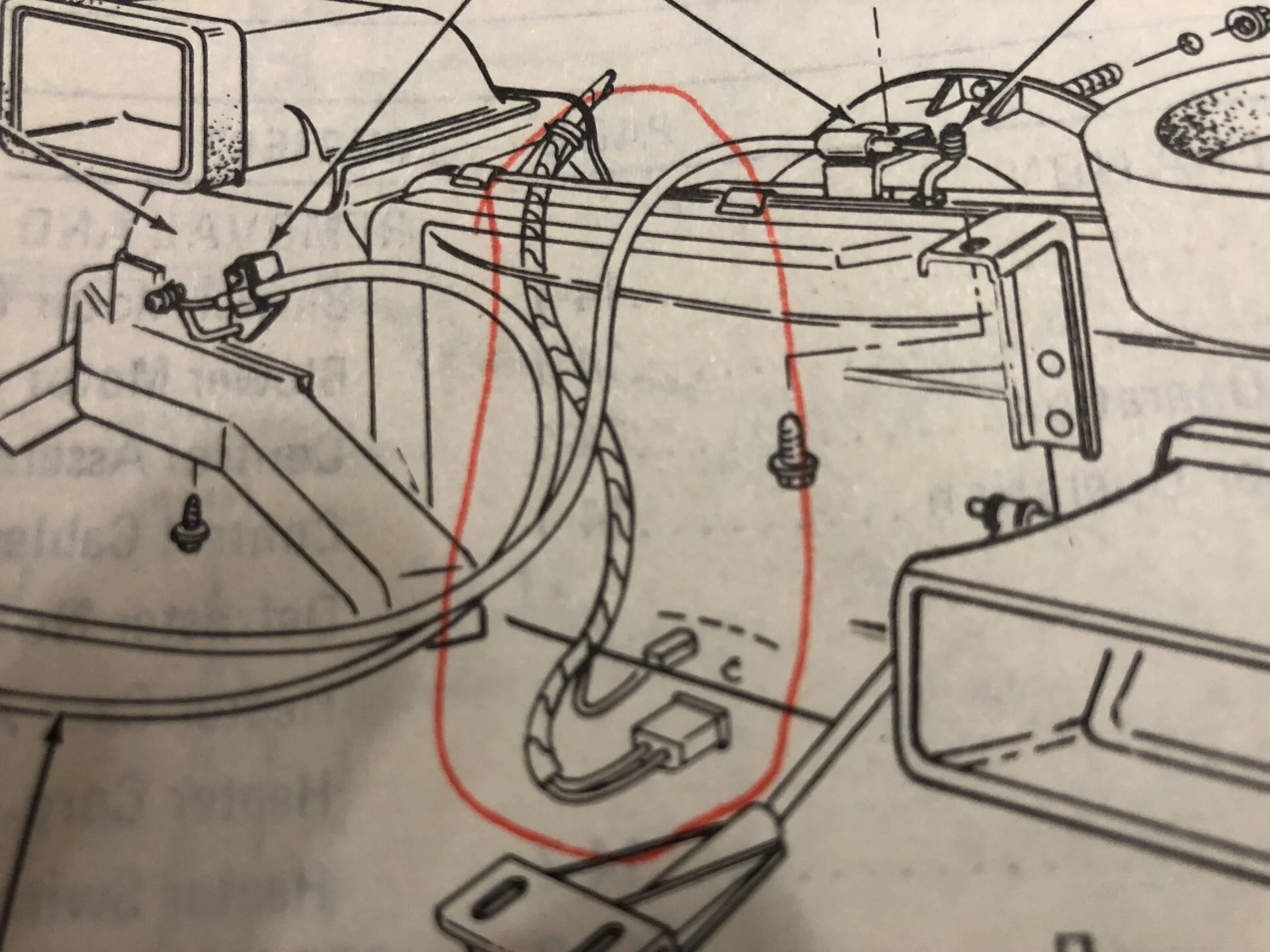

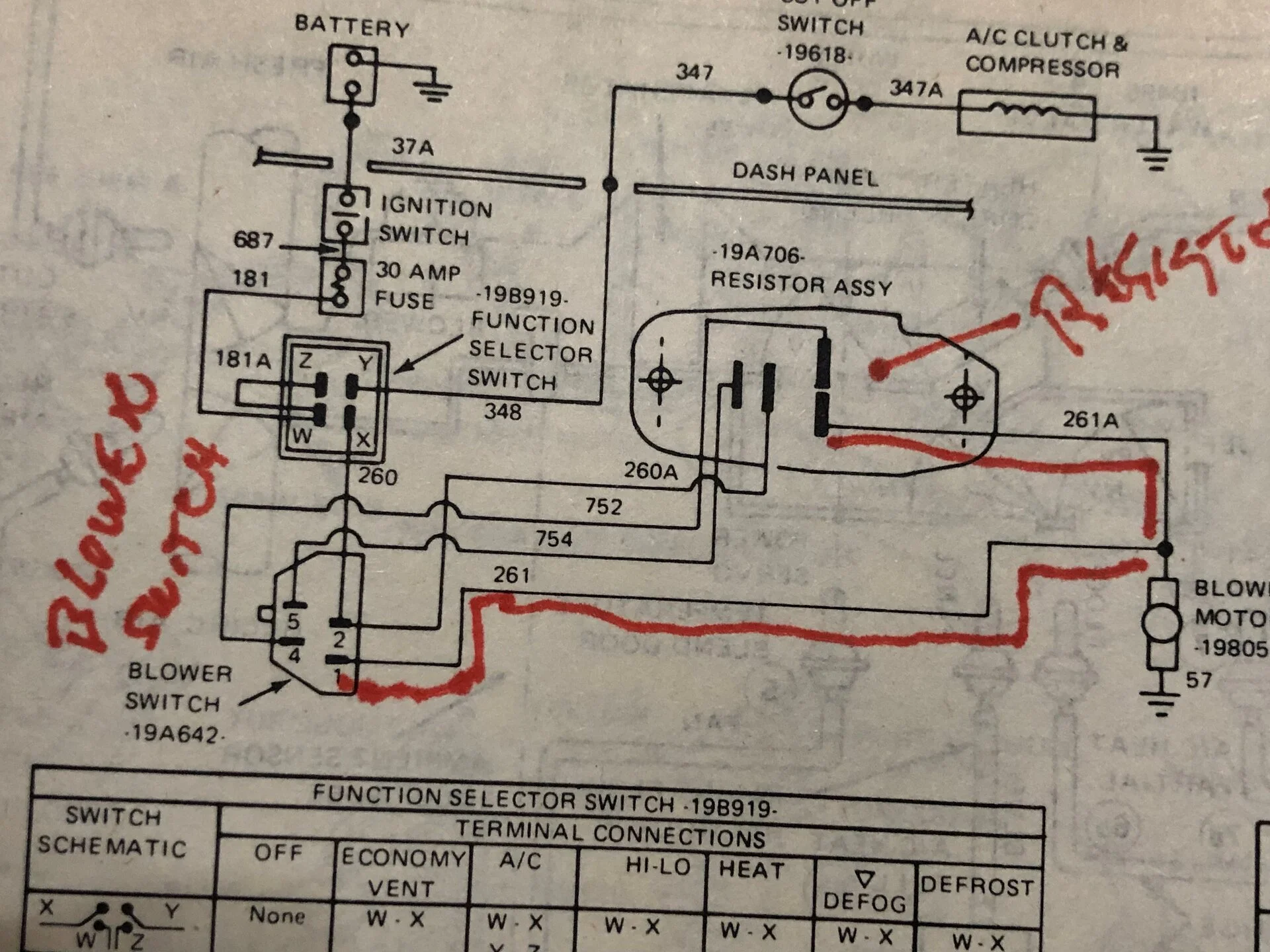

Heater Blower Wiring. Replacing the heater blower motor started out sooo easy.. Buy a new blower motor, remove old blower, take off fan cage (Cage? Who names this stuff?) and put on new motor. Install.........Well the wire diagram and shop manual show two plugs. I can only find one. The three connector plug. Can not find the single wire plug and there is no cut wire. So, the single connection on the thermal resistor is support to go to the blower orange wire???? Motor black goes to ground. Anyone have and ideas??? Can i just jump from the single spade on the resistor to the orange wire on the motor or is there another secret wire I need to find..............AND what does the resistor thingie do anyway? Thanks
