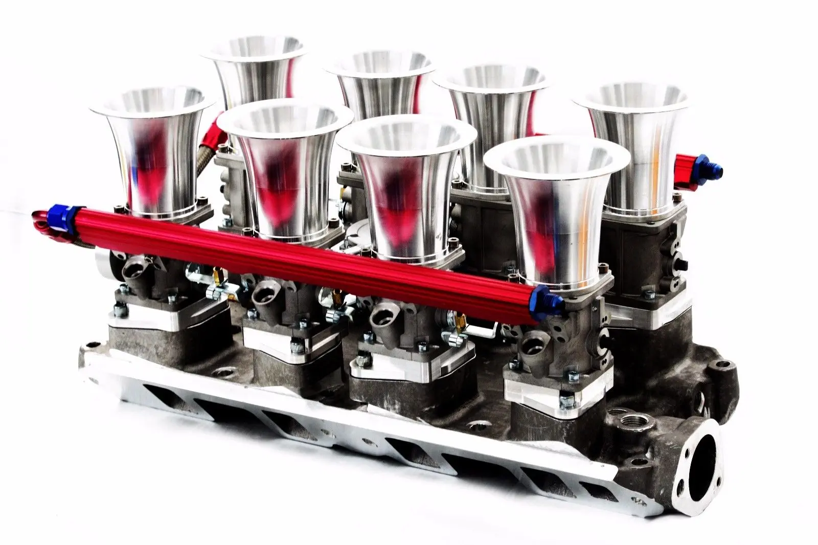

Agreed, from my research the crank is cut differently for the oiling system but the distributor ect spins normal rotation somehow.
Marine 351w apparently came with a hd marine engine rod.... we will see once I have them.
Again budget build, I have some options... if nothing else a cheap 393 with my cam some link lifters if needed (may be roller from the pics) and whatever efi intake i can find will make my power goal a reality.
