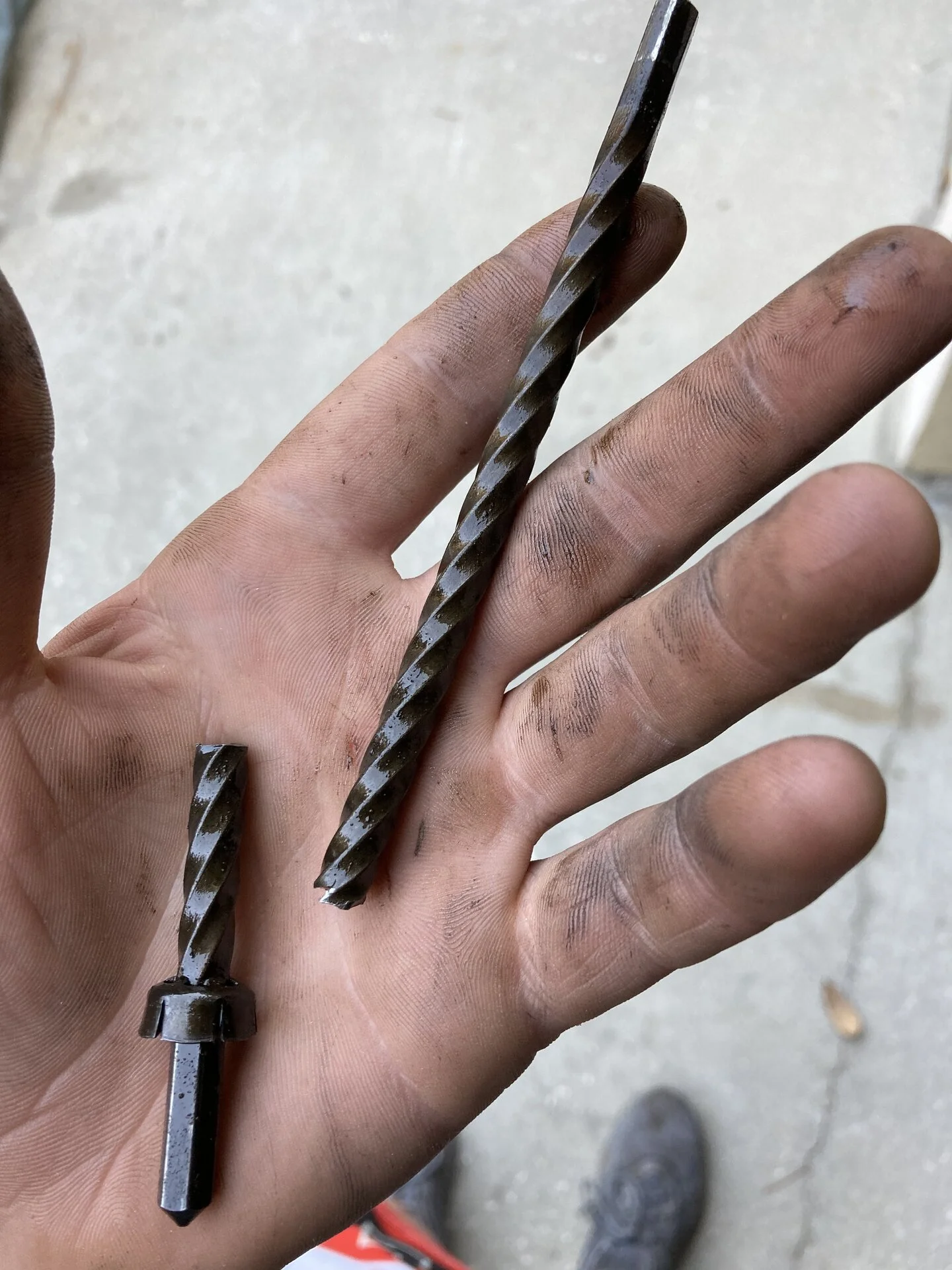

I lost an oilpump shaft in an engine once....I put 25 rectangular rare earth magnets on the front hump of the oilpan to keep the old oilpump shaft in place and simply put another one..Good Luck with whatever you choose to do........
