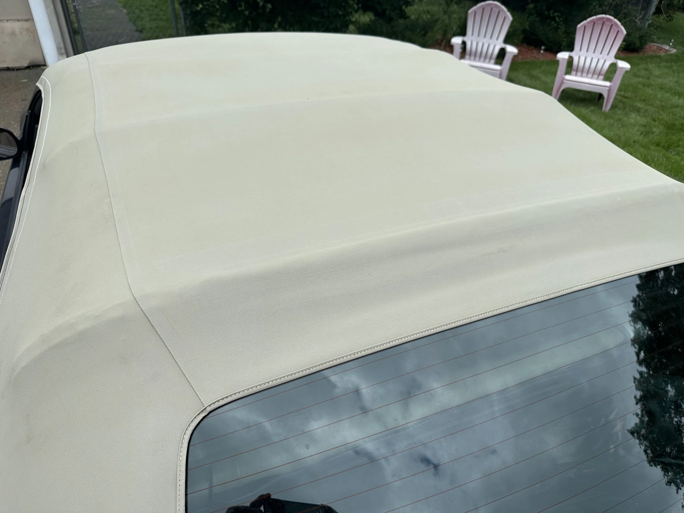

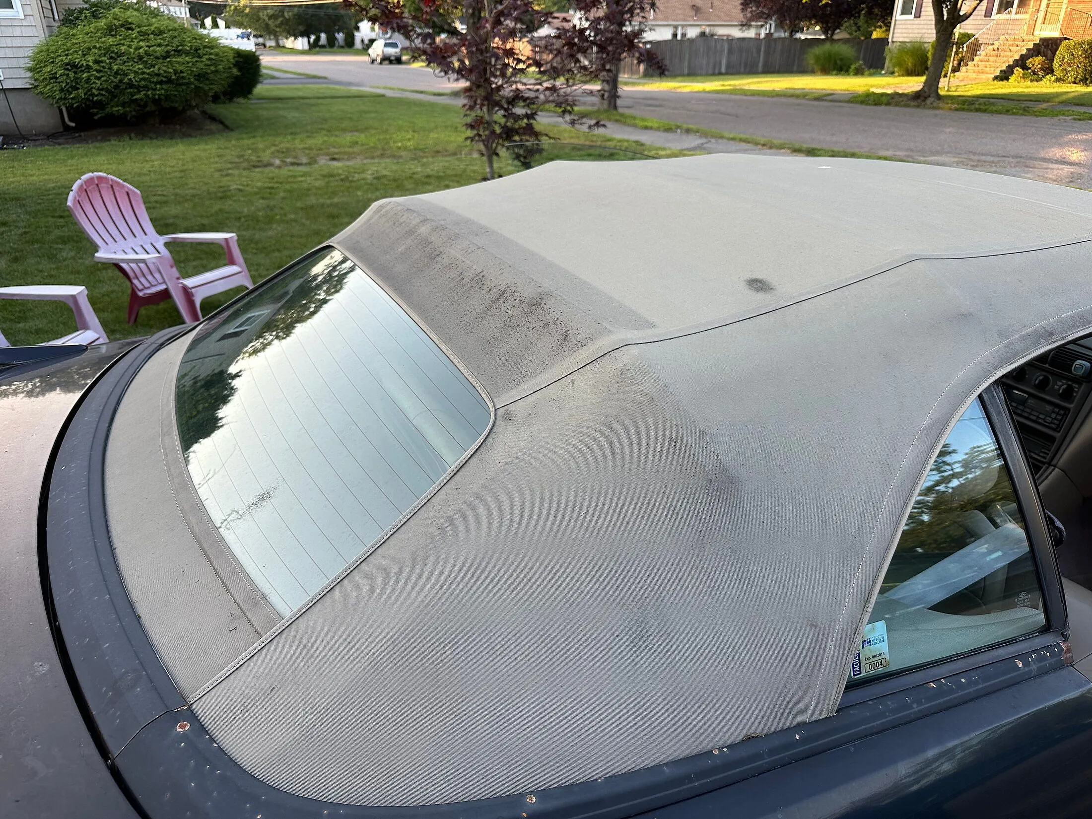

What did you clean the top with??
MOLD ARMOR Mold and Mildew Killer + Quick Stain Remover, 32 oz., Trigger Spray Bottle, Eliminates 99.9% of Household Bacteria and Viruses, Ideal Bathroom Mold and Mildew Remover https://a.co/d/e078tan
Did ruin a shirt with it when I sprayed myself. There is bleach in it, so gotta be careful. Spray, scrub, rinse with tons of water when done.
Reactions: limp
Barbasol shaving cream works great to clean vinyl tops and interior stuff. An old guy taught me that trick and I've used it faithfully for the last 20 years. Works better than anything else I've used and won't ruin clothes. Smells good too. The cheap original Ambersol in the metal spray can. It's cheap at dollar stores and wally mart.

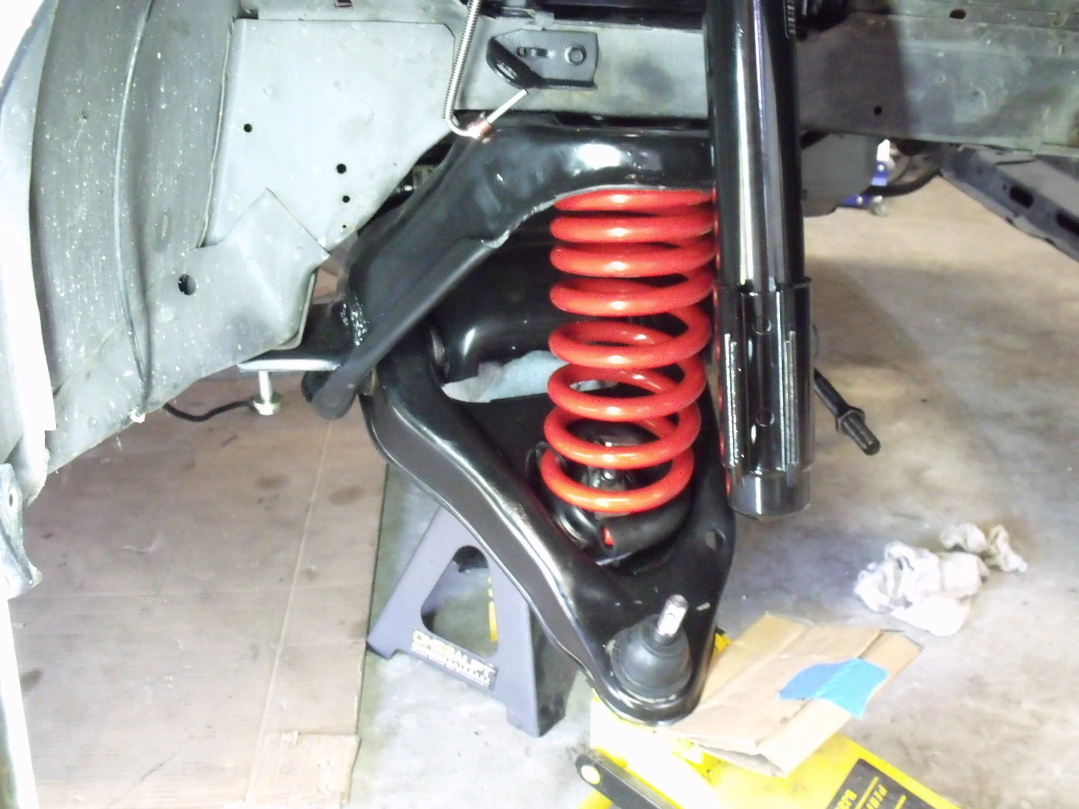

Put the H&R race springs on my 83 vert.. The sport springs were NOT recommended on convertibles by MM... I " think" its a weight issue...
Not on the road yet so I cannot comment on ride quality....
I have pushed on each corner when its been on the ground, and all of the corners seem to be pretty stiff...
