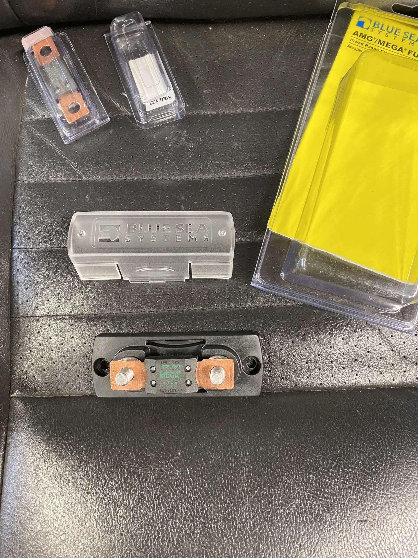

Another source of ARP hardward for buying individual bolts
ARP
ARP
www.allensfasteners.com

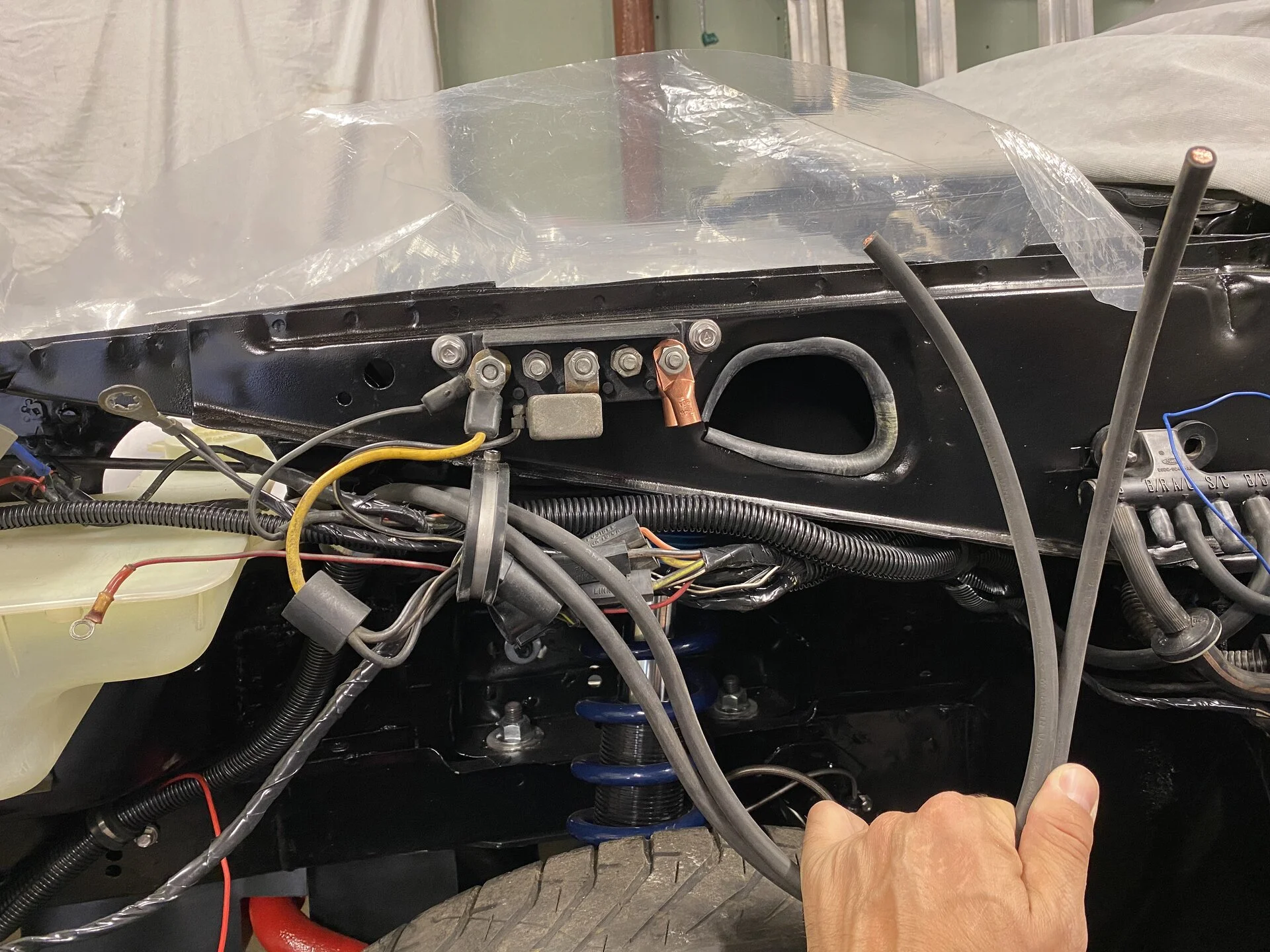

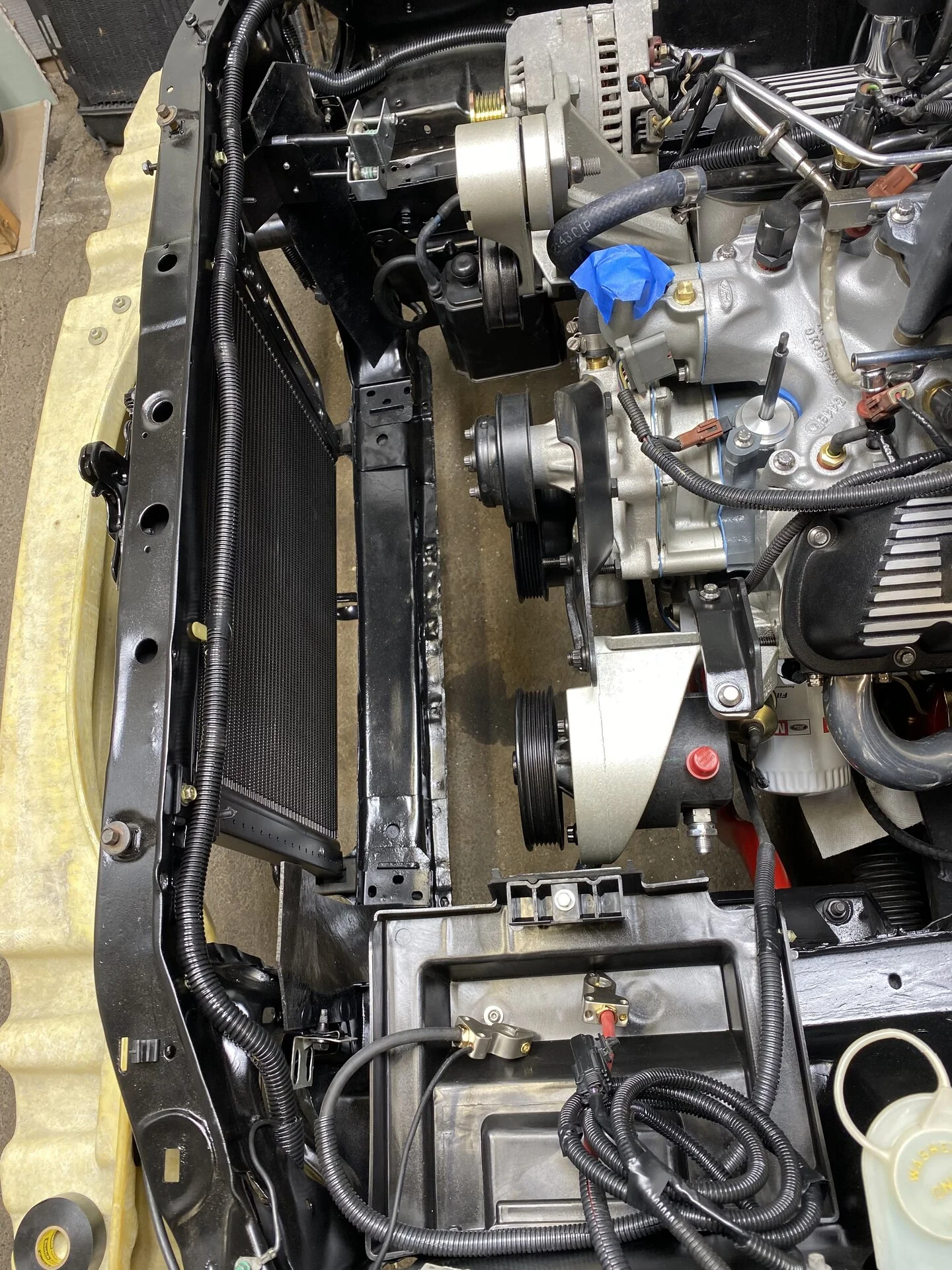

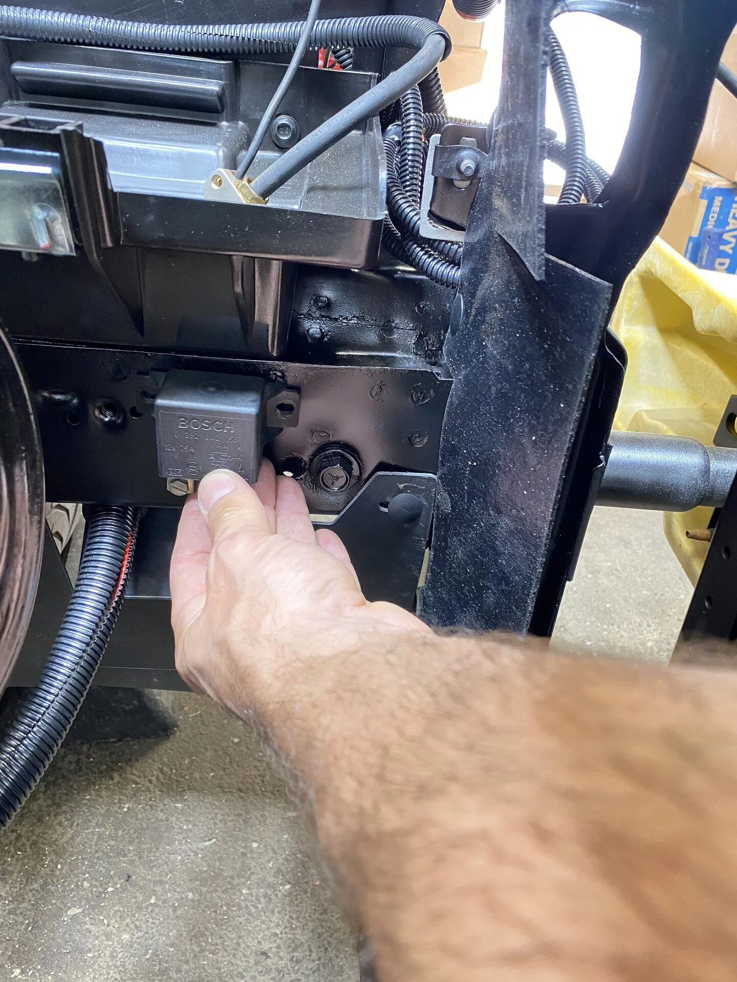

Ok. After sleeping on it, here’s where I’ll mount the starter relay.
out of sight, but I can still access it if I need to jump it or replace it. Car will never be driven in the rain, so shouldn’t be an issue here.
also got my alt fuse. Likely will install on same location on other side
Reloomed and installed the headlight harness. Just need a few misc things and some small wire to wire up the starter relay and the car is almost fully wired.
I want to prime the fuel system and check for leaks, as well as blimp the starter over to make sure that all works.
Reactions: 95BlueStallion
If you run that headlight harness inside the top of the radiator support, it will disappear too. Just sayin.... I know you don’t want to go too far. Lol

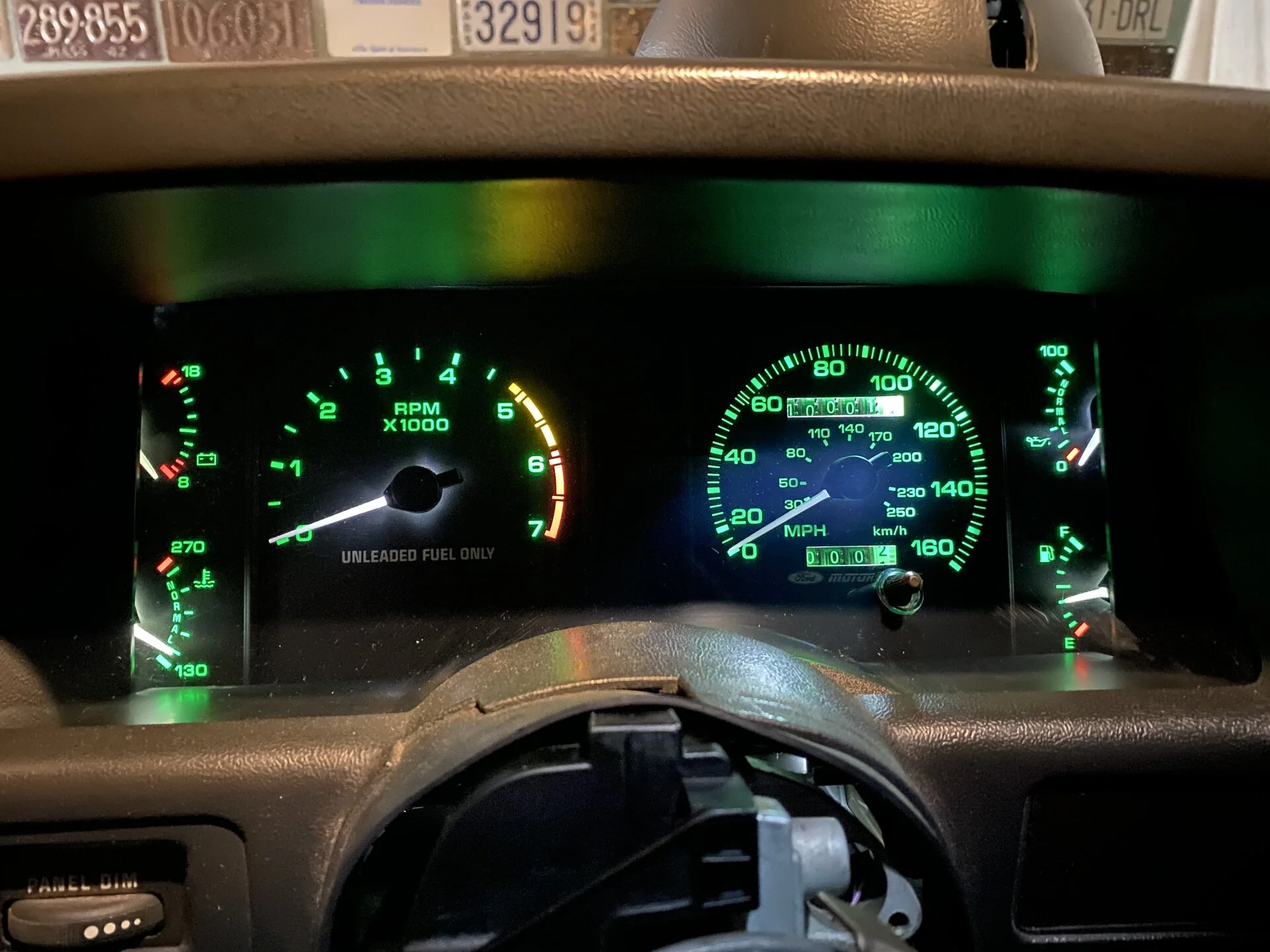

Ok. Defrost all set. Looks like one wire pulled out of the plug.
Just need to chase down why the brake light on the cluster doesn’t come on next.

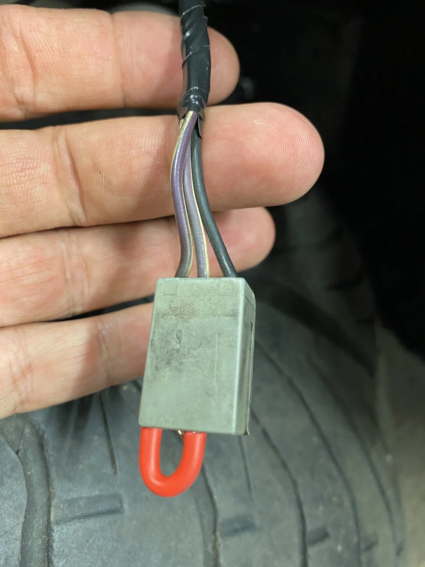

Brake light was easy. If you ever unplug the MC sensor permanently, the two purple/white wires need to be jumped.
Ok. Everything seems good. Just need to wire in the alternator fuse, and wore in the starter relay and electrical is done.
