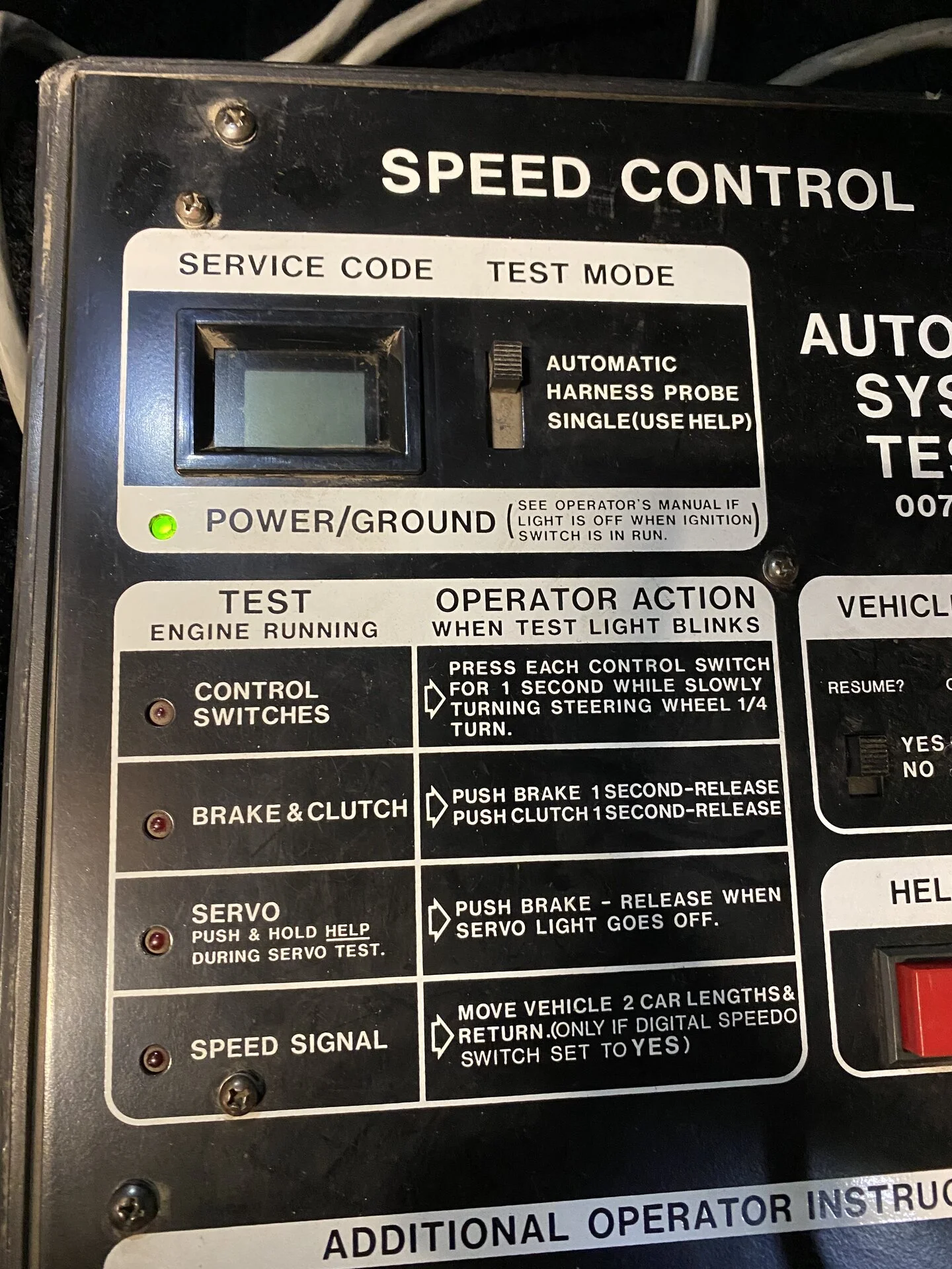

Got around to using the Rotunda 007-00013 speed control test system. Pretty easy to use. I disconnected the wiring from the amplifier and connected it to the tester and it runs through some system checks. Tested the buttons, the brake/clutch switch and servo operation. I managed to do it without running the engine. I used a vacuum pump connected to the vac tree to provide vacuum for the servo. It worked well.
I actually found I had an issue with the brake and that was due to the LED bulbs in the taillights. I figured I would have a problem with them. I had to put one regular bulb back in to get the system to test correctly. I will test to see if i can get away with the leds or need to add a resistor.
Of course, this tester does not test the actual cruise module, so lets hope that is functional.

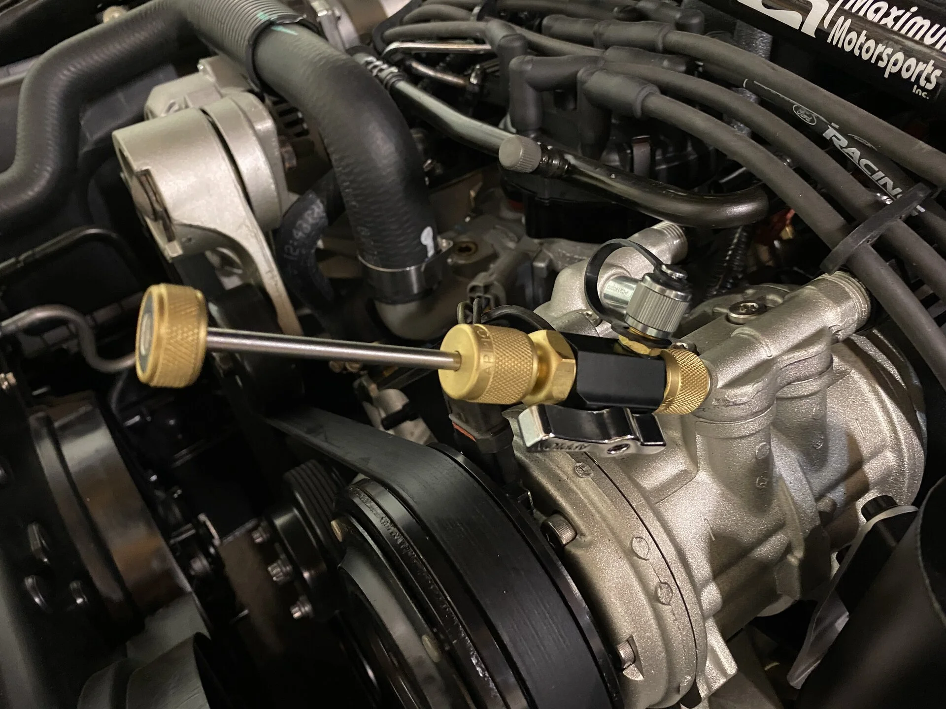

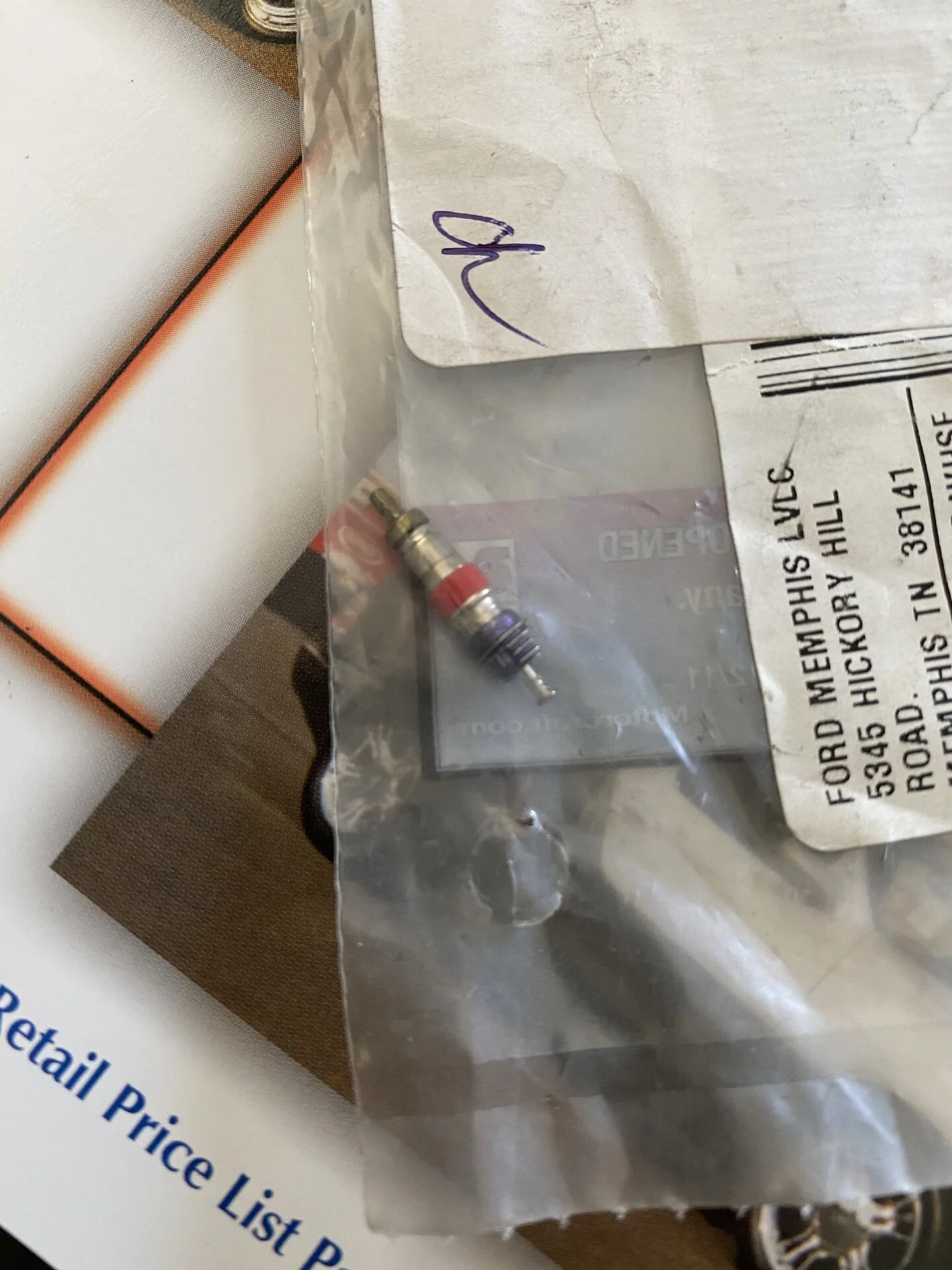

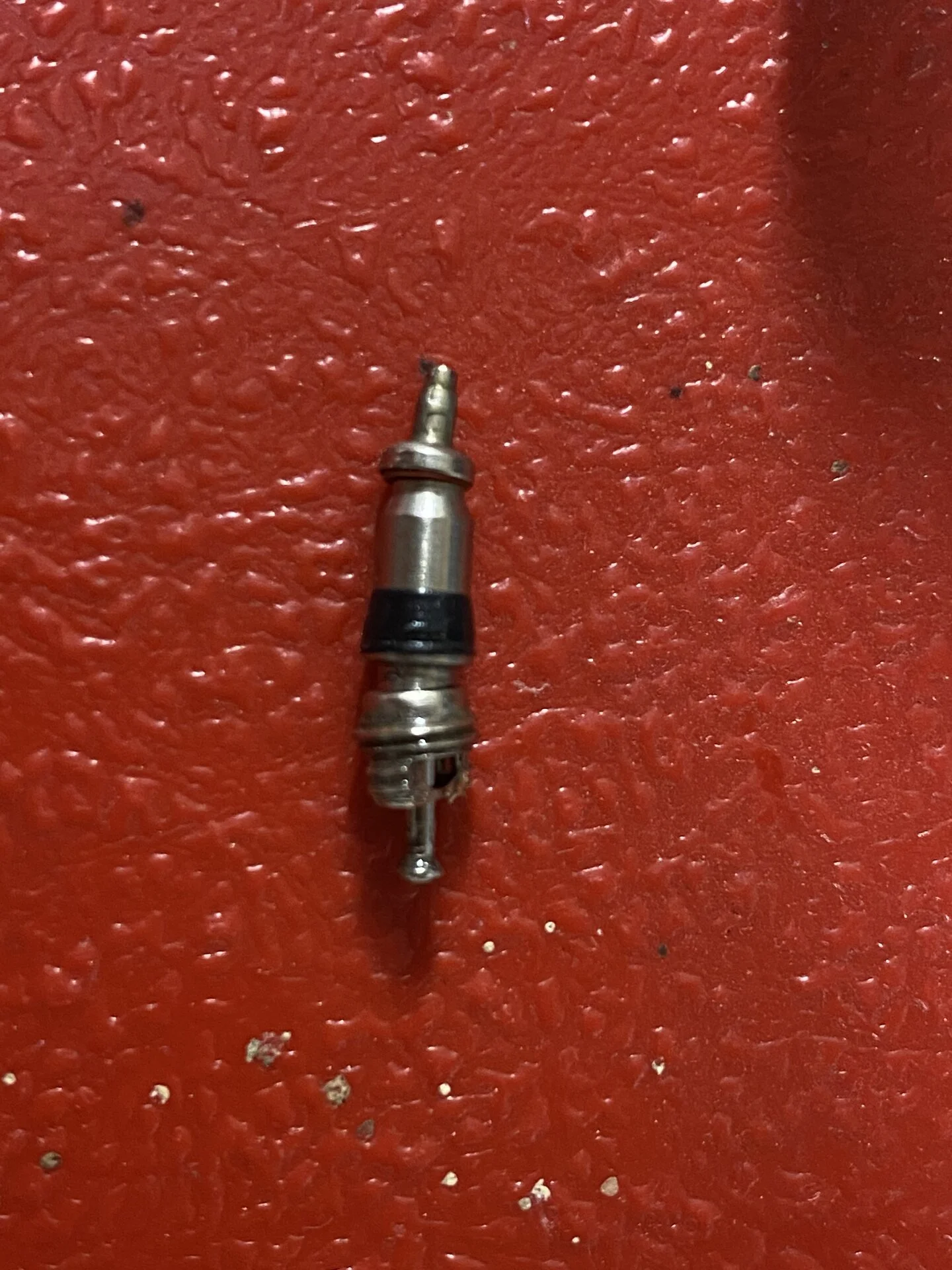

Valve for the ac came. Amazingly I found it on Rockauto.
Used a valve core tool to swap it out. I did backfill with nitrogen (again) when I busted the old valve. Easier to keep the system moisture free under pressure vs in vacuum.
Old one. Don’t ask how I did it
Ironically too hot to start the car and charge it. My garage is a nice cool 60 degrees inside and it’s 90 outside. I just don’t want to open the door.

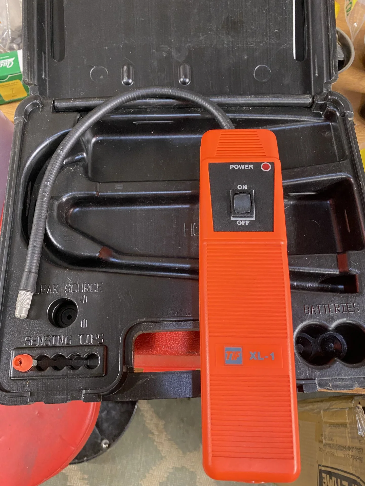

Ok, came home early and decided to charge the AC.
Hook the vac pump up and just let it pull down for an hour while I did some other stuff.

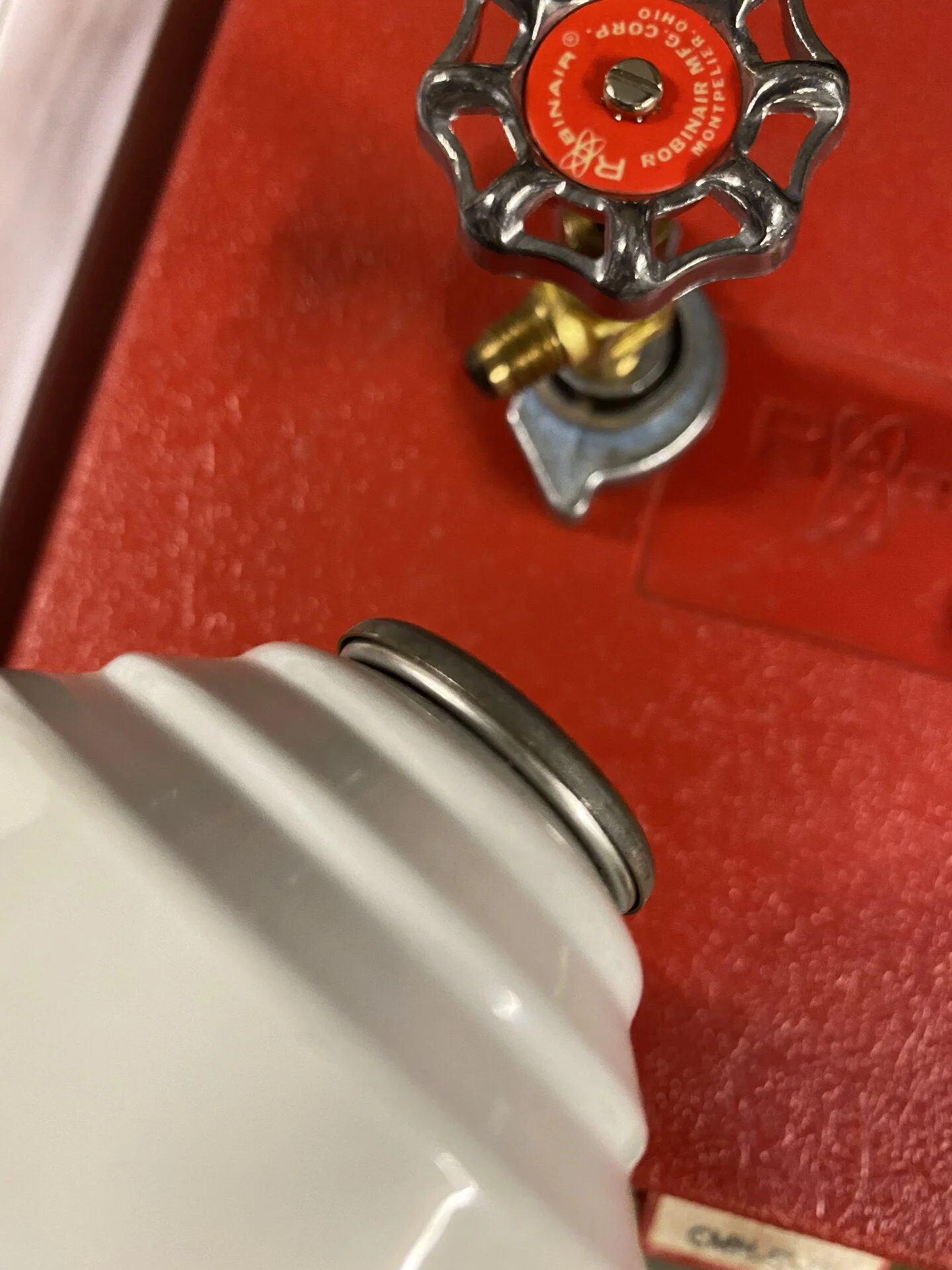

Go to hook up a can of R12 using the old school can tap and she starts hissing from the top seam when I attempted to clip on the top can tap.
Right here (different can)
Leaked a bit but then stopped.

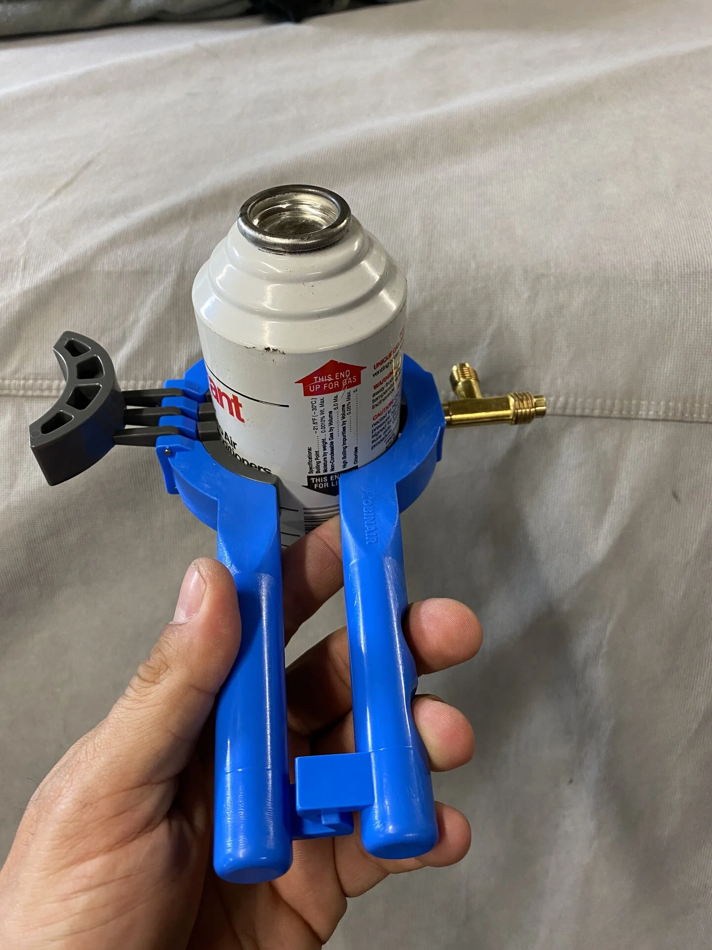

After thinking about it a bit, I decide to play it safe and order me a side can tapper instead.
I don’t really think it will rupture, but if I put the can tap on top it will leak before I can get it hooked up. I’ll prob end up venting off most before I can get it in the car which screws up my intention to charge by weight.
I snagged this off eBay pretty cheap. Tested it on the leaking can and it works damn well

Can side taps are the way to go.
Here’s the leaking can. Good to go.

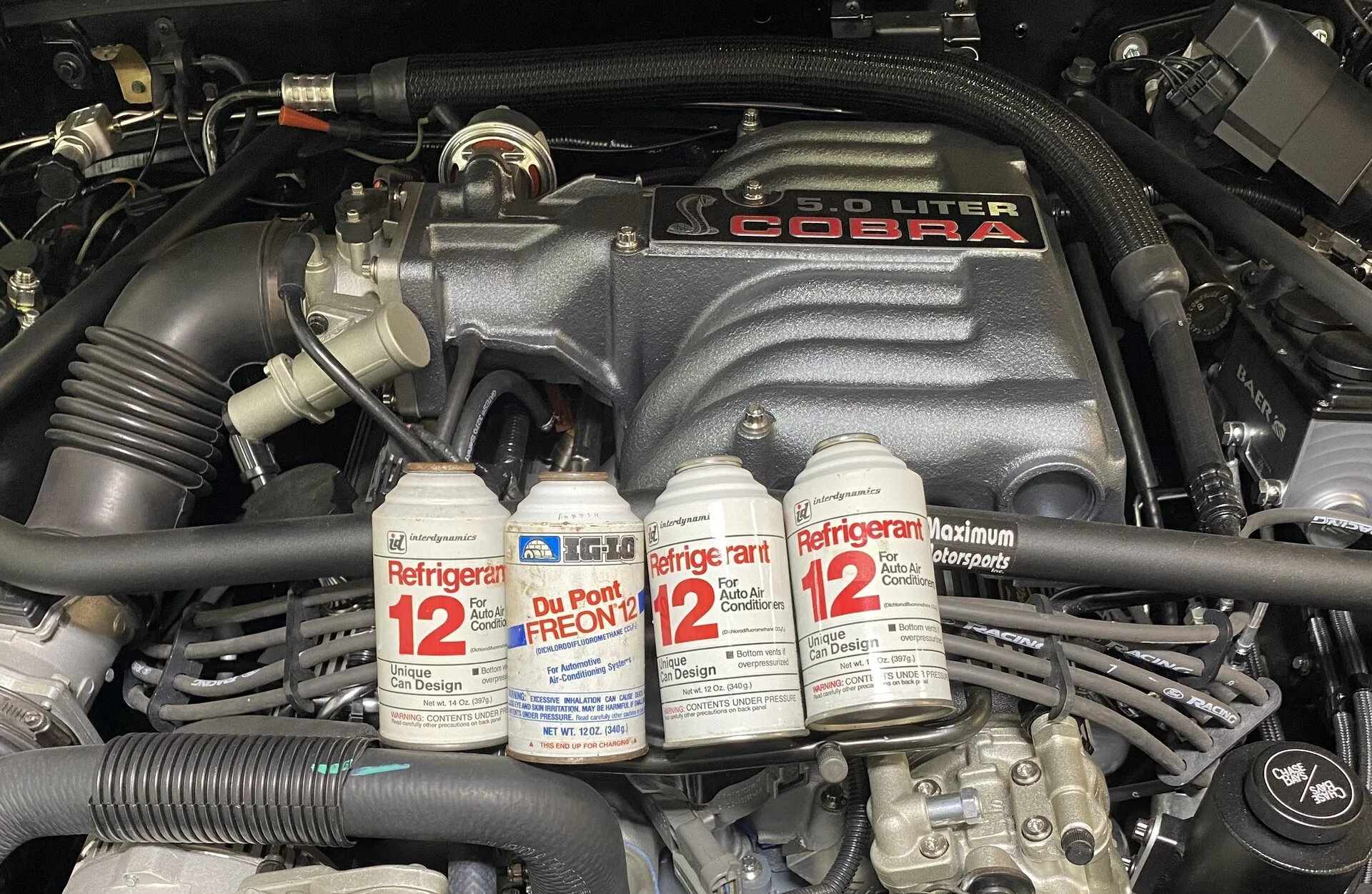

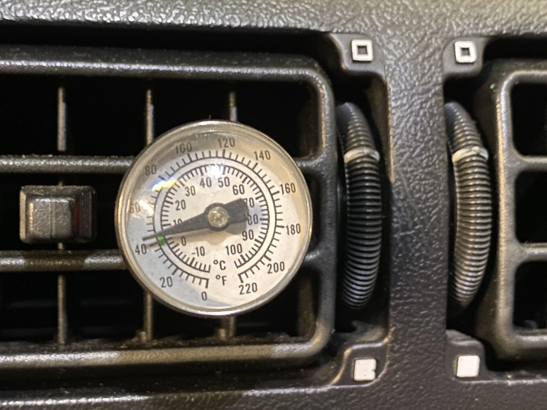

Done.
So weird to sit in my car on a humid 80 degree day in AC. Normally I’m sweating my butt off.
Last time the AC worked was when I was 17ish. Used it a few times late summer/fall and it might have needed a recharge but it took the edge off.
Then I decided that I needed to go 0.05 seconds faster so I ripped it all off. Stupid me.
I have to say, total PITA doing this with R12. If I had to start all over from scratch, given what I’ve learned I just would have gone R134a. The issue is because R12 is so obsolete, it's tough to find the right info on it. In researching, I learned firsthand from some AC experts how to optimze this setup for 134A
