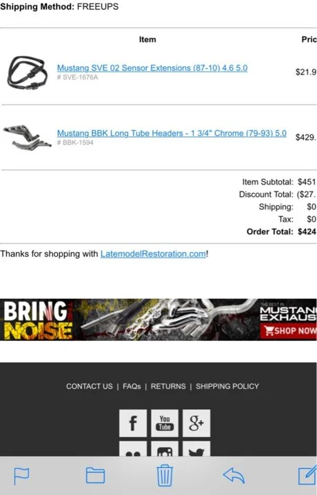

My moms real cool about this stuff shes been around it since she was 18-19 from my father and she basically raised me when he passed and always supported my hobby knowing it was a passion. But ill let you in on another funny one. Those didnt come free Her and i share the same birthday LOLHoly crap I was just there ordering my o2's and mid pipe. Lol. Wish my family would buy me parts. Lmao!! Better make sure you buy mom some nice Mothers Day present![]()
