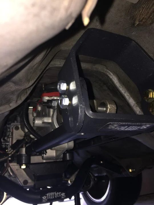

Thank you for confirming yours is the same . I emailed stifflers a picture to make sure that I have it correct . The spacers are supposed to correct the pinion angle of a TKO cuz apparently the mounting pad is deeper on the case then a T5 .
Let me add that they are nothing short of amazing in the CUST service dept . What company answers emails on a Sunday morning . I sent them a pic they said all is well , I may just want to move the drive shaft loop above the bushing to give the ds more clearance .
Drive shaft loop is in . Stifflers says to trim the torque arm mount on the TKO I wasn't feeling it so I cut the center of the brace instead . Still feels rigid to me

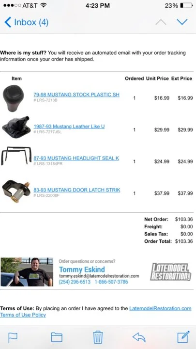

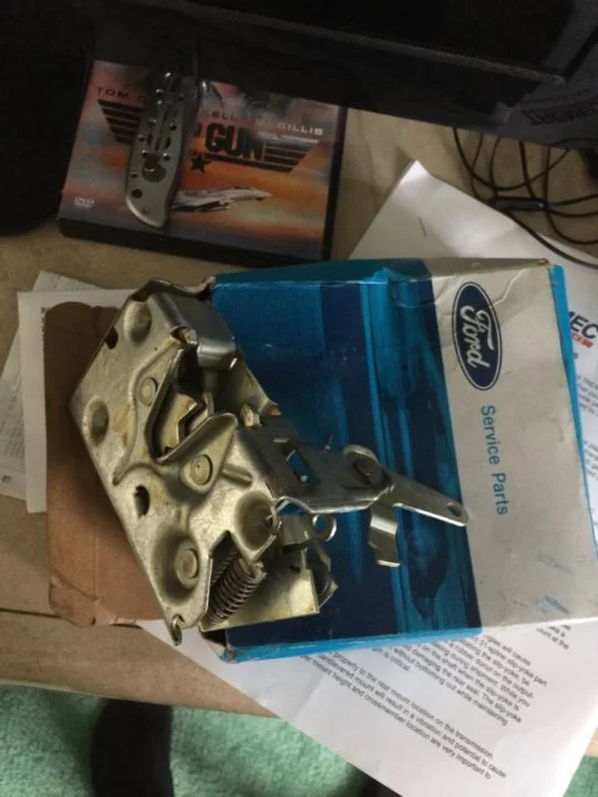

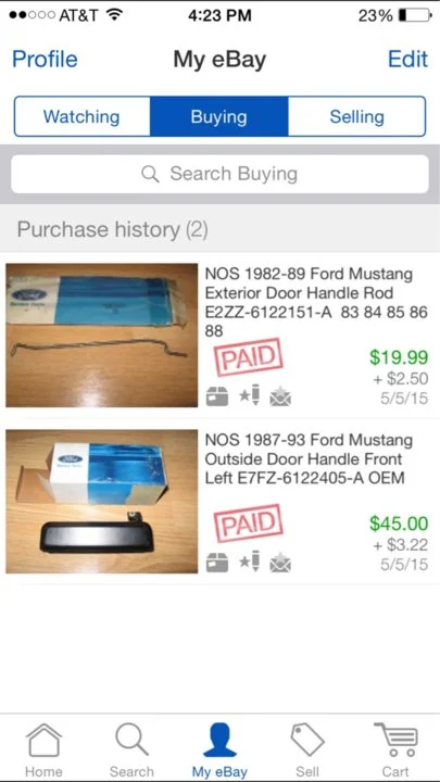

Spent well more money today . Lol My drivers door has always been a nightmare opening with the door handle very hard almost feels like your gonna break it . Well problem solved . I bought everything new oem - door handle , latch , striker , and the door handle rod . I re did the door pins before I painted it hoping that would fix it . Also got a new shift boot as mine as always been ripped to shreds . New headlight seals (super dry rotted) . And a new oem shift knob . Yes I like the oem knob for some reason I actually always use it at the track .

For $45 it should open itself for you...lol
Man... if I part out my car I can get $90 for the door handles!
Lmao . If you see how hard this handles been since the day I got it you'd almost pay any price to fix it back to normal
