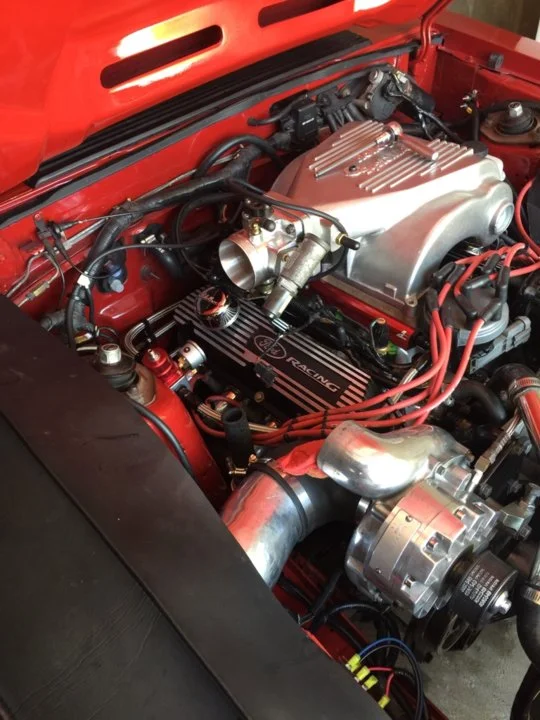

Problem I am having is oil out the breather on the valve cover . Part of me thinks it's just due to the valve cover not having a baffle there . @84Ttop what you think ? I don't remember it doing this before but it's like it's slinging raw oil out on to the valve cover and it's dripping down on to the header . Aggravating so I need to figure that out . Put about 30 miles on it . Car feel torquey I kept it out off boost obviously but was on the expressway doing 65-80 . Other wise so far so good and it's clean .

So I have a plan . Nicks covers are gonna get powder coated but for now - I am gona take the baffle out of the stock Vc and put it in this one for now .

Depending on where the breather hole is located will dictate the need for a baffle. If you have a lot of oil pressure and the vent is over one of the push rod passages it's possible to suck up extra oil. For now, wrap a red shop rag around the breather and rock on!

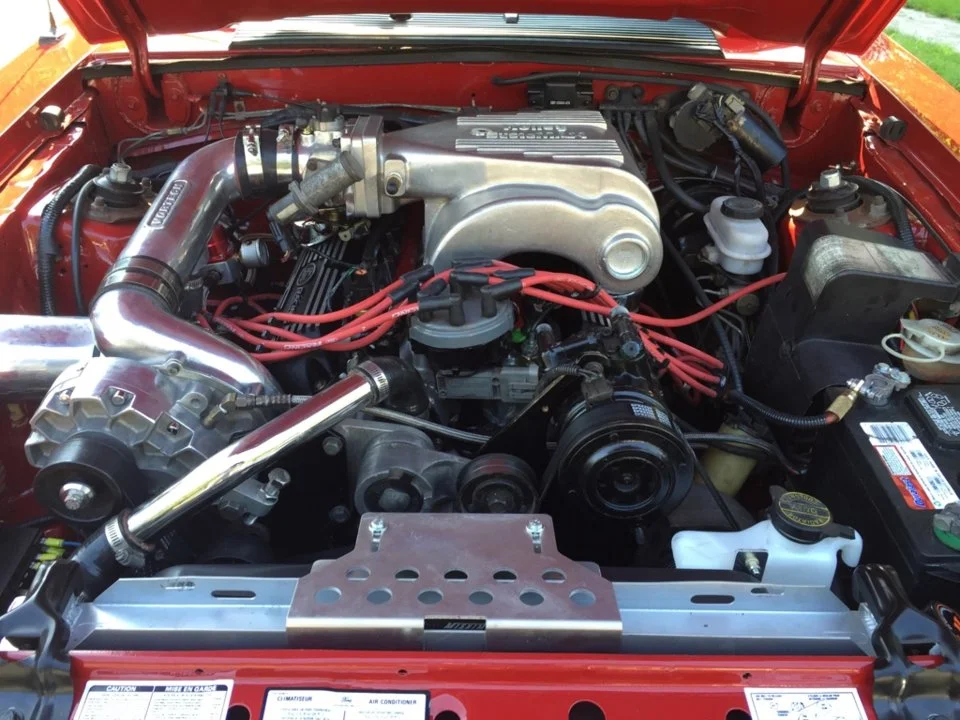

Well I've fixed the oil spilling on to the valve covers . Both sides are now vented so I am not worried about excess pressure . The driver side had to be massaged a lot but you can't tell the left side that can be seen looks awesome . I'm happy now . Afr cruising still 13.8-15.2 mainly in the 14s . So I got some good miles on it
