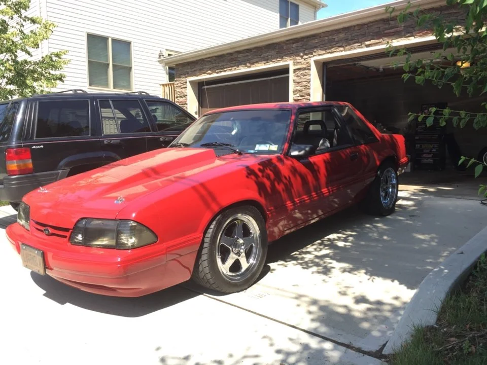

a little update for my peeps . Blower belt is on and adjusted . All the fuel fittings are replaced that were leaking - injector o ring was replaced .
Got my buddies other pressure tester that doesn't bleed down . Re pressured and no leaks so far holding pressure. Marked balancer to set timing . Tightened the blower pulley . Upper intake is back on . Tomorrow I will put discharge pipe on go over it and fire it up and hope to put some temp in it . Maybe a cruise through the neighborhood
View: https://vimeo.com/130996372
Thank you ! Still have some things to do re torque heads change oil possible exhaust leak . But all in all today was successful I did get timing set . Car holds 184-186 idling with the fan on . Took it for a ride around the block . So far so good
