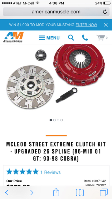

The one before the rst . It's rated for 700ftlbs of torque . Street fighter or something like that
Super street pro? That's what I ran when I switched to the tko. Works well, holds power, though a bit stiffer than the kc it replaced. Was probably too much clutch for my 330HP 302, should be better for your setup.
Nope there's a model after that we used it in my friends 03 cobra I drove to myrtle beach with it and loved it .

I am going to be asking you how you like it in a few months. I will be needing something to handle mo powa as well. I just don't know how much more yet...
It was great behind the pullied cobra I drove to mustang week prob made around 450. We will see how it is in a car with another 130 horse at the tire .

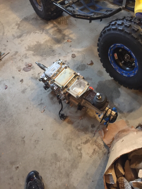

Progress ? Say it isn't so . I forgot how heavy this stupid Tremec is

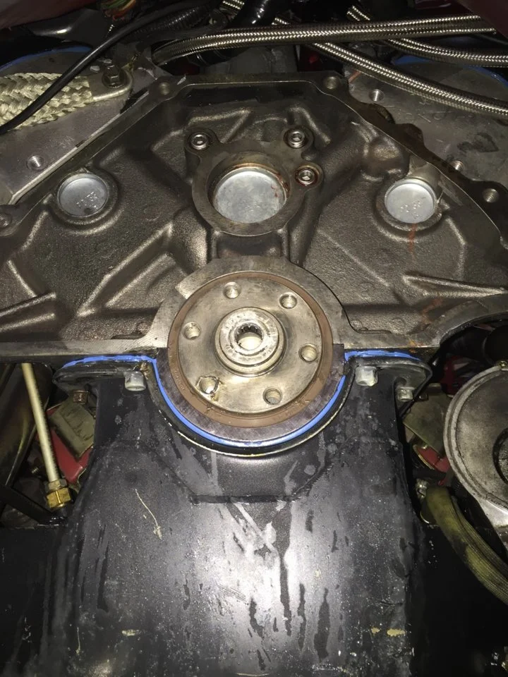

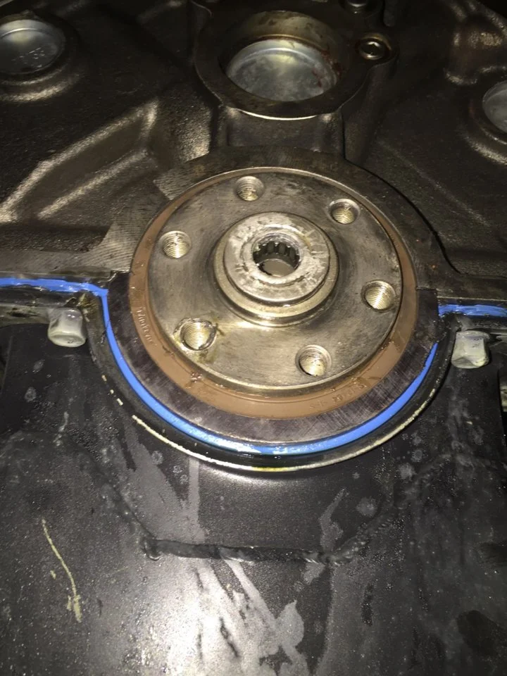

So much moisture in the garage it basically acted as a dye for the leaking oil. Rear main is dry as a bone score . Just the rear pan bolts leaking like a siv . I'm gonna use some Honda bond on them and the half moon around the bottoms of the pan and hopefully that will keep this to a minimum . If it wasn't for getting the flywheel resurfaced it would be back together today .

That's always a good thing to find. Bone dry rear main.
Sent from my Samsung Note 4 using Tapatalk
Never ever in my life has that happened lol

Heck man.. I changed out my rear main seal when i put my rst in because it was leaking. Not leaking as bad now, but still leaking.
Stupid boost.

I sealed it all up it isn't pretty but it won't leak now . In on my way to jersey as we speak to bringing flywheel to my buddy to have it resurfaced while I'm in Georgia this week at lights out

did you put a dab of RTV in the corners when you did the pan gasket? These one piece gaskets will leak without it.. Nice to see the rear main dry.
Yes I did , I'm thinking maybe not enough . Oh well . Lesson learned . Lol
Stupid boost.
Thats why i was expecting to see mine leaking. I guess that catch can is doing its job in venting the crank case pressure
