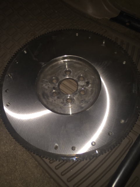

Got this back hope to work on it tomorrow .

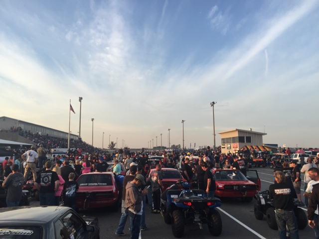

Awesome is understatement . @84Ttop and I with our other friends had a blast . And of course as always nick and the whole group we go with are a class act. It's awesome to have made such good friends . They even brought a cake for my bday Saturday .

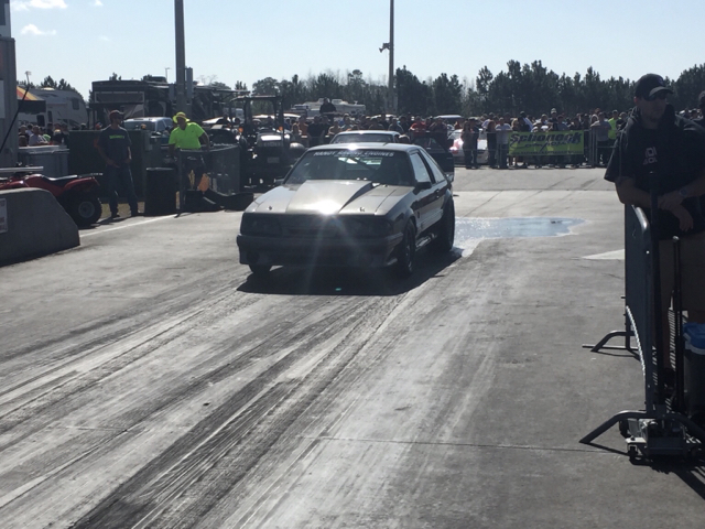

25 at LO7 !!
up on the starting line .
nick deep fried a 15lb turkey !

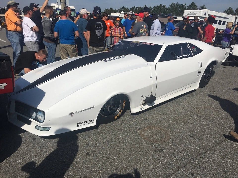

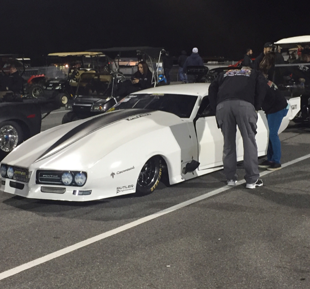

Yeah it was awesome . Our buddy mikes car we crewed on

Picked up an 8 inch crank pulley . Why ? Cuz I'm an idiot and love to make things more complicated . And it has to be retuned with the fast anyway lol
Returned??? What's up with the F.A.S.T system?
It needs to be tuned with it so we figured while it's getting tuned might as well make more boost . If I can ever get the TRANS back in . Fought me 3 diff times I had enough for today try again during the week
