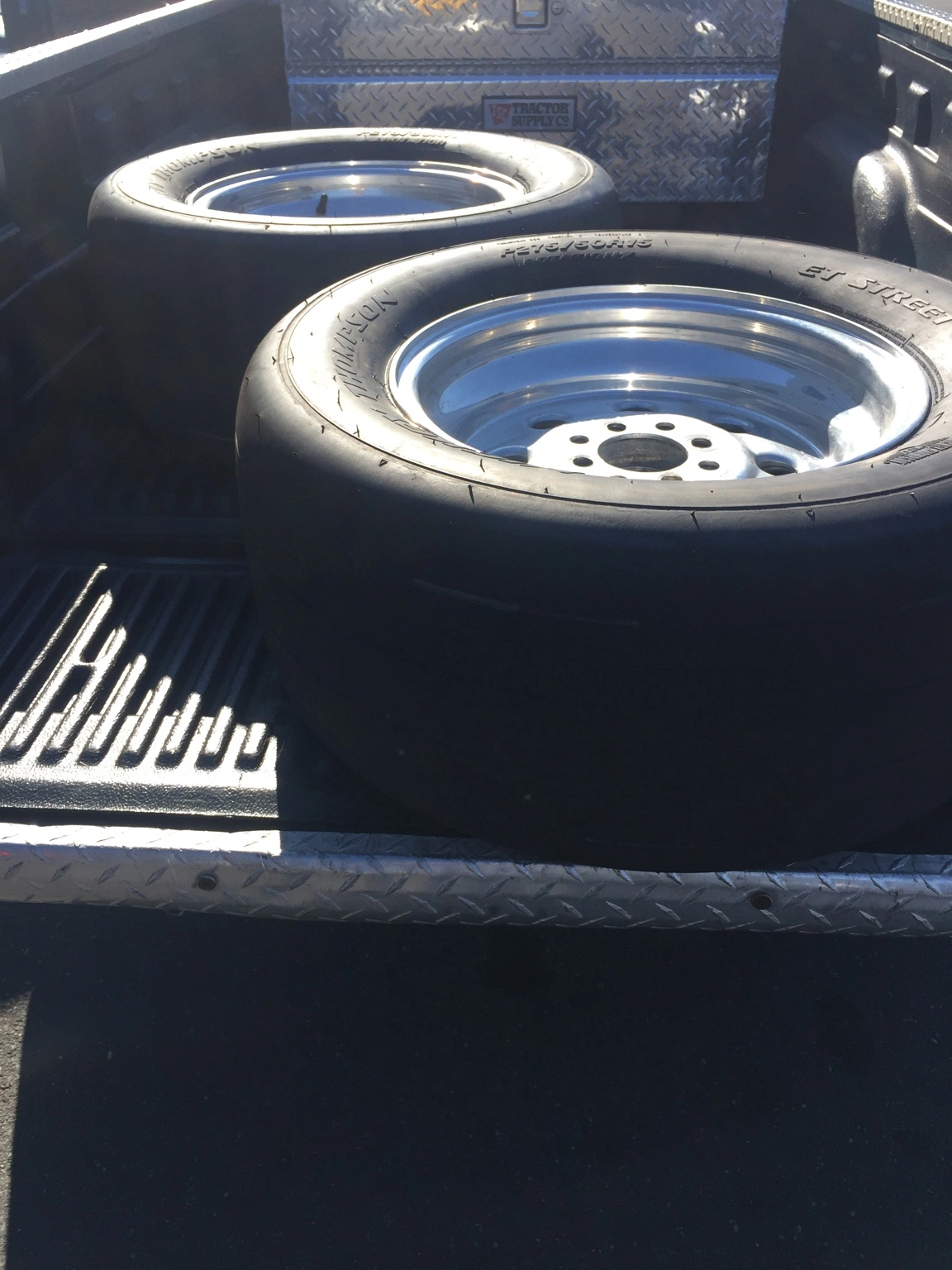

All that for nothing. try again next week. We had 20-30 min of rain for raceway to decide to call it at 2 pm . Rain was gone at 230. Track doesn't open the gates until 430 and start running until 5. Either way the air was crap humidity sky high.
