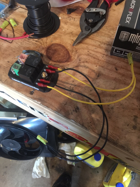

What is the relay board doing for the fans? @TOOLOW91
Makes it so the current isn't running through the fan controller . Eventually this winter when I put my fast xfi in I'm deleting the fan controller and the ecu will control it .
Reactions: stangboy
What fan controller are you using? I think you said the fans don't draw very many amps at start up and continuous run. Based on that I wired my Contour fans straight through my FAL controller that has a 60% power up and slowly ramps up to 100%. FAL says their controllers can handle up to a 40amp start up draw. I thought I'd throw this out there for @stangboy as an option. The FAL also turns the fans on for 30 seconds after you turn the ignition off. If the FAL controller didn't have the "soft start" I would've ran a relay to help with the sudden surge of power being drawn.
Reactions: stangboy
The Flexalite controller for the BM extreme 185 . And I did the relays for if and when the ac makes it back on the car to also add a condenser fan the wiring is there .
I have a Mark VIII fan and it has a pretty hefty amp draw at startup. i just have a large inline fuse right now but I'd rather use a relay.
Reactions: FoxMustangLvr
Definitley need a heavy duty relay with that fan . They are known to burn :poo: up without them

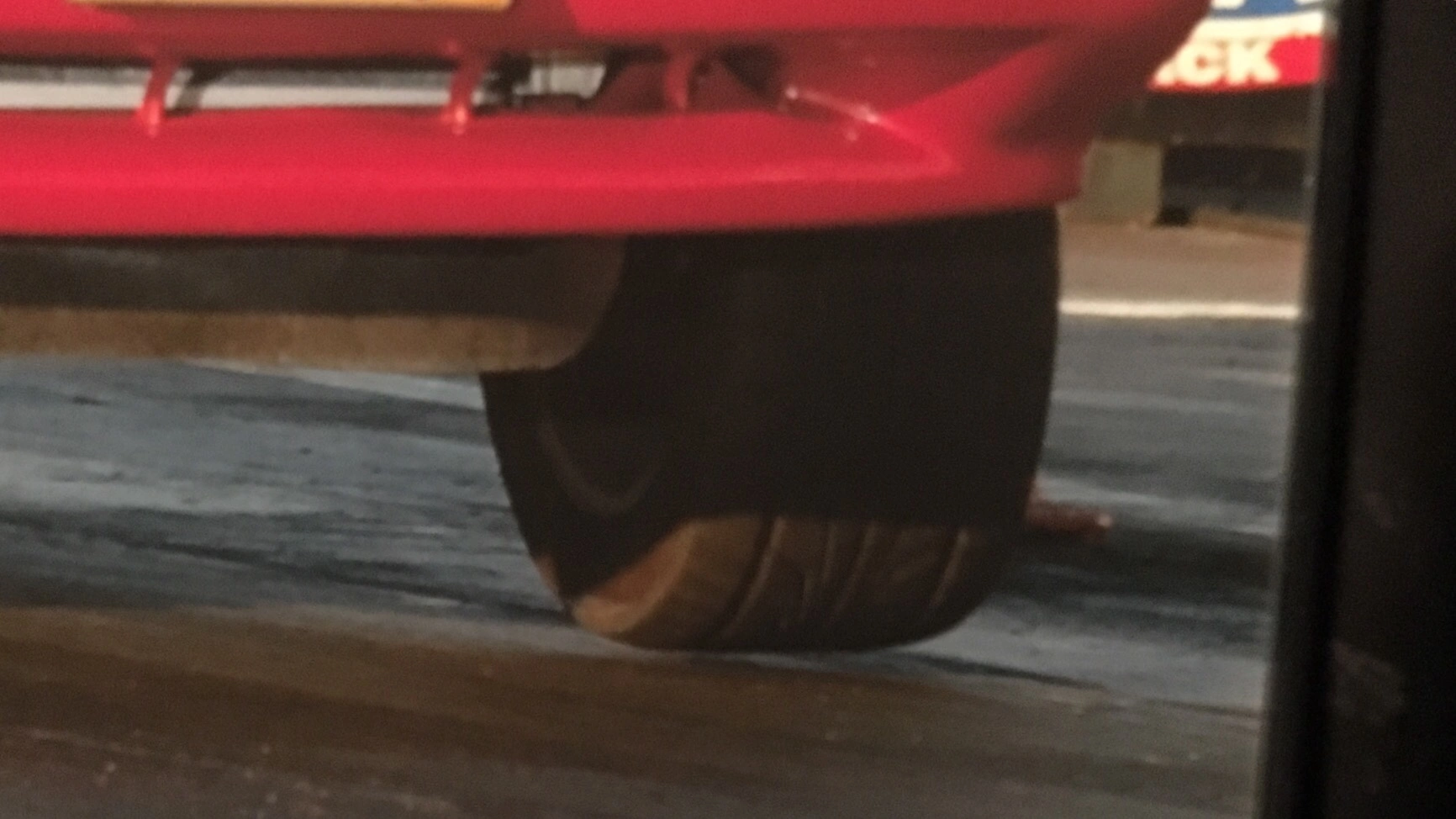

Go to launch making a solo pass and let it go right around 6800 ish I would guess . Felt like it just hooked and was gone . I felt it pull the tire a hair . Shifted the :poo: out of it . Hit the stripe and literally f u c kin screamed cuz I knew I did it . Got the slip and went nuts .
