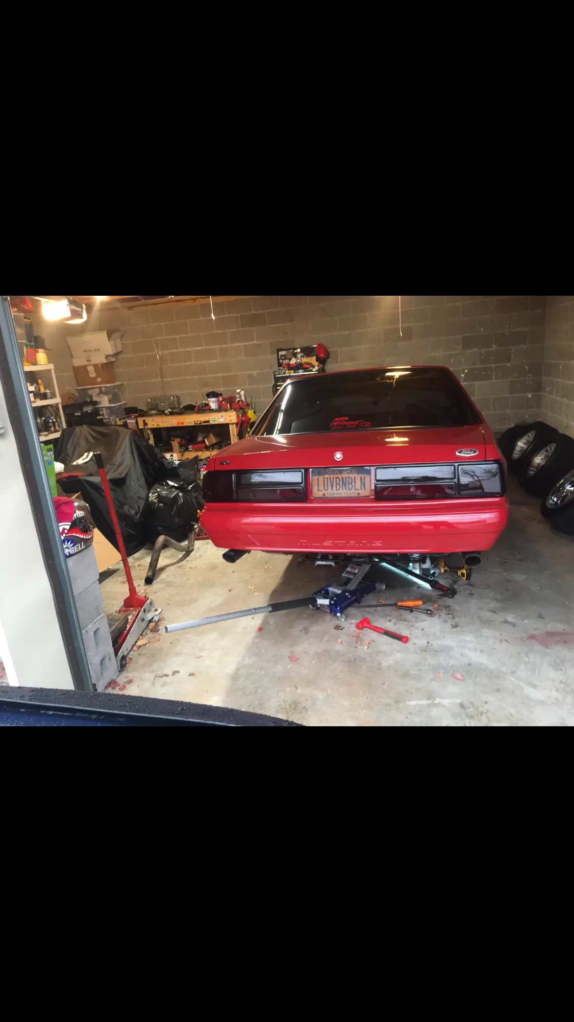

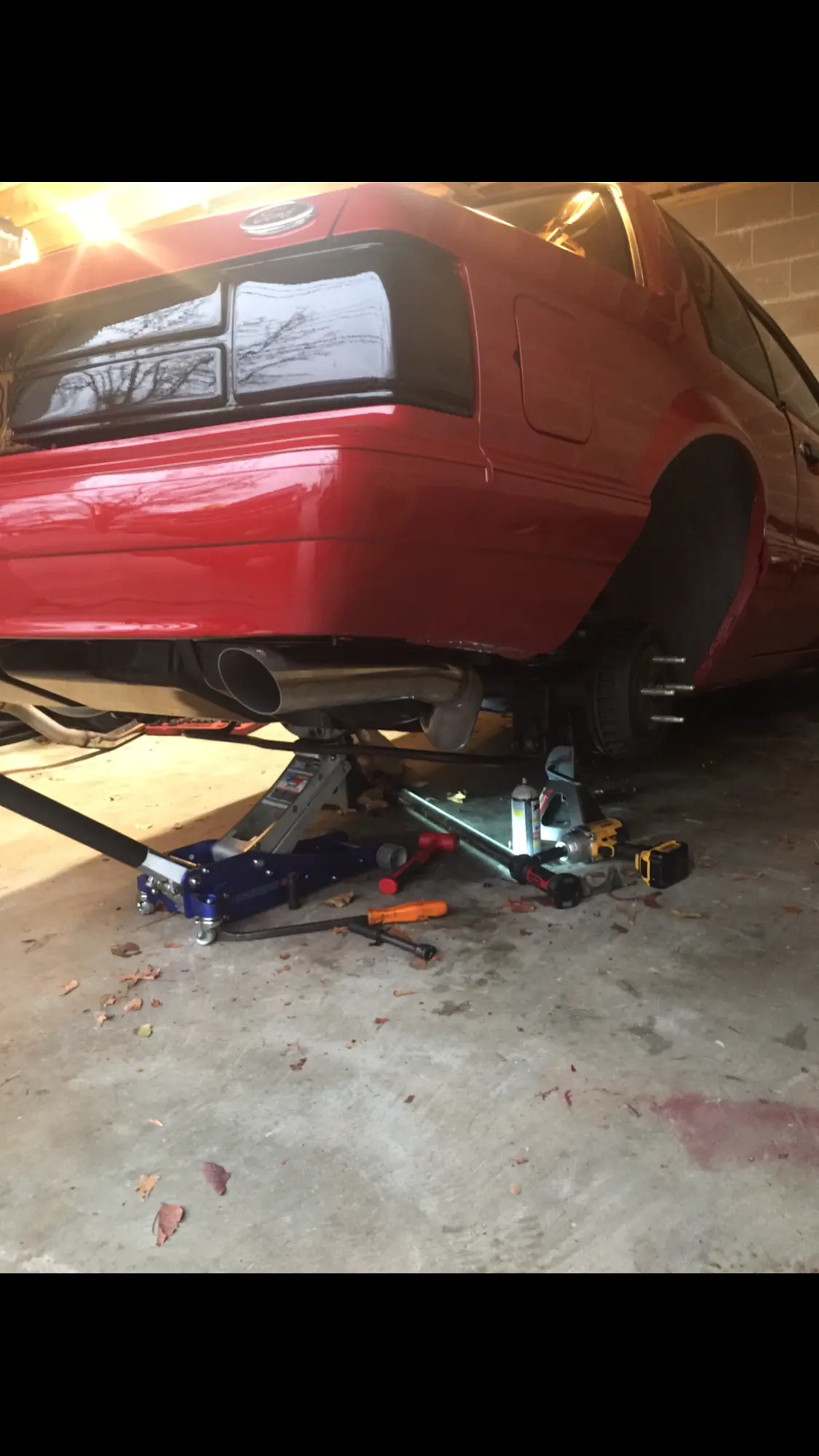

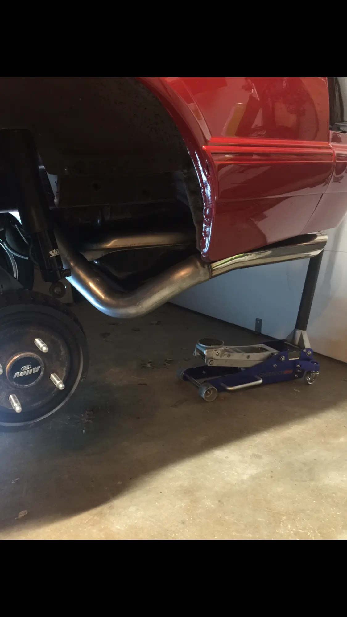

These tail pipes are driving me up a wall honestly. The 3 inch pipe with having a 2.5 inch muffler is making it a pain in my ass. The pipe of course will slide over the muffler outlet but clamped to it i dont believe will be tight enough to seal. Using adapters even cut down makes it impossible to get the pipe into place on the muffler because it pushes it way to far back.
Im waiting on clamps and stuff from summit that will be here tomorrow night and then i can do more . Until then they just sit mocked in place slid over the outlet of the muffler.

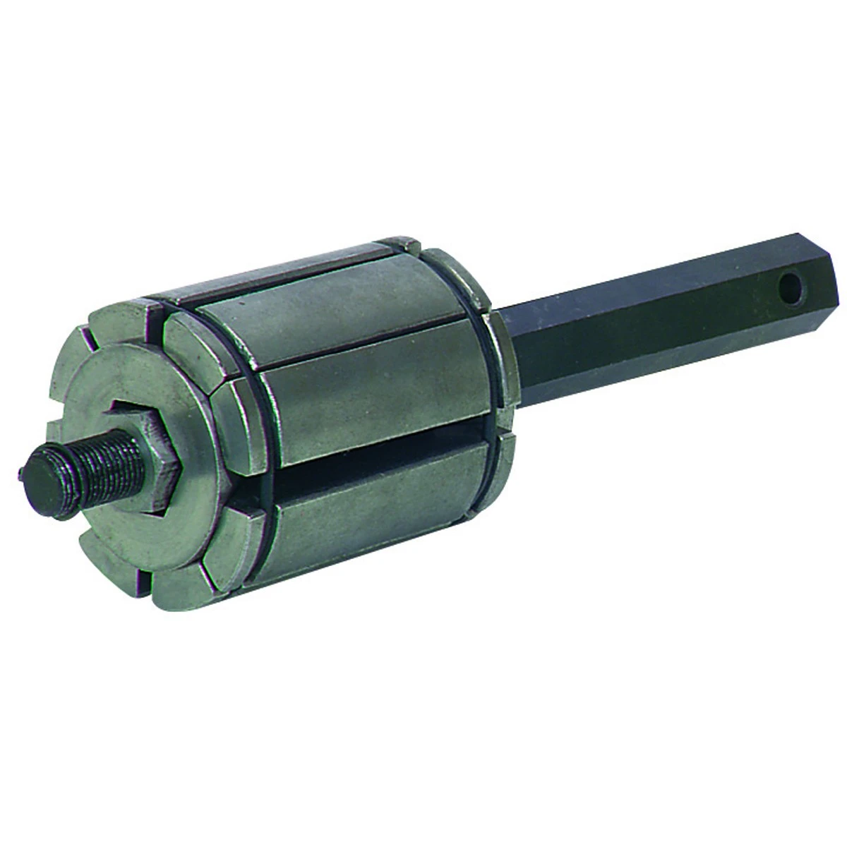

This'll fix it :-)
