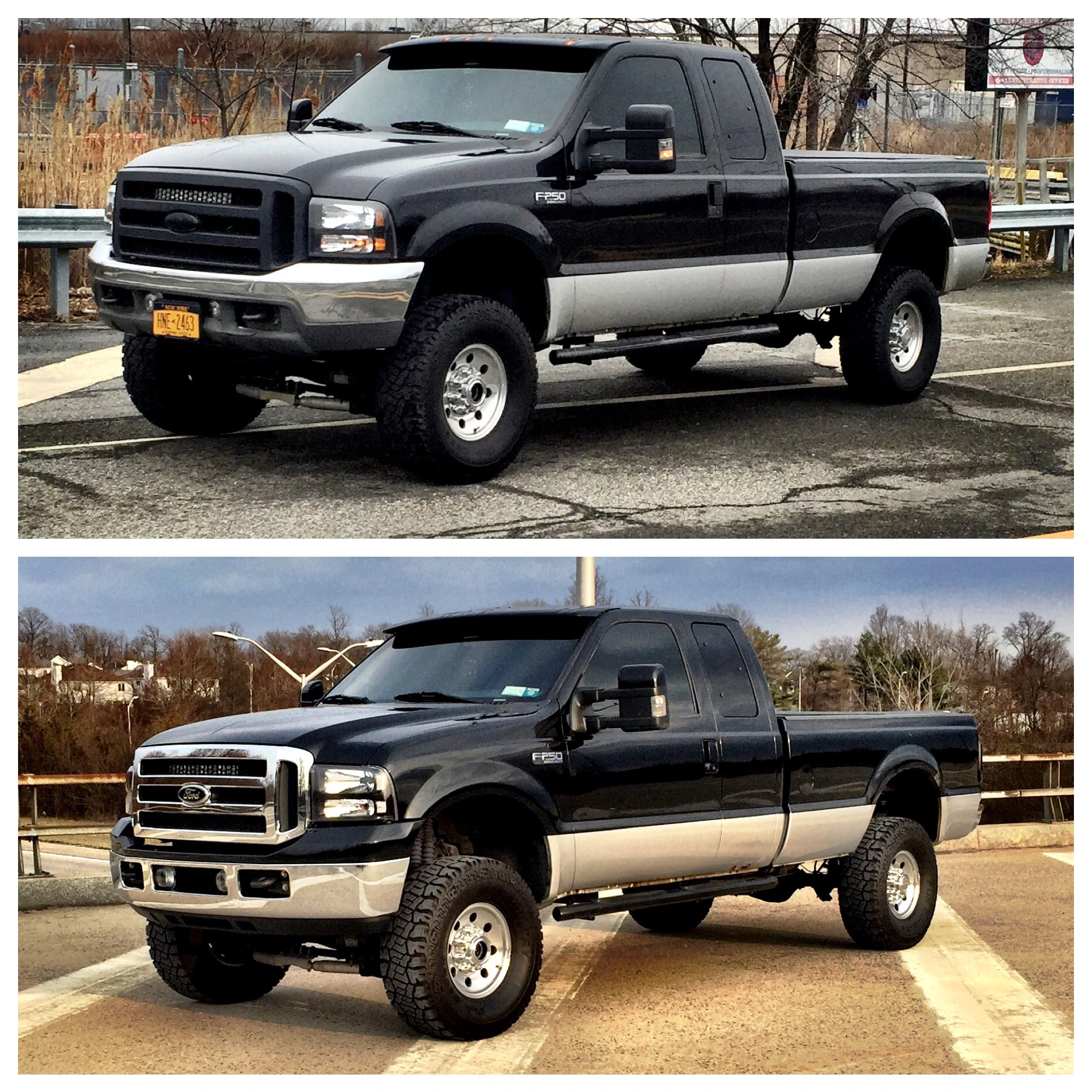

Last night after work I put my friends motor trans and transfer case back in his Mitsubishi Evo that I have been helping him with . So today I took the night off . Did the 05-07 front end conversion on my truck and got the mustang all finished up .
Whats different Jeff the Bumper?...
It already had the Harley truck headlights when i got it and the 6.0 grille . Swapped the headlights out for the ones with the clear reflectors .
Swapped the grille out for chrome and the 6.0 bumper .
This is what it would have looked like stock
Ok i see it now i changed my Grille i like that bumper tho alot...My headlights are stock new but stock.
The header panel needs to be trimmed for the lights other wise they bolt in. The bumper wasnt too bad . You need the filler, bumper, main brackets, side support brackets, foglight brackets, And the filler gets painted body color. I got the whole bumper with everything together on ebay for 550 to my door.
Then i had the filler painted along with the mirror caps, Door handles (Mine were textured black, And oem fender flares which i need to still install.

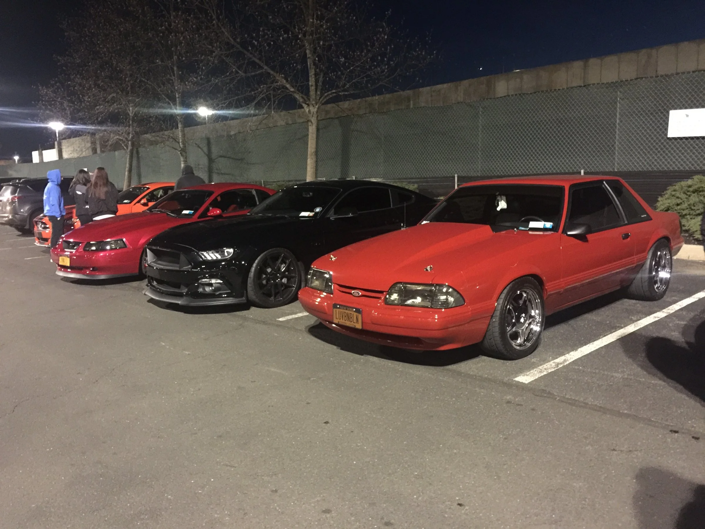

So last night was about 55 degrees before the sun dipped in. We broke the cars out after having rain that washed all the salt away . I can't thank @Mustang5L5 enough for answering all my questions with these brakes. I don't know why I waited so long . This car stops better then I ever could have imagined.
The new Mickey Thompson et street s/s is a killer street tire too .
