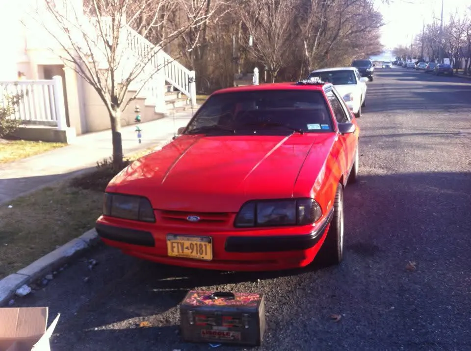

With that popping red paint I like how the side moldings set off the car..but either way it looks great.Also throw some black 5.0 emblems on it..that would look tough!
whats making me so on the fence about it is that it looks great with the bright red but with the red candy color it will be a lot darker and metallic and i almost feel like the side moldings are gonna clash and be lost with black where as in body color it will flow but again still undecided lol
Just a thought if thats the factory color i would keep it the same I think the bright red looks awesome and its rare on a notch...but if you go with the darker shade yes it will look better painting the belt mouldings..either way you cant loose!
here's the deal with the red as I like it it was a respray a bad
one at that and is way to orange red then dark red , I've seen the color I want with my jams and you can't tell unless ur up close but well see lol once the 5 speed

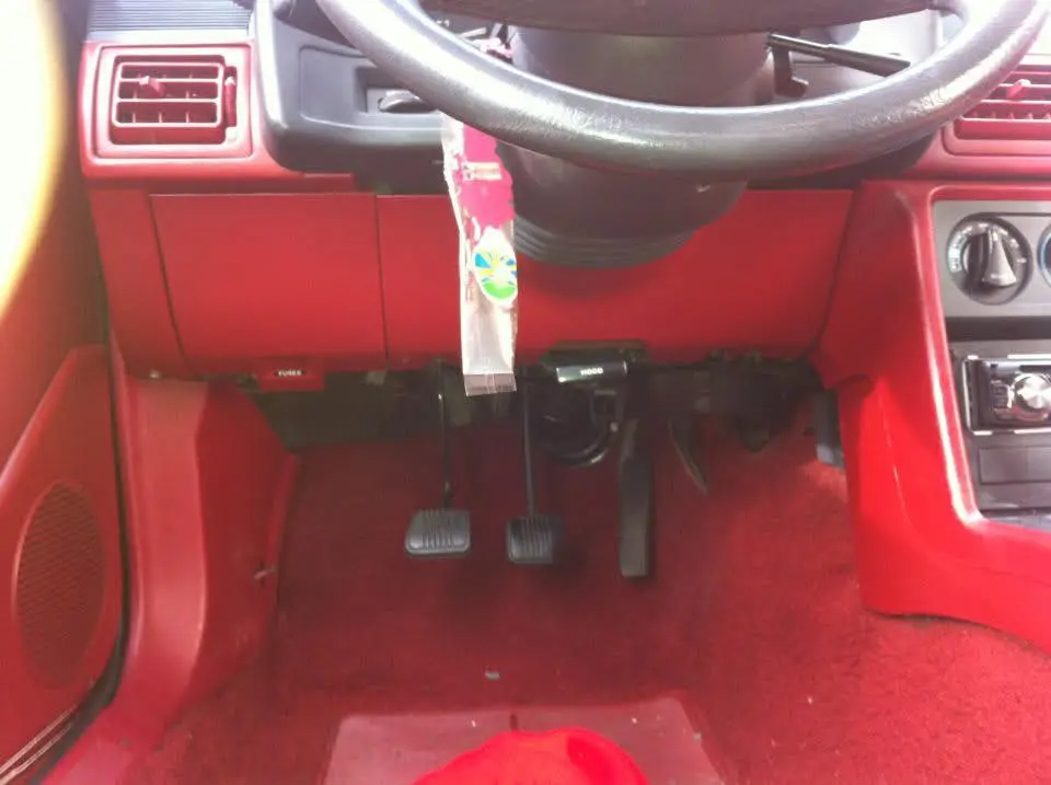

so my smoked headlight kit is in and i moved the speedo cable over to the correct hole for the stick swap. also set the mm quadrant up on my pedals.. possibly tomorrow i may install my pedals into the car and set the cable in and hide it under my dash for now and once i get the trans sorted out ill be ready to go.
