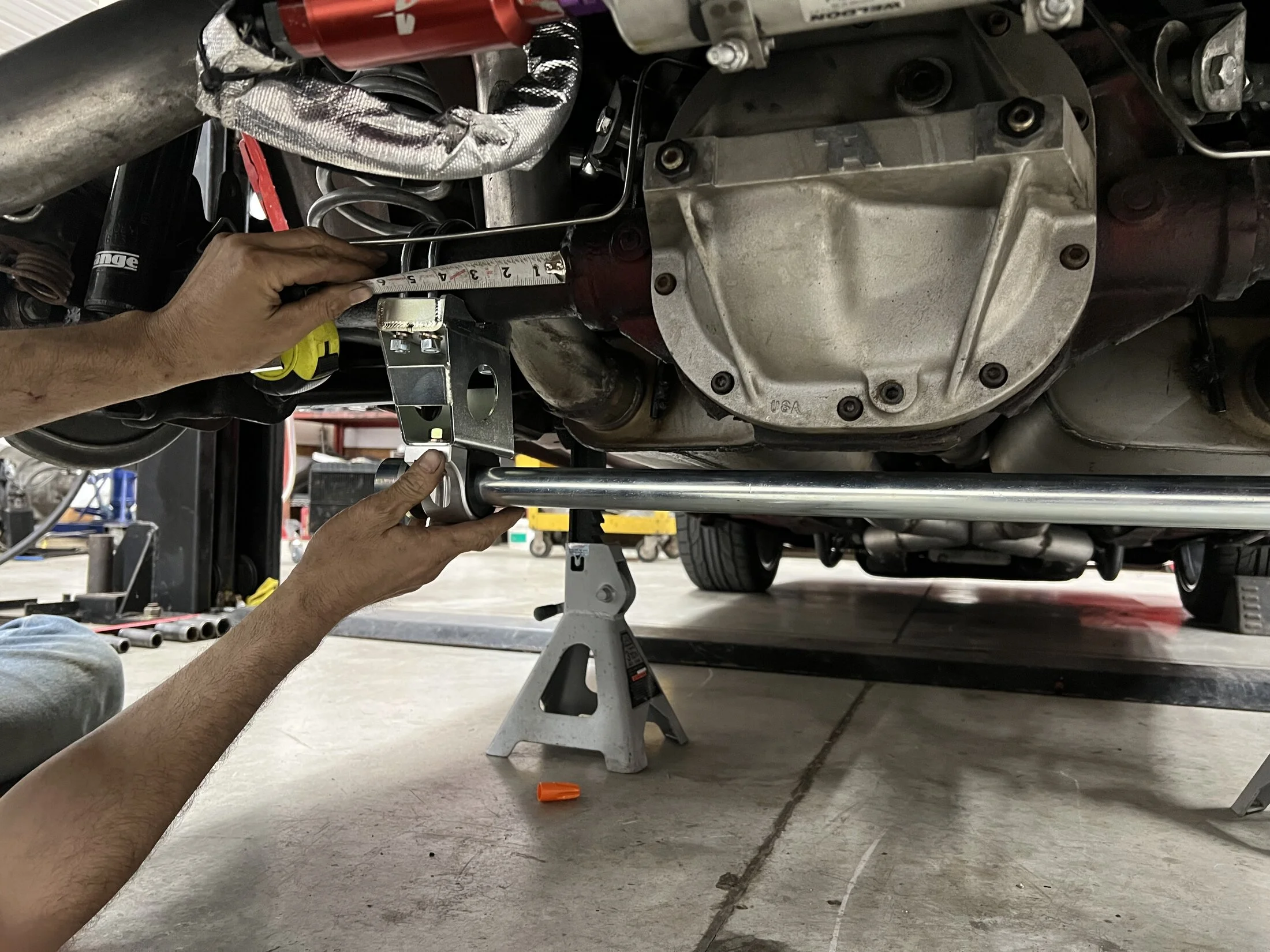

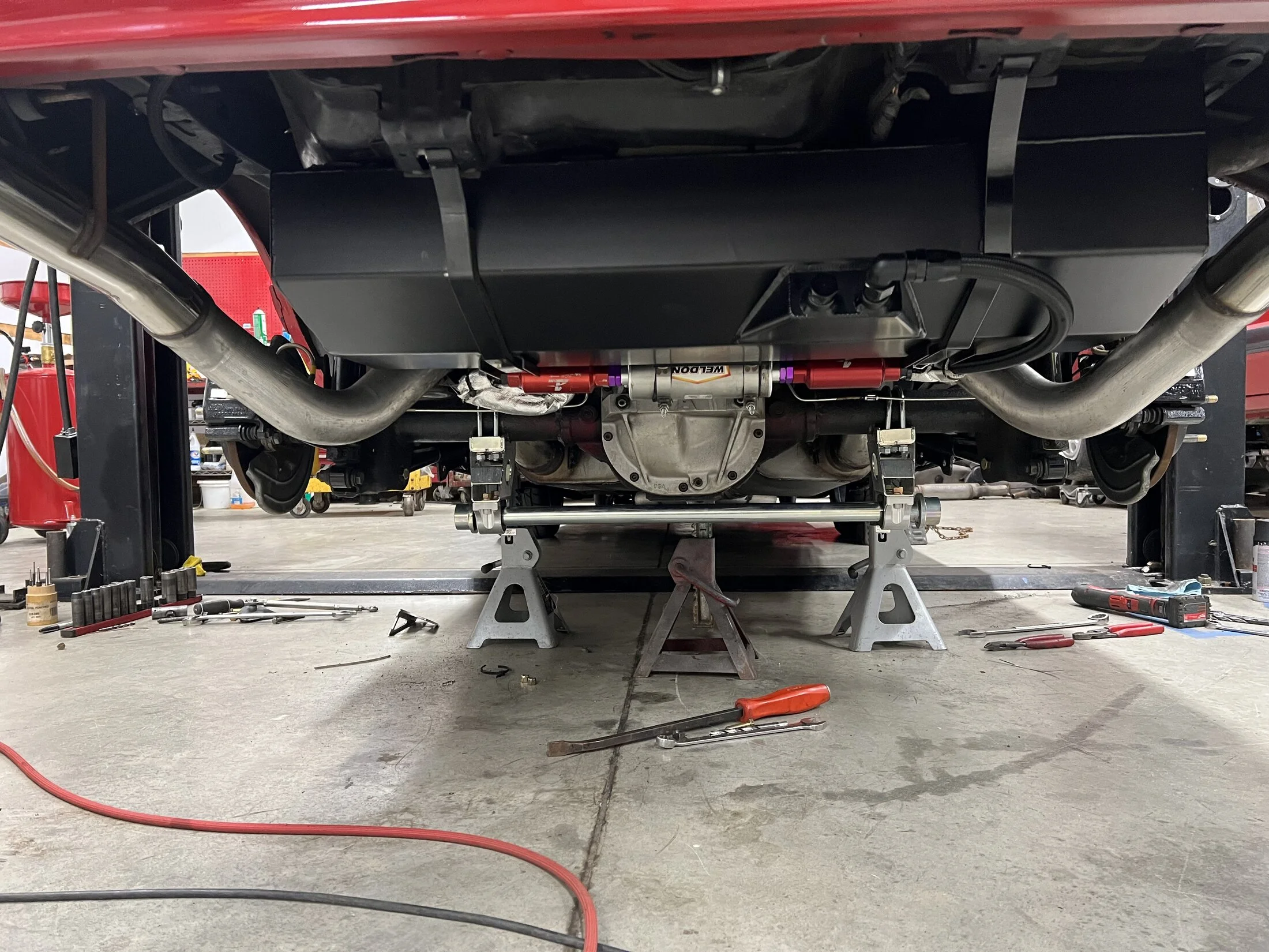

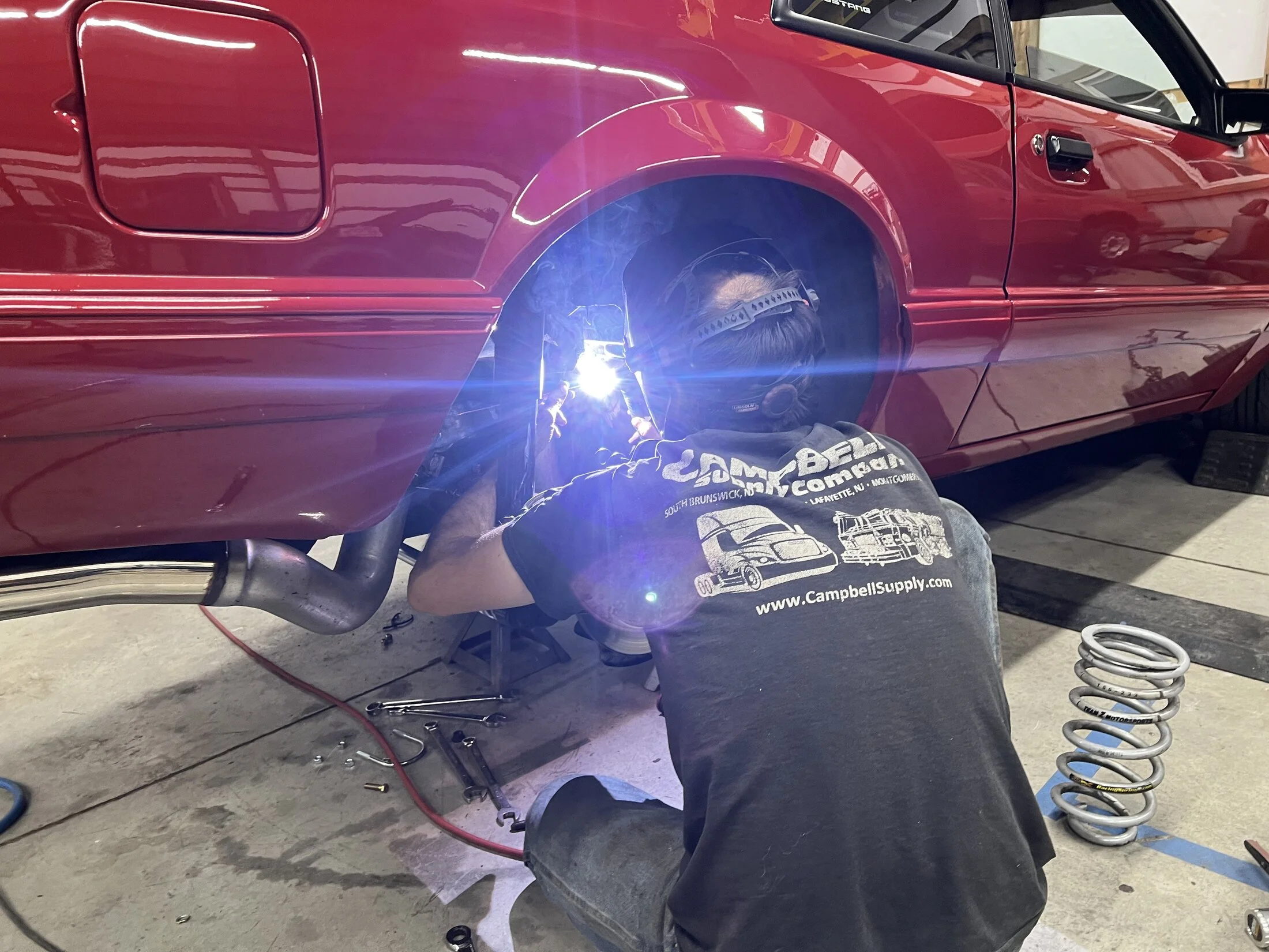

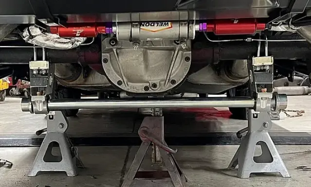

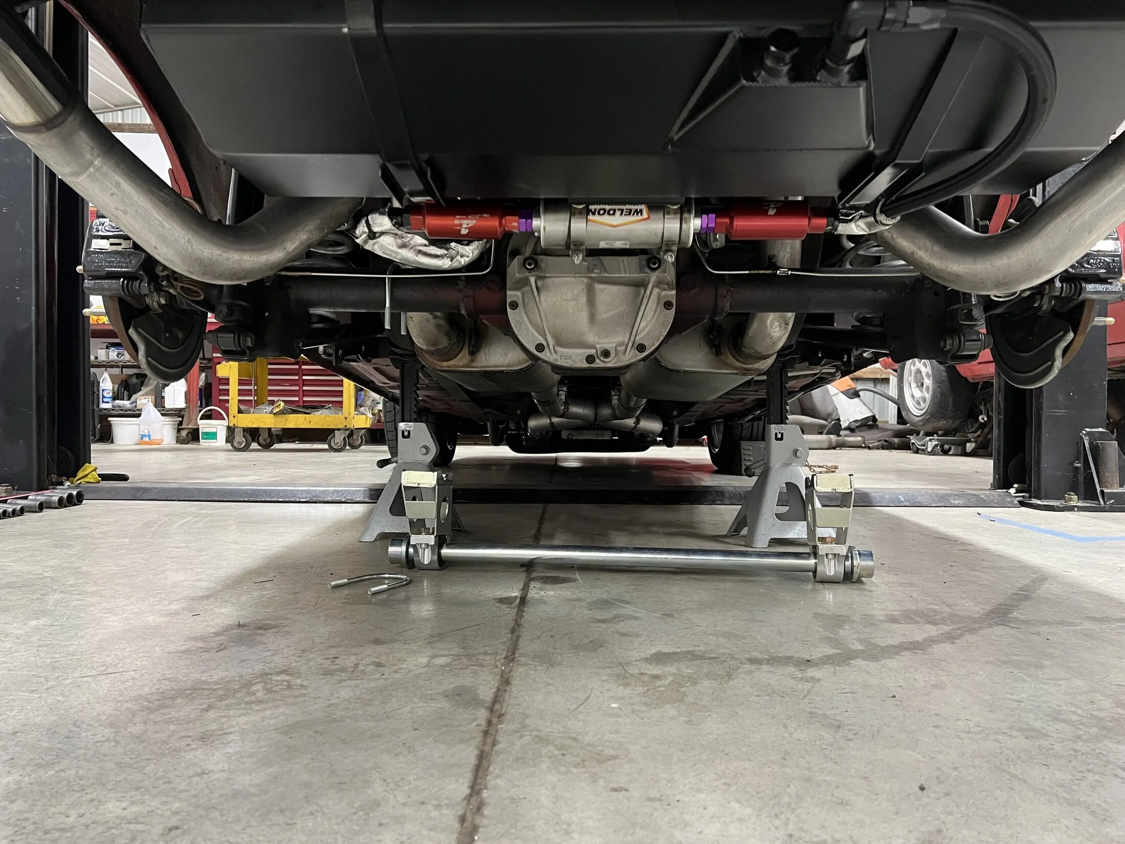

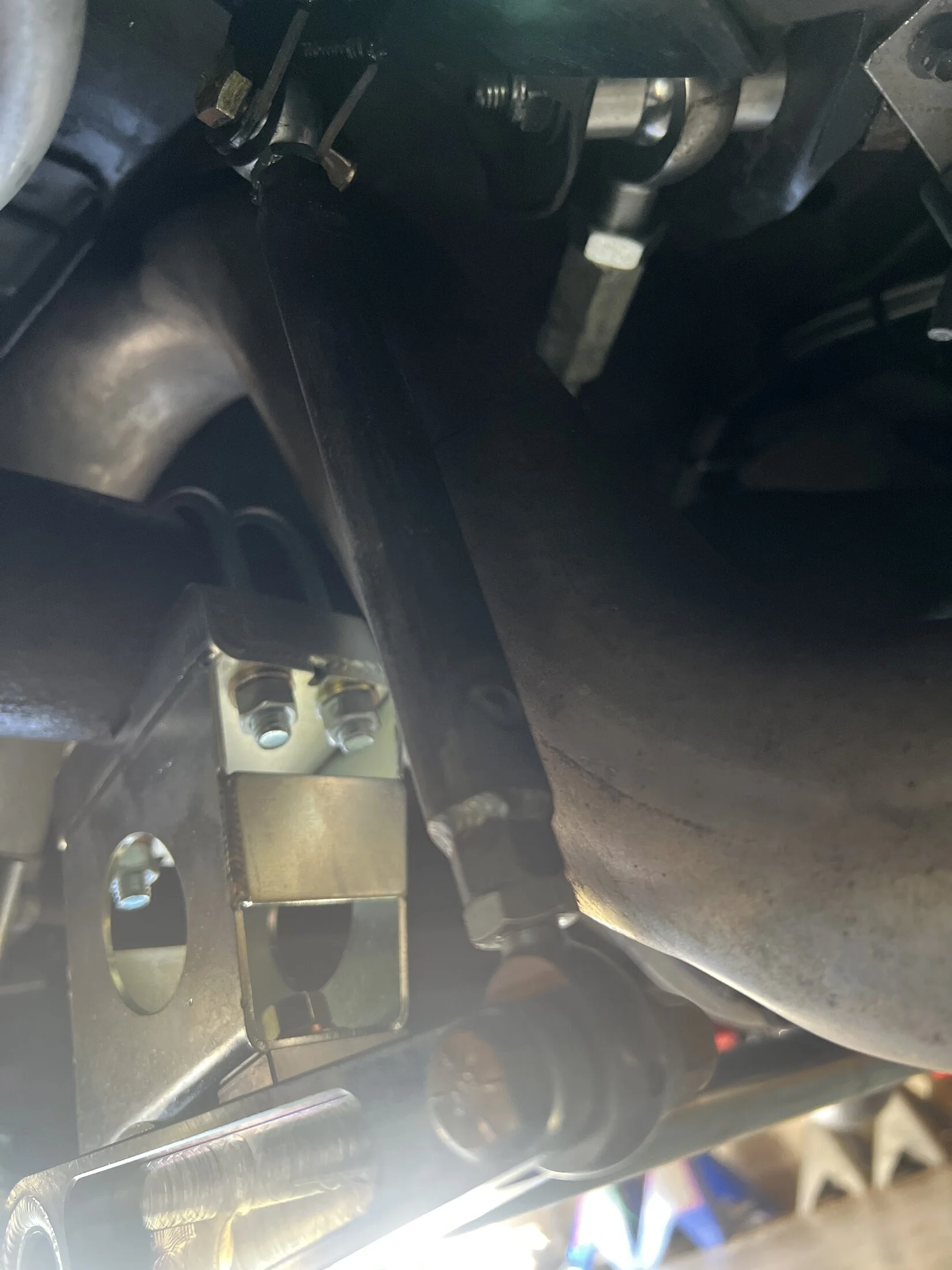

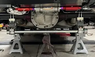

200 miles round trip to my buddies up in Sparta . We have always done the chassis work on my car ourselves since day 1
He’s got a 2jz in a 85 coupe .
We got the anti roll in ! We had to move it around a bit and flip brackets around becaus of my full 3 inch exhaust . We had to remake the links for it to get it parallel but it’s all in
The car drives amazing honestly . Not like an anti roll bar on a drag car where it must be disconnected . This is definitely a street type bar

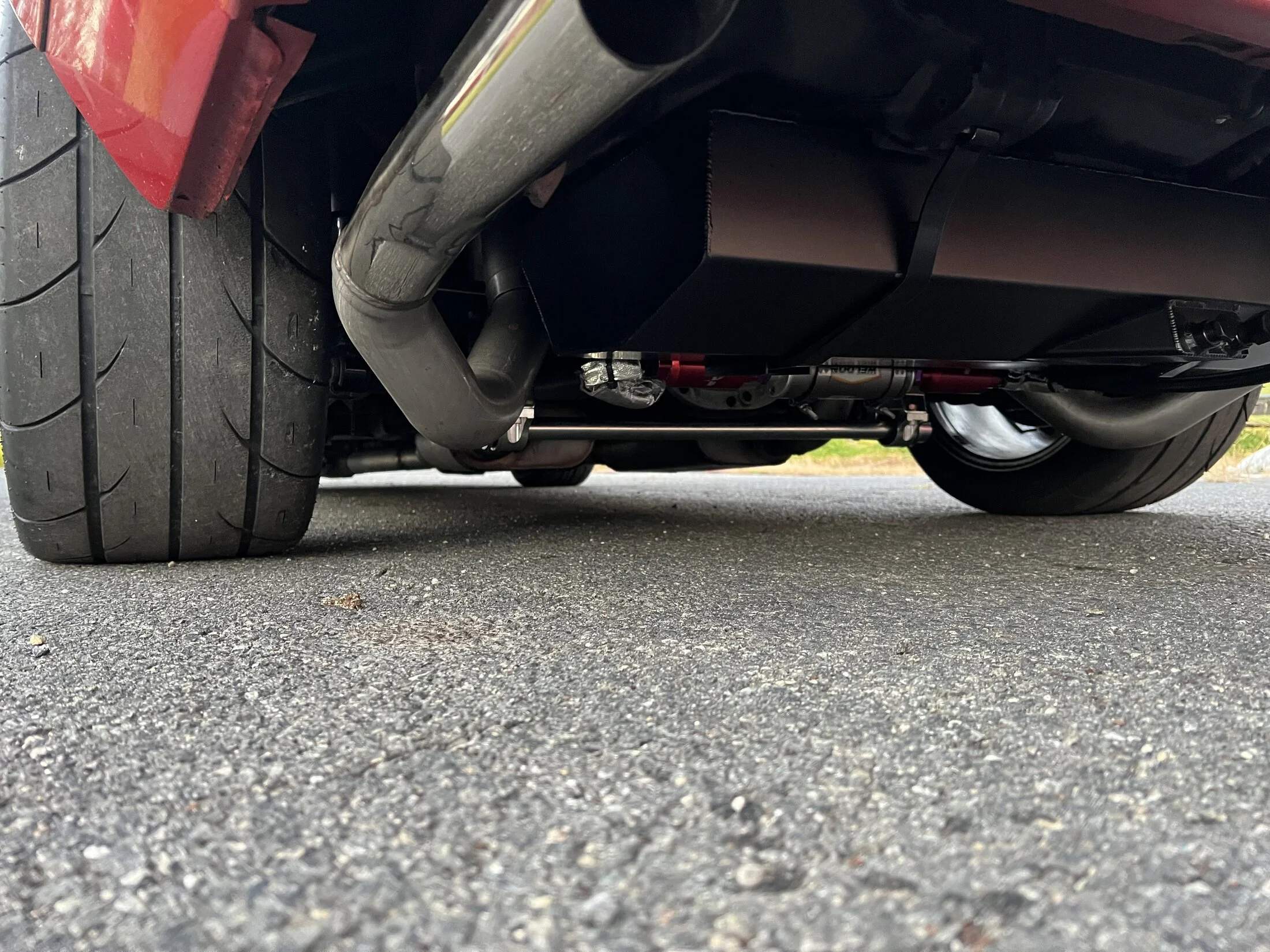

How doe sit work? I mean... What is it attached to aside from the axle?
Reactions: Noobz347

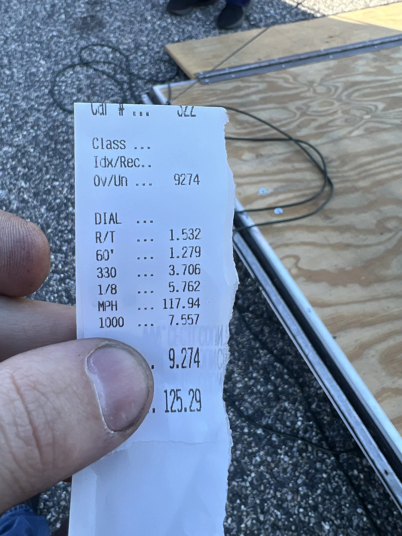

Yesterday was a great day - if I didn’t over tighten that blower belt that had no more give we’d be looking at an 8 Second slip on a super conservative timing and boost setup for c16 . The belt is similar to an rpm gates where it just has no give and explodes and this did just that right at 1000 feet.
22 psi on the shift 19 on the run ish , only 17.8 degrees of timing .
All this on a 26x8.5 because I had them at my finger tips and needed new tires .
Last pass was botched up they had me too far back in the water and the burnout was a bust . Then I was frazzled I didn’t put my foot on the brake going up on the trans brake becaus aod t brakes react slow it pushed through . So it red lit. Let go of the button it spun . I lifted it rolled forward and I stabbed it off idle at 5 mph . That still netted me 148 out the back and I lost my upper windshield trim .
