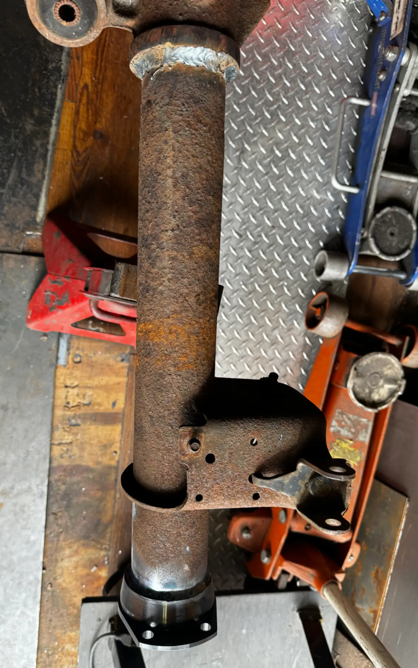

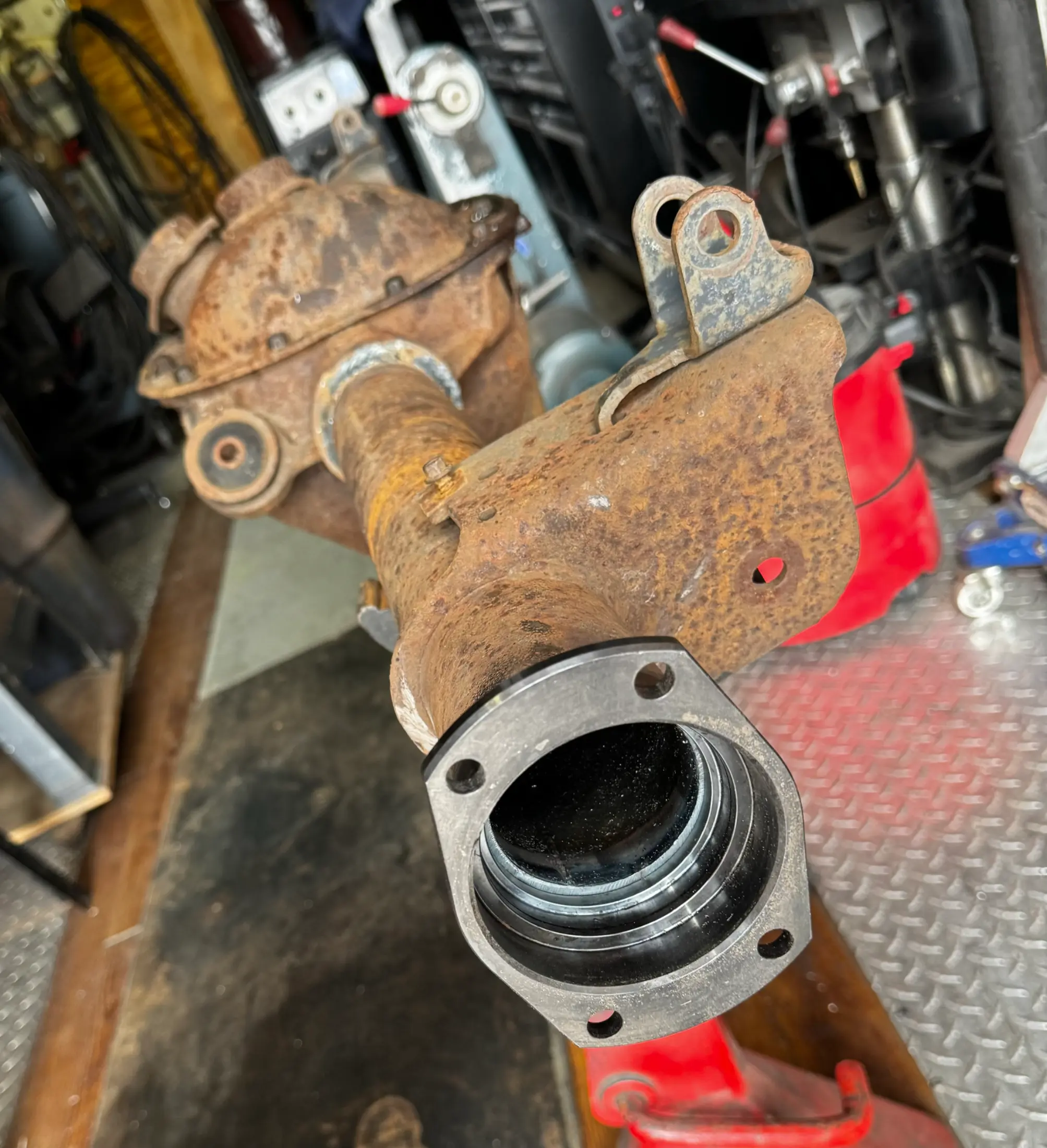

Rdub6 said:
Love it! Rebuilding my 8.8 was probably the most enjoyable/satisfying part of my Fox journey so far. Looking forward to watching this one come together!!

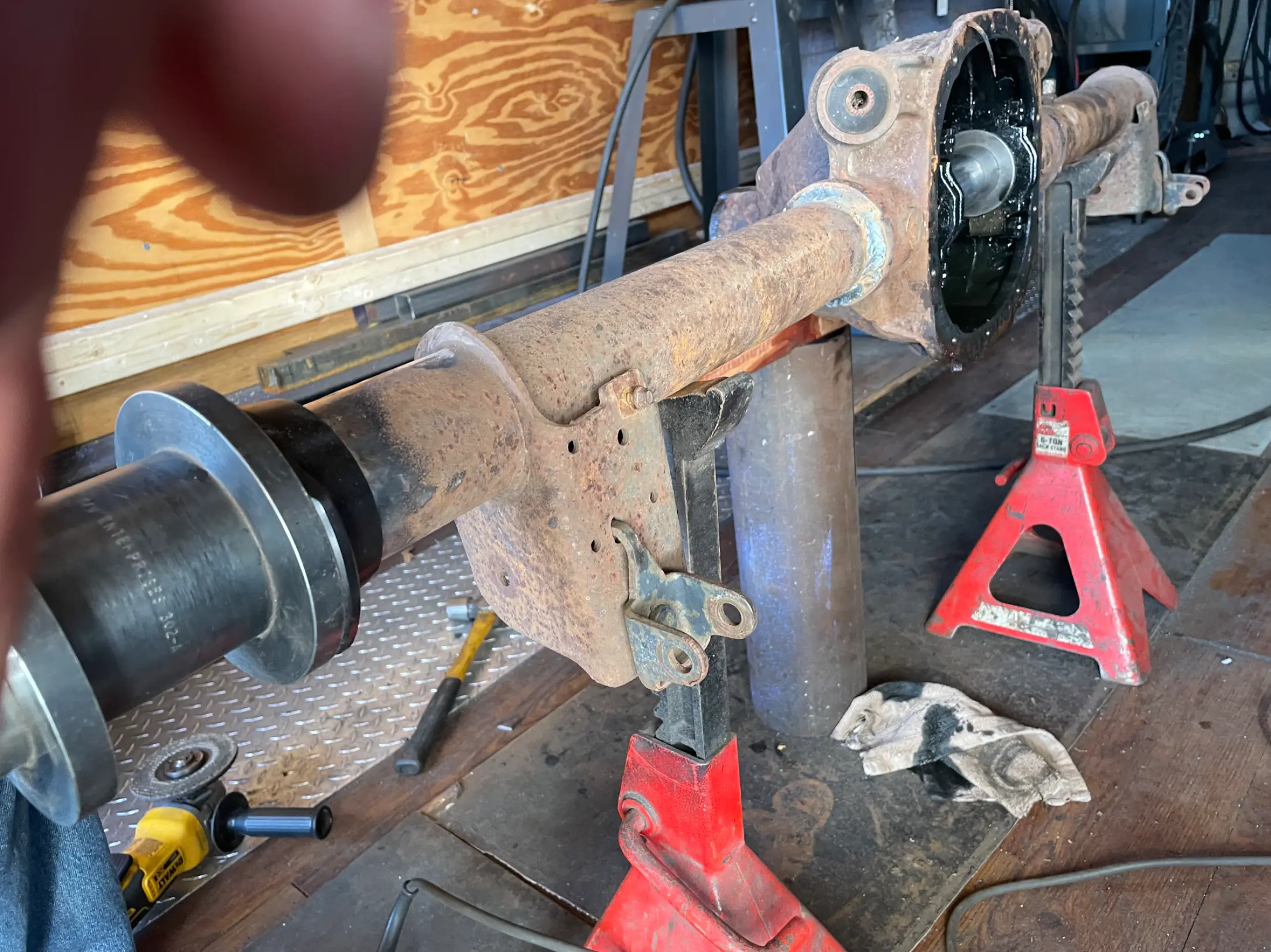

My original that’s in the car I did 12 years ago
Only thing I did about 3 years in was throw a brand new 31 spline carrier in it and later on moser 5 lug axles.
On the original build I welded the Axle tubes. The rear has been sub 1.2x 60s and seen a lot of abuse and been a rock.

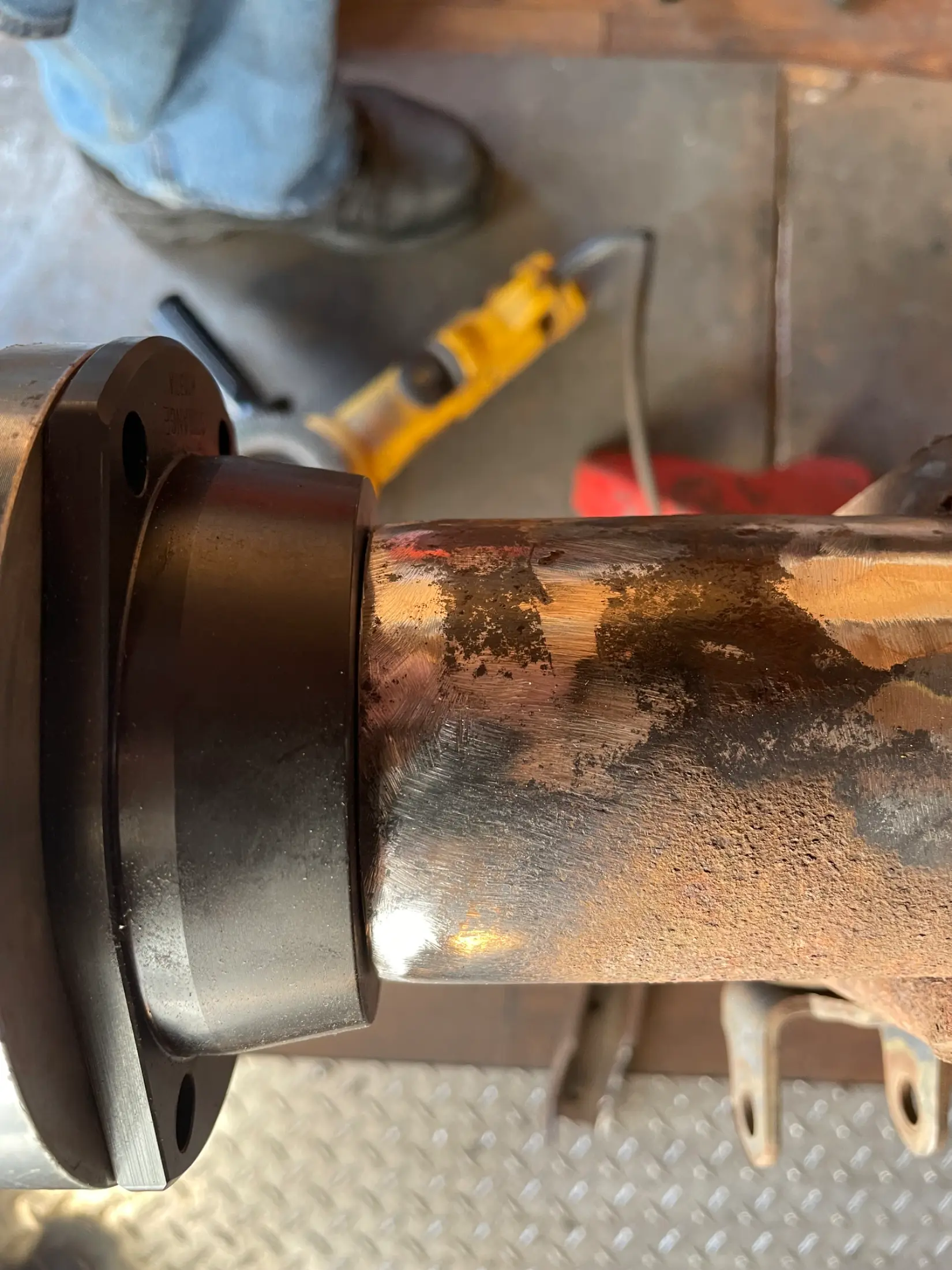

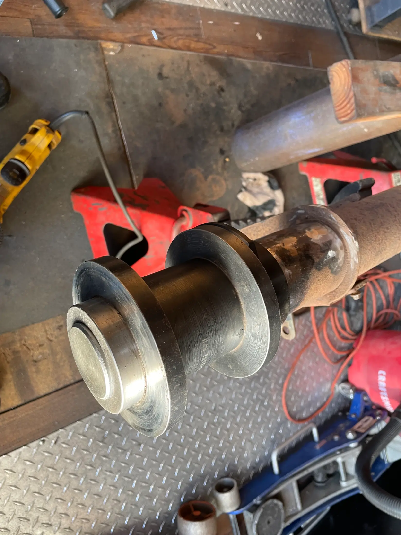

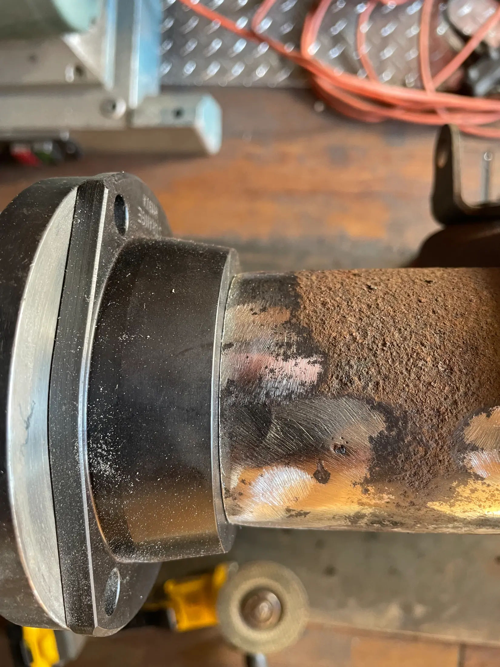

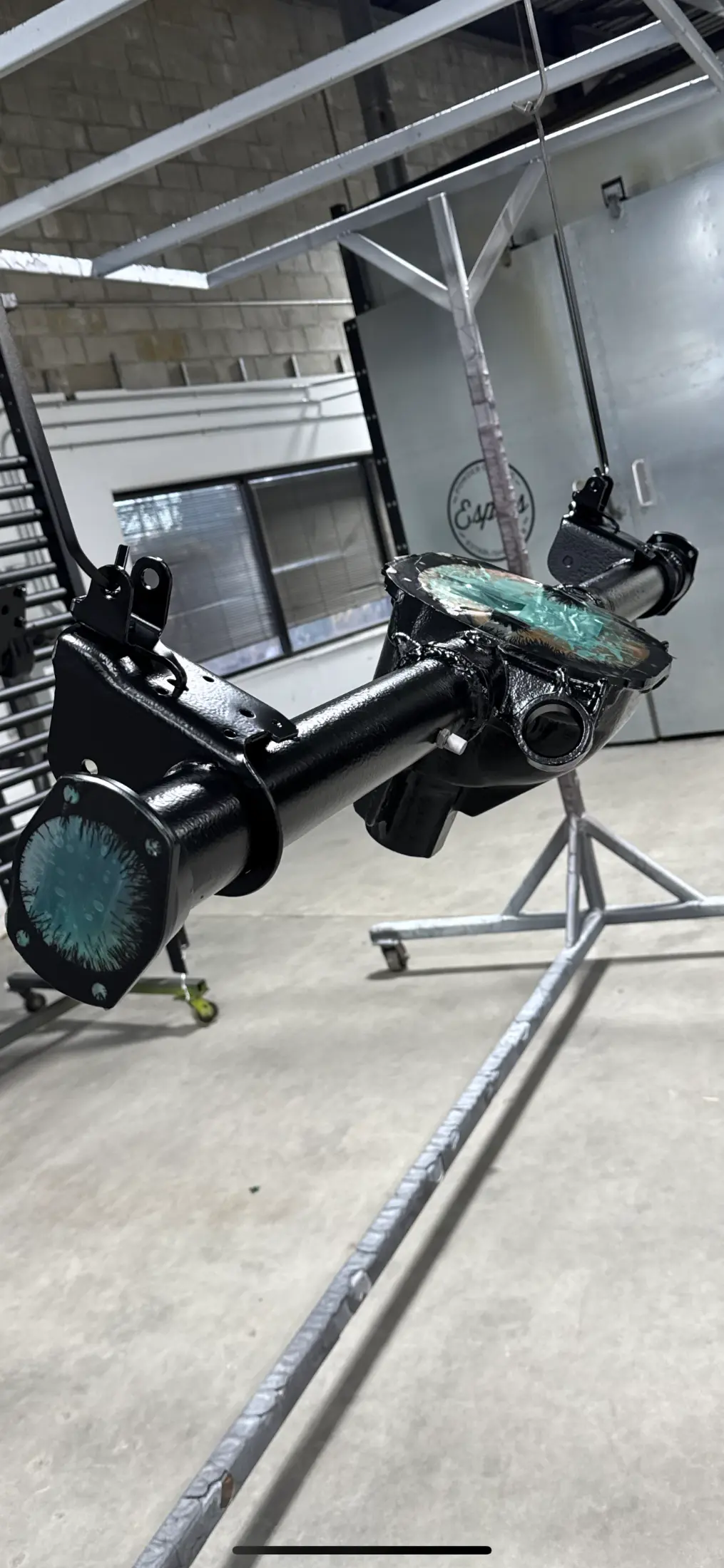

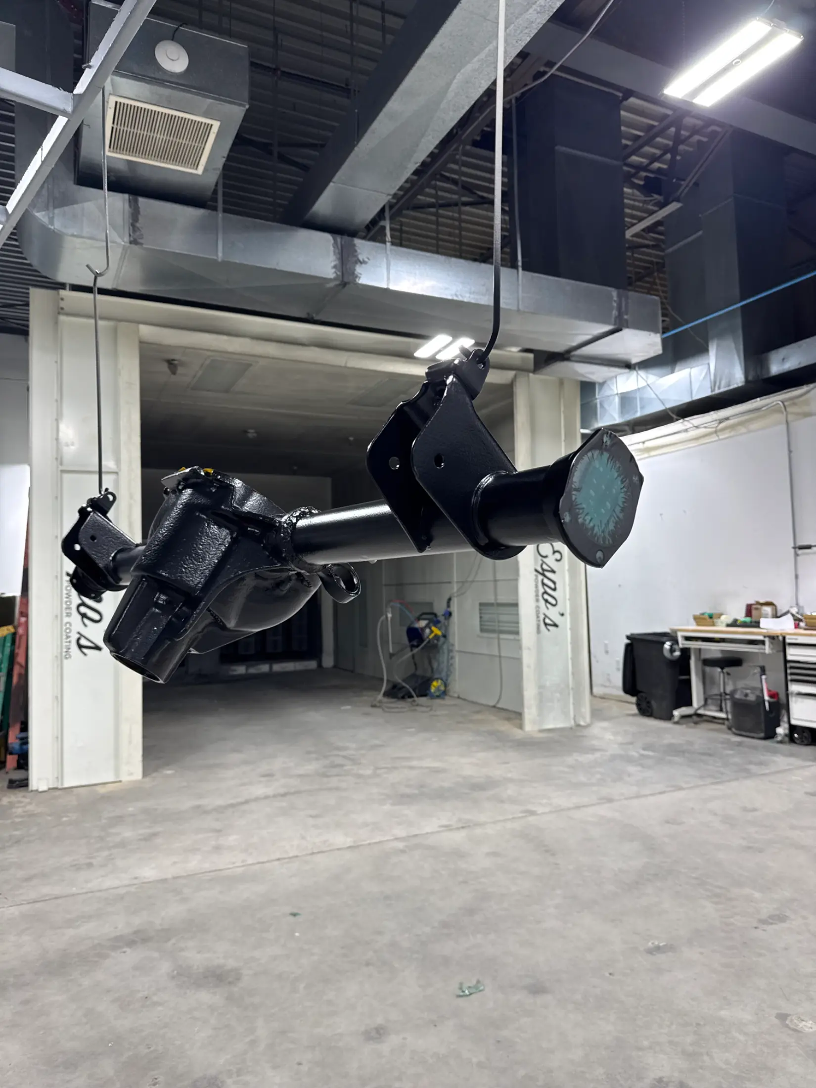

Next up is sand blast and powder coat

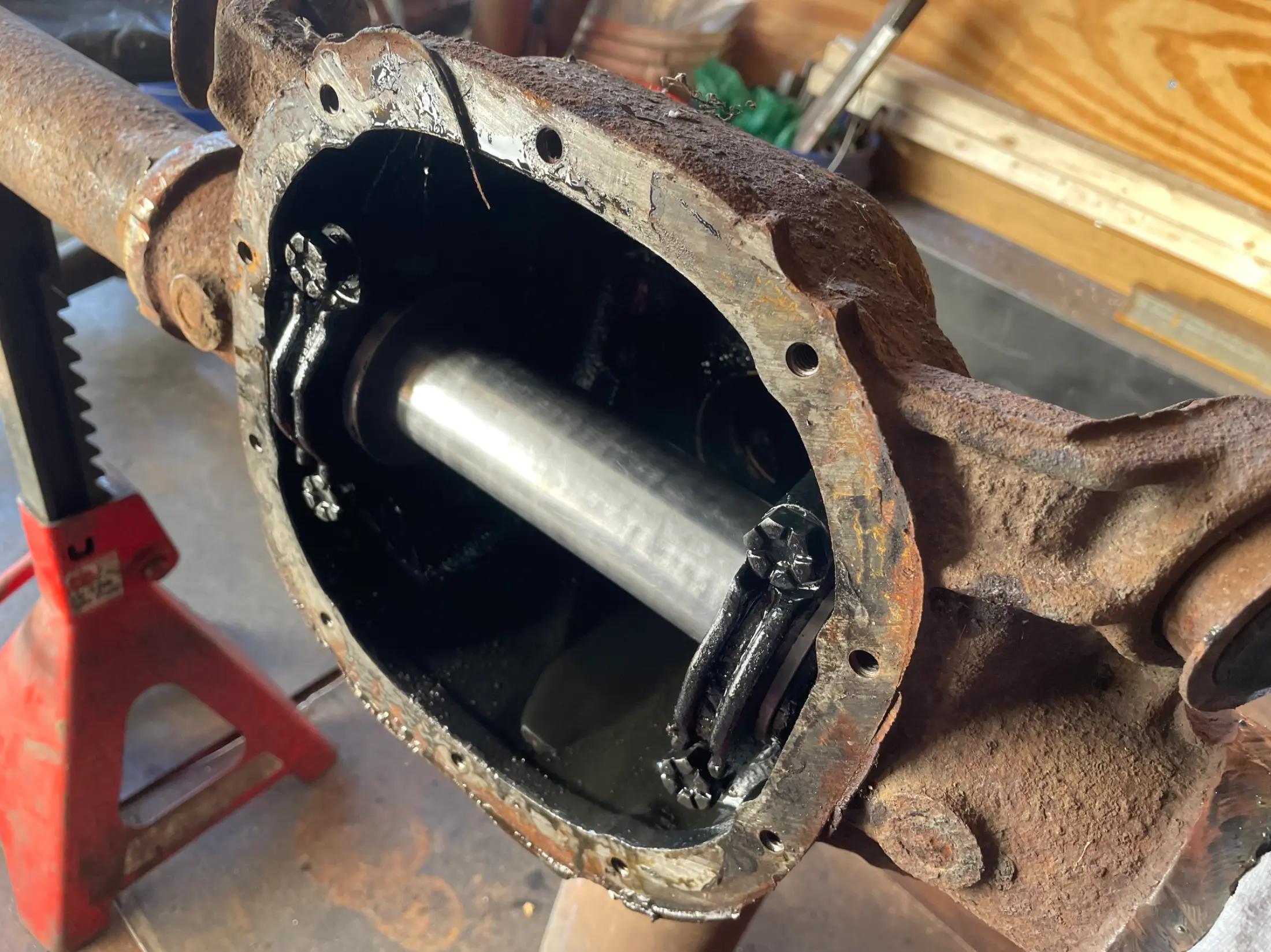

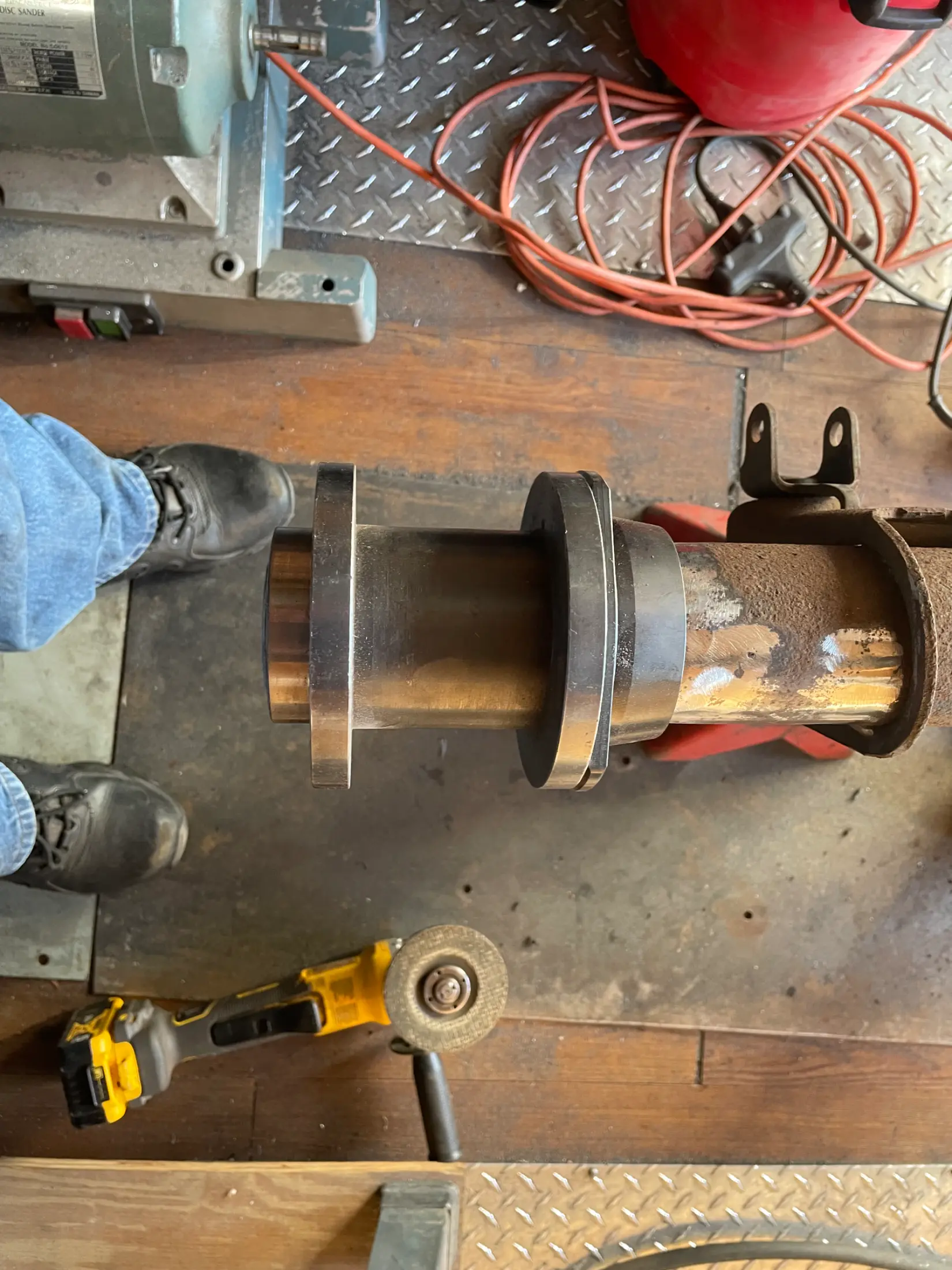

Some more progress pics he sent me , also sent a nice video showing the bar end goes right in and out of the axle end.

Is that some fresh powder coat???

Nice looking shop
Yes

limp said:
Nice looking shop
Yeah he does amazing work .
Started out in his garage with a toaster oven
This is his 3rd shop

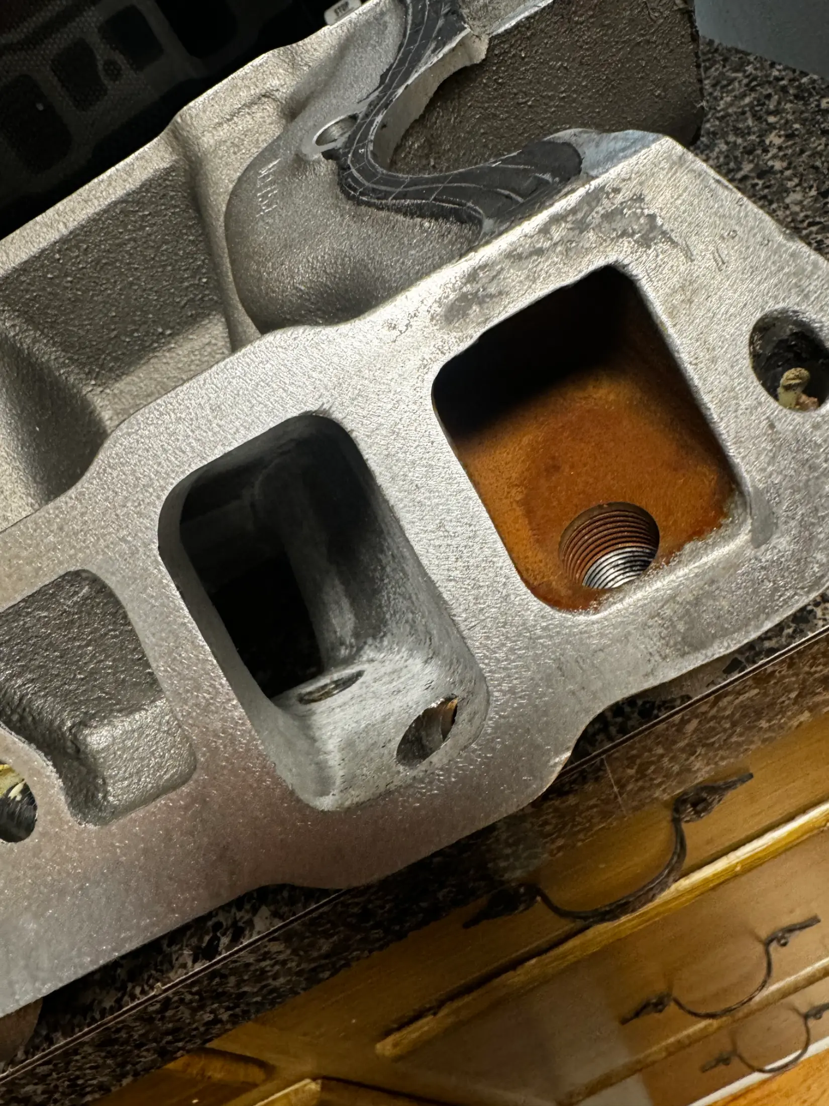

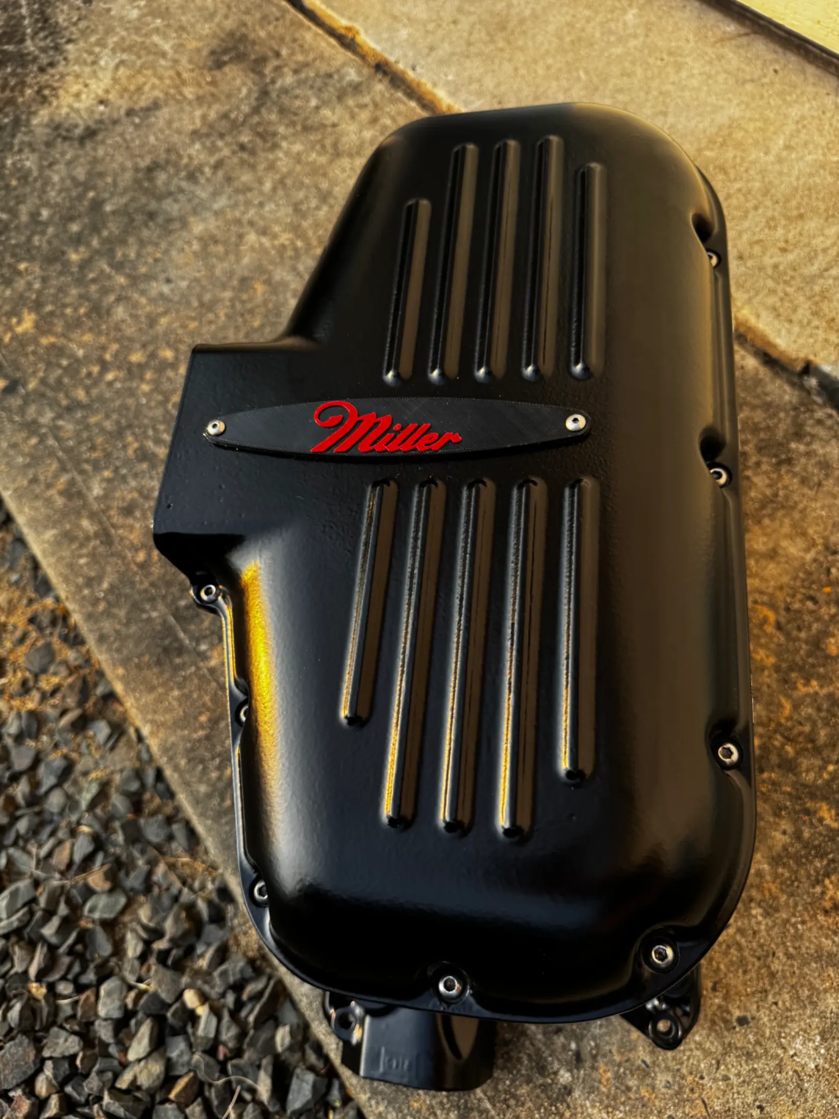

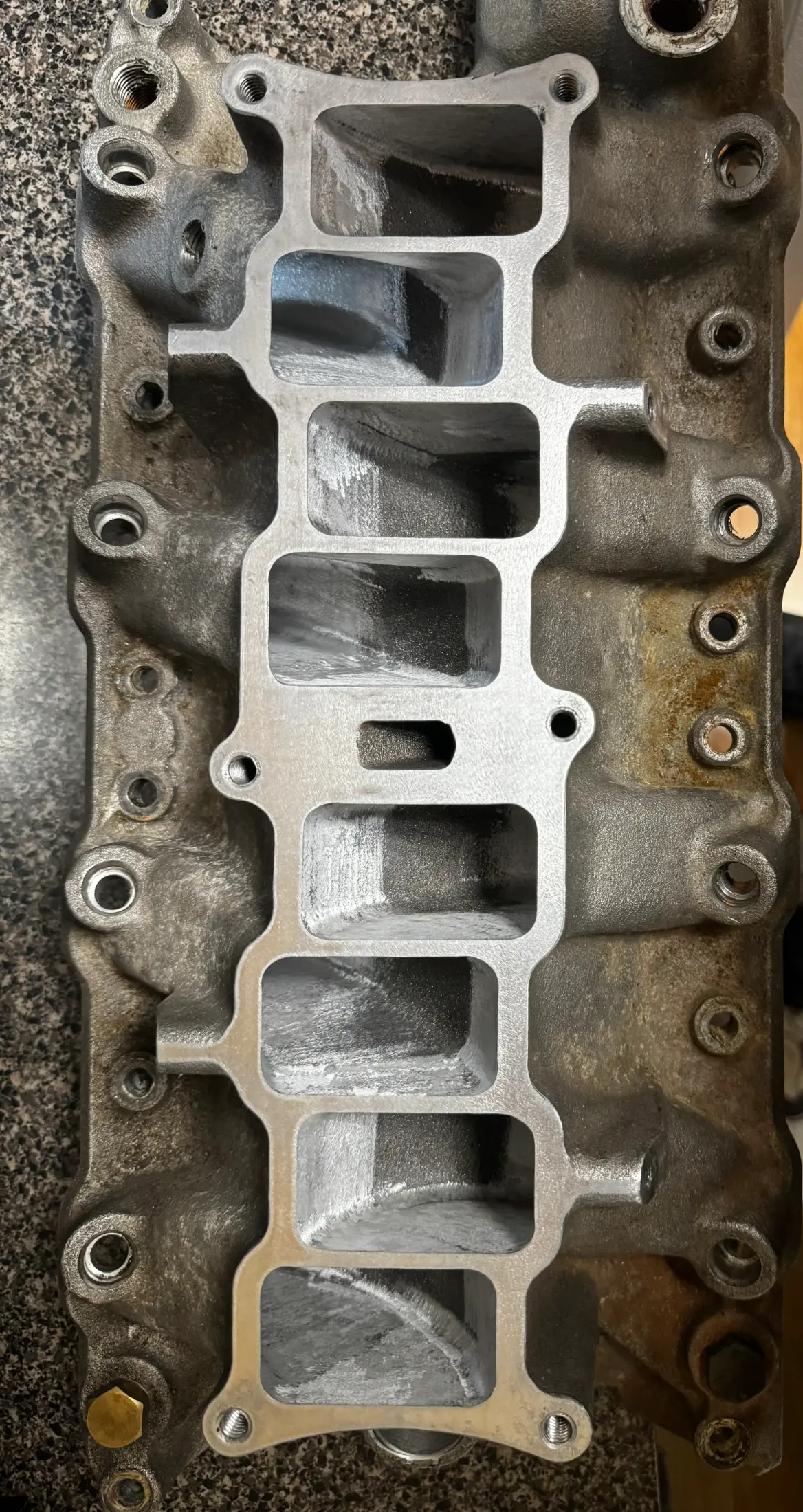

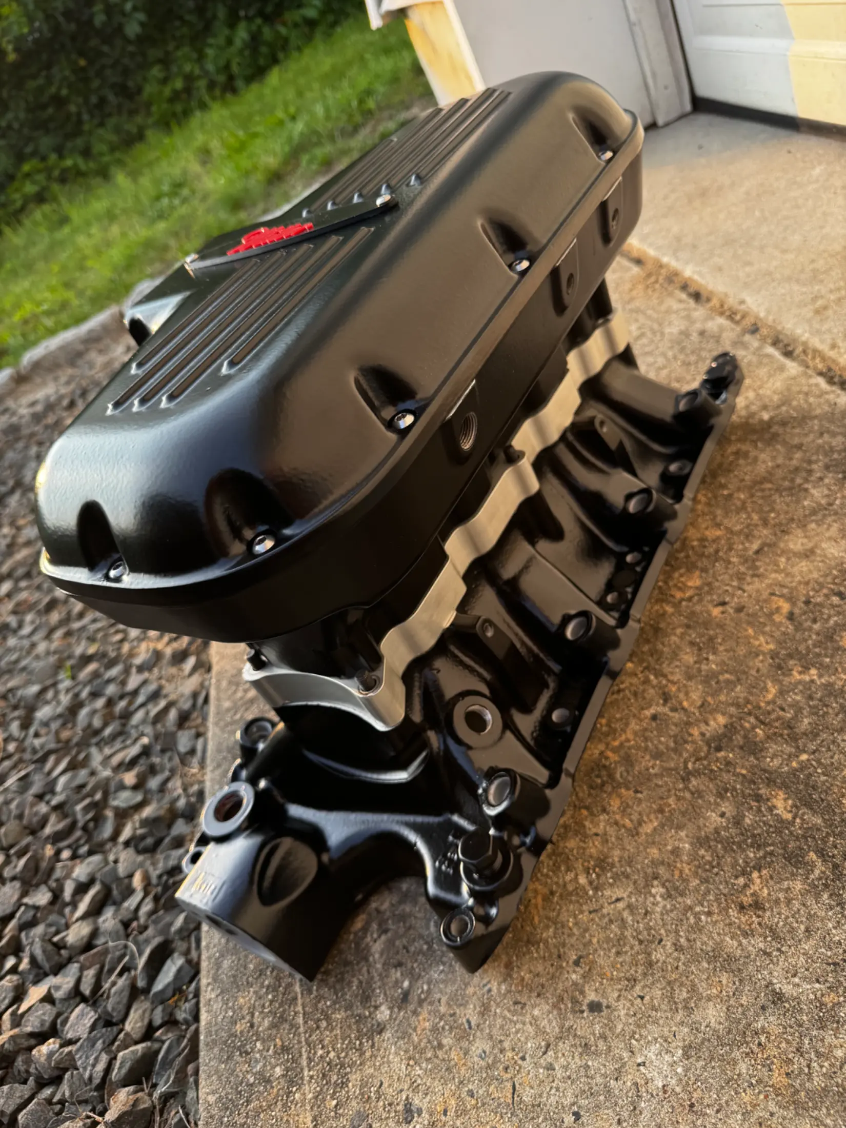

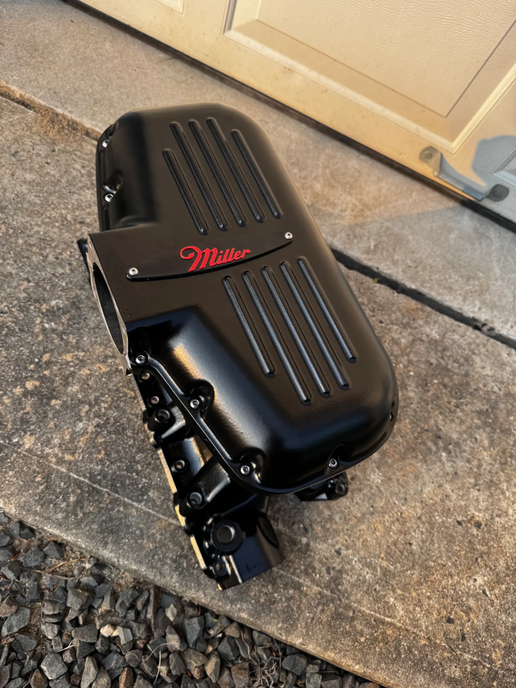

Cars been down since April . Changed the oil found a c clip in it which led me to finding it was a c clip from the plunger of my morel short travel lifters.
This is semi my fault as there was some miscommunication between me and the engine builder. The engine was set up as if it were a low lash solid roller when it reality it should’ve just been setup as a hydraulic at zero lash plus a touch of preload. 5 years I haven’t ever checked the lash so I’m thinking this played a part.
So I grabbed a fresh set of head gaskets and some new Johnson short travel lifters for it and it’s almost back together. It’s also getting some new jewelry. Trick flow r intake ported by tom moss.

That intake plaque is big t1tt1es. Really cool.
