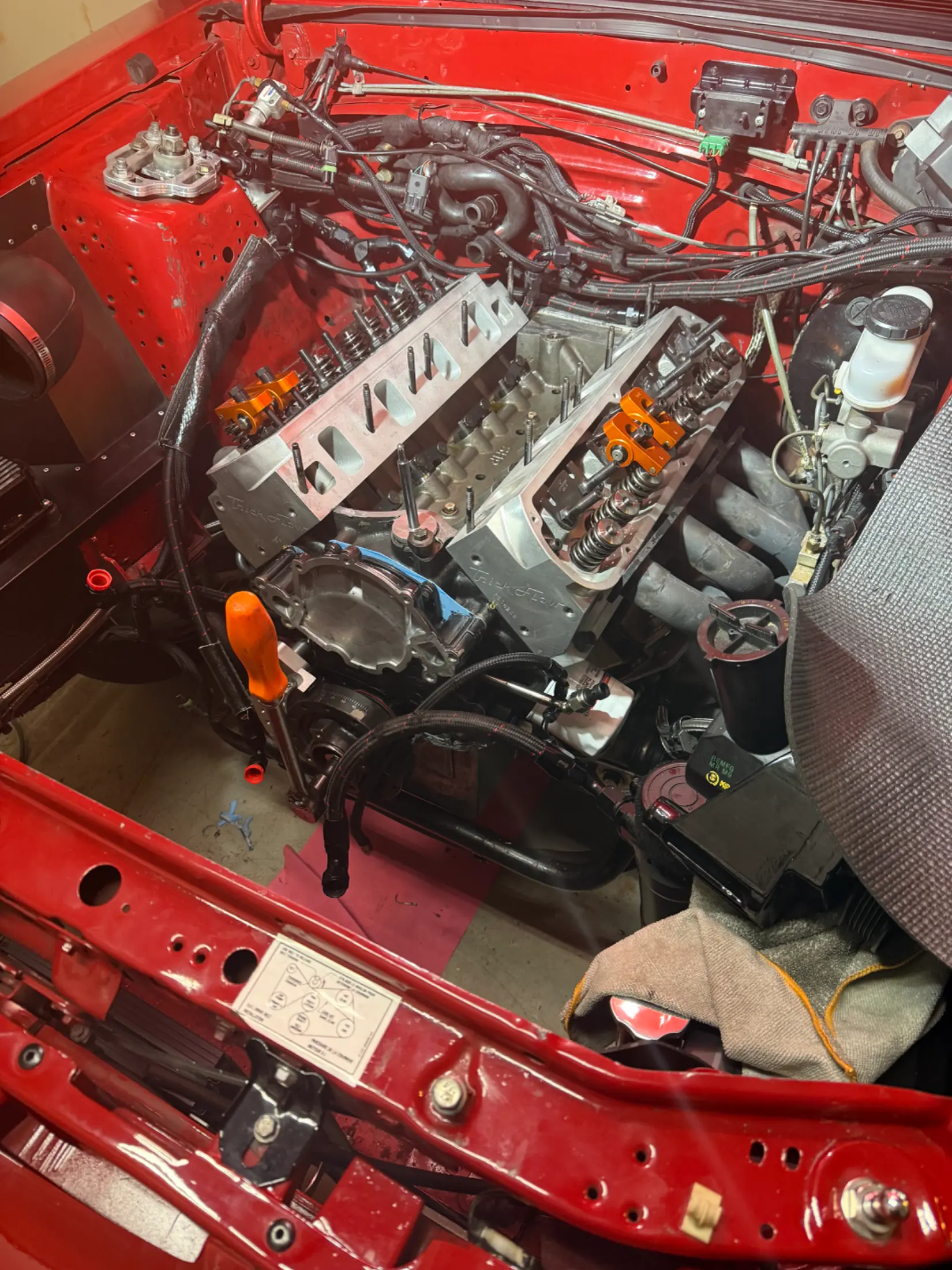

Cars been down since April . Changed the oil found a c clip in it which led me to finding it was a c clip from the plunger of my morel short travel lifters.
This is semi my fault as there was some miscommunication between me and the engine builder. The engine was set up as if it were a low lash solid roller when it reality it should’ve just been setup as a hydraulic at zero lash plus a touch of preload. 5 years I haven’t ever checked the lash so I’m thinking this played a part.
So I grabbed a fresh set of head gaskets and some new Johnson short travel lifters for it and it’s almost back...

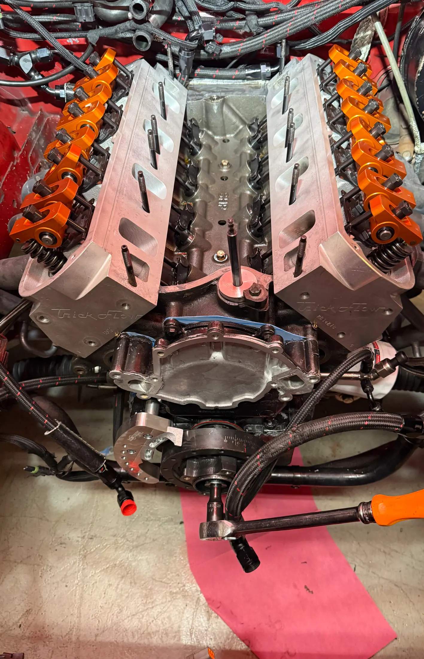

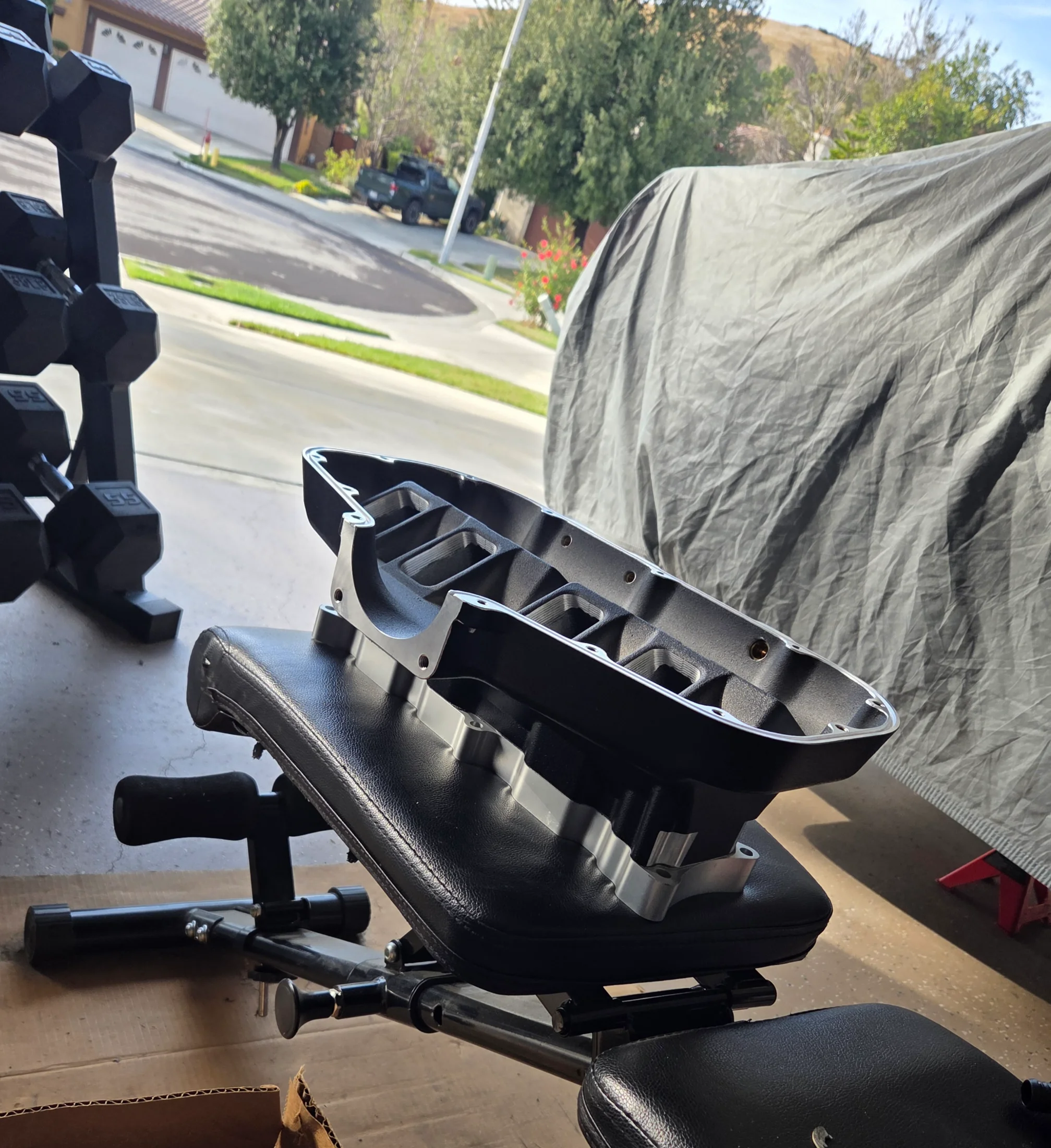

The Box R comes with that spacer. I need aftermarket fuel rails and will likely need to move my fuel pressure regulator. Curious now what other challenges await on this install.
