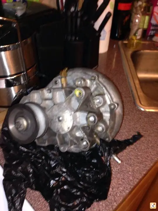

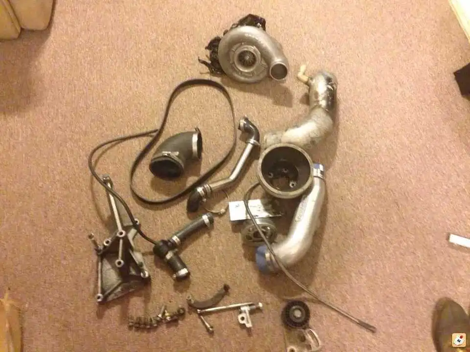

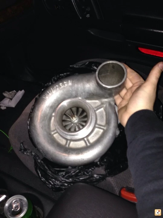

Stock heads , stock cam , gt40 upper and lower .... gona throw a aeromotive 340 drop in and prob 36 or 42s with a pro m and have it tuned
Cool...that should work nice...what psi you looking for?....the stock springs are a little weak I found that out when I was running a blower on mine...Hense why I went to a Set of TF 170cc heads...when I went turbo...Should be a nice set-up and fun to drive...sometimes I wish I kept my car more simple...lol
