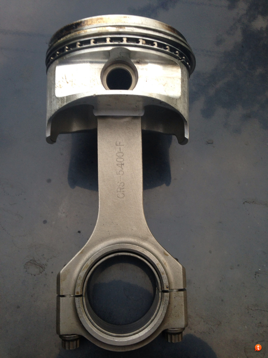

Well last night I had a brain storm and remembered I have 500 dollars in rods and 700 in custom pistons from my old motor . so I am building the motor with that just waiting on taxes to move foward . slowly but surely
so it will be a long rod 306 like my old motor
