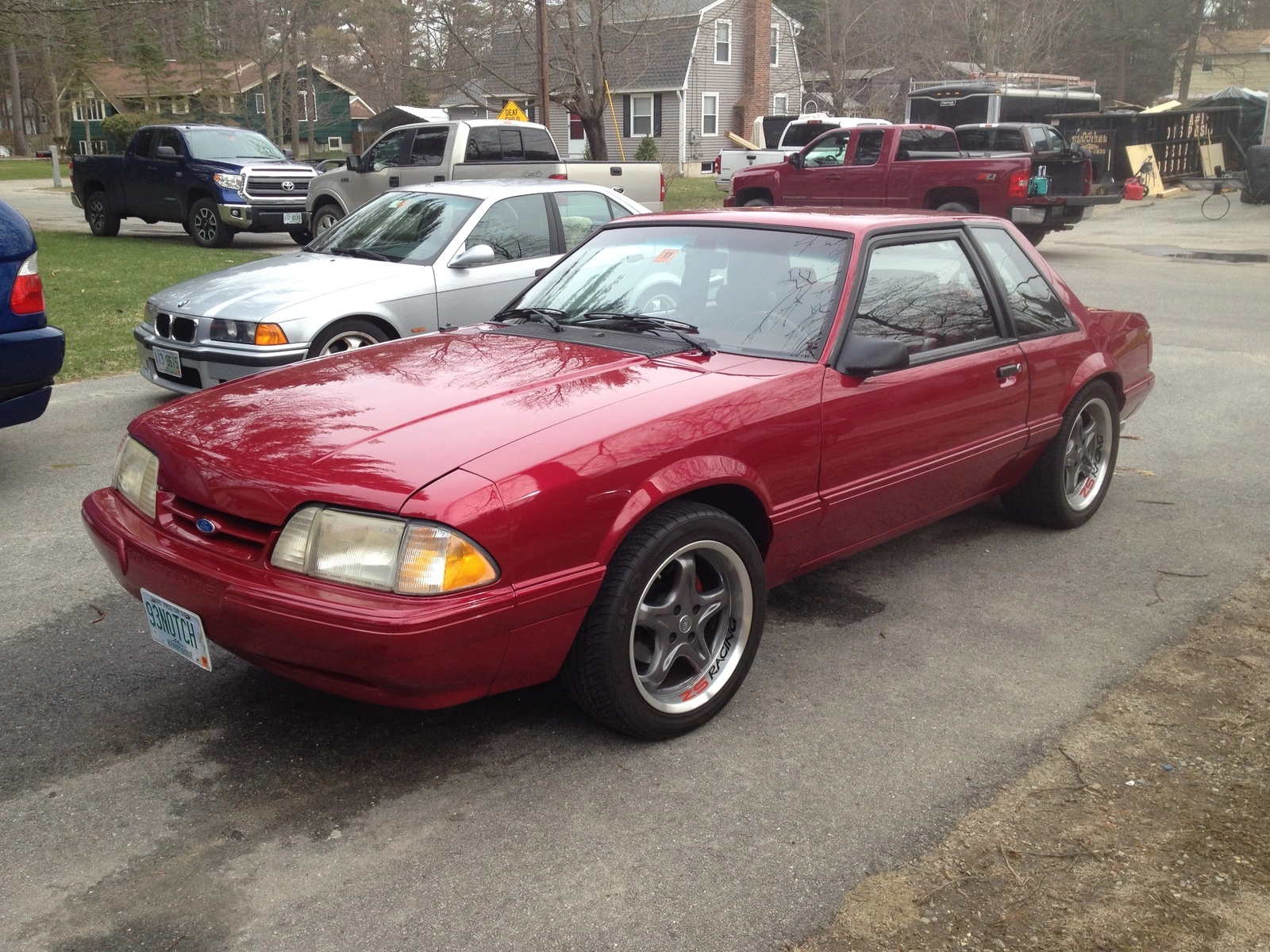

This was an amazing ( 6 -8 beer thread) to read through. Such a journey man, such an amazing job as well! Congrats! Gives me more (not that I need to spend more) ideas for my latest fox (6th one-pictured). Awesome job Jeff!
