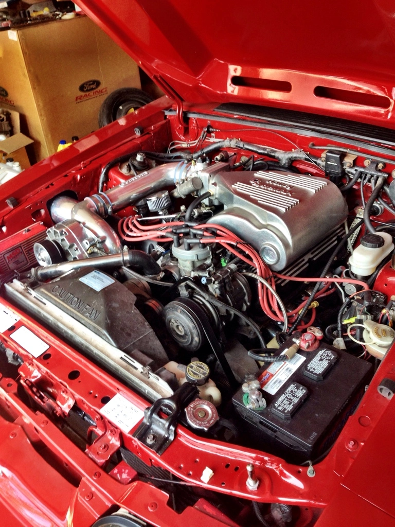

Ok so first today I unplugged my 02 harness and made sure the pin was good in it re connected it . I rechecked my maf extension and followed @smkshw advice and low and behold I have maf reading now . I sprayed for vac leaks I don't have any but as I am fixing the stuff the car is idling better and vac is coming down toward where it should be . if get all this ironed out I'll throw the new 02s in and then just have to figure out what's up with the MAP still but were getting better here
so next is the vac I had the line pinched I completely re routed it . so were seeing vac . Next issue is I have a small oil leak from the rear of the lower I am gonna pull the upper and try and run a bead back there and hope that fixes it because I really don't want to pull the lower there must be some small pin hole where I ran my bead of silicone .
well I ran the bead behind the intake crossing my fingers it works . but until then here's me
being a whore
Well gents I am here to report my permatex bead worked and I am no longer leaking oil out the rear of the intake ! We are ready for a tune
