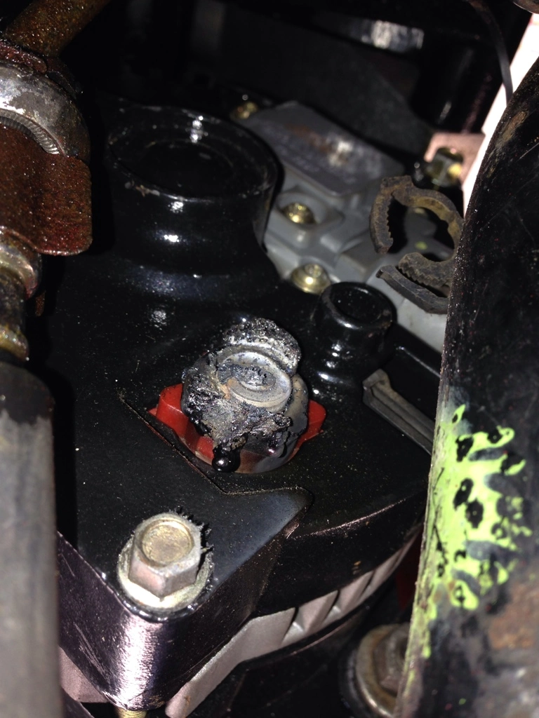

so I am sure this may have been part of the tps dropping out and :poo: apparently either the nut backed off or the fox pulley I had was over spinning it because now with the vortech we are back to regular pulleys so now I am getting. a new one maybe Monday I'll throw it in I don't even want to look at the car right now I knew i smelt something I kept checking and I finally got under the car

That alt looks like a loose connection or the wire is too small gauge, dont sweat it luckily nothing major just replace with good 8 gauge minimum (4gauge even better and what I would run) and make sure nut is tight (and not stripped on the inside and freespinning in the case)
thanks brother I feel it backed out as well it's a 4ga with a big fuse in it that I bought as a kit over a year ago it was in the car for a while with no issues before - I have the alt I just need to tear it down and swap it .

well boys the alt is in with the right size water pump pulley . instead of playing games with belts I measured this one out and got a belt for it I have to just change the terminal on the alt wire and blower belt back on and well be up and running I think should be later today if not tomorrow .

So I crimped a new end on the alt took the car out and had the tps flip out again . upon further investigation I find that the aluminum stripped out and it's the TPS is walking around on the tb so that explains it . I swapped the ring off my old 70mm bbk and no more issue .
