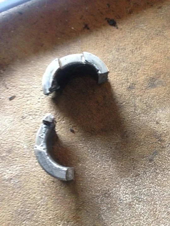

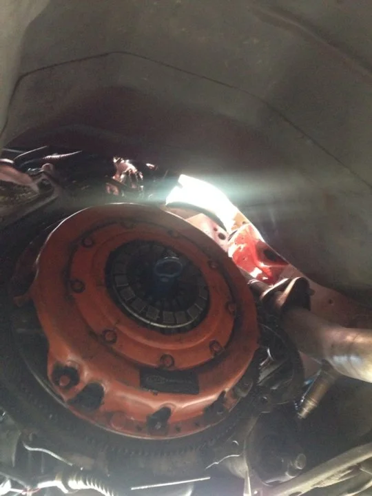

actually just woke up worked all night . going to my garage now to put it back together . pulled TRANS pilot Bearing in two pieces . have new pilot , new fly wheel and dowel pins

Alright so its all together , No more vibration until 4k. 4k up into 5k and it kind of smooths out again. It drives like it did before we had the issue when i woulnt put it in boost before it was tuned no vibrations on the low end car drives smooth. At about 1050-1100 if you are stopped right before the idle settles you get a small shake in the wheel like we had but goes away as soon as the idle settles.
Ill put it this way its much better that i am not scared to drive it any more. My next move is to swap the motor mounts out . It has 50 resto cheapy poly mounts in it and maybe try a rubber mount and see how it is .
