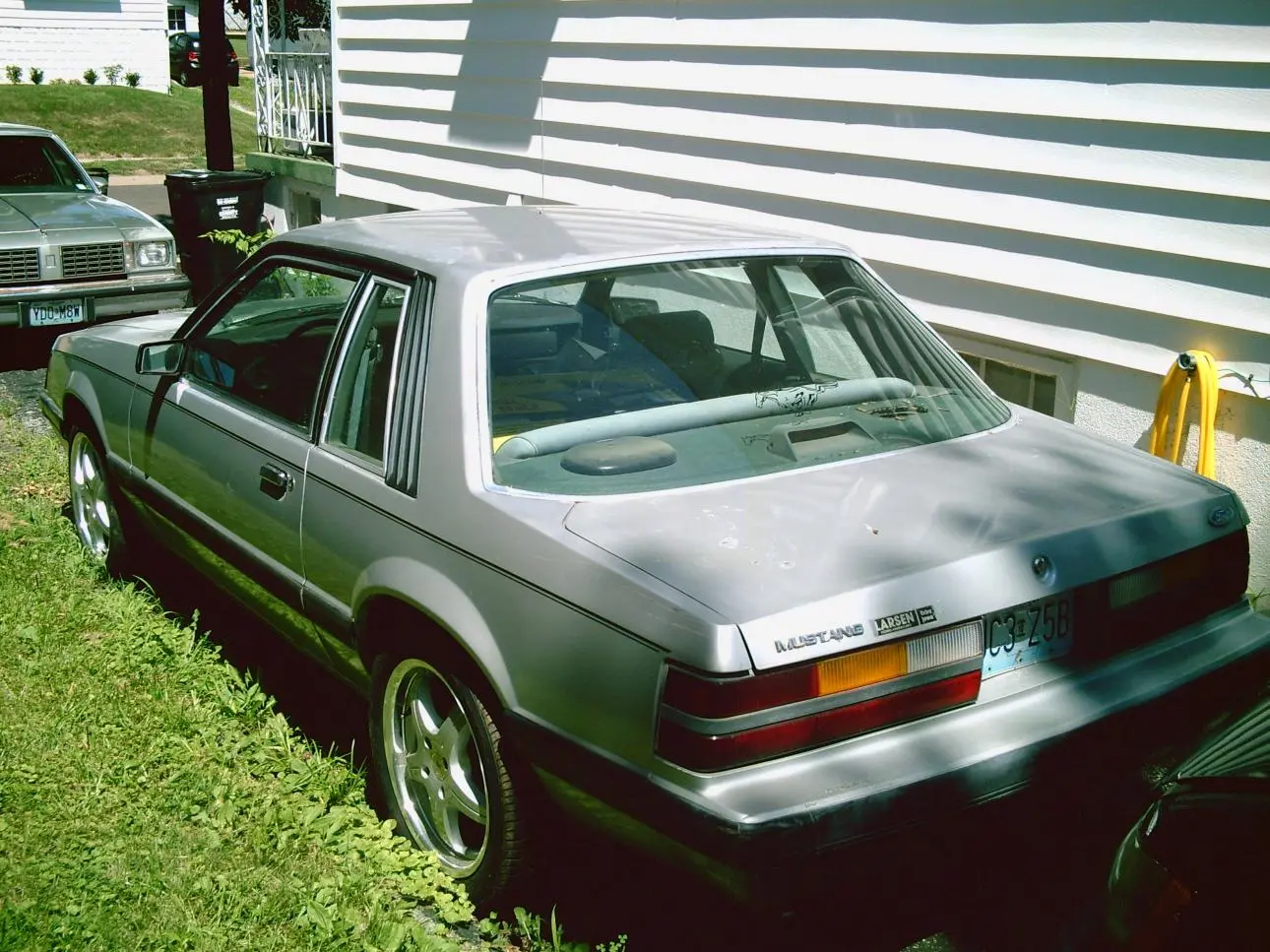

My winter project!!!!
1986 4 cyl
What i have all ready
Stock bottom end
GT40Y heads
Anderson cam N-41
Air Gap intake
750dp
BBK equal shorties
Pypes X pipe
Dynomax Ultraflo cat back
T56 6 Speed
Car will ride on Pro stars with 275/50 Dr's
Would like the car to be a solid 12.3-.40's car
Is this doable with what i have.
Is there any thing i should consider changing?
Take the Y heads to the machine shop for valve job, bowl cleanup, spring seat pressure.
I had a set of them new, ford wasn't known for a good valve job back then.
May cost you $200 for the work, but it's worth every penny, makes for a better running and more powerful car. Especially if you are looking for a 12.50 car.
