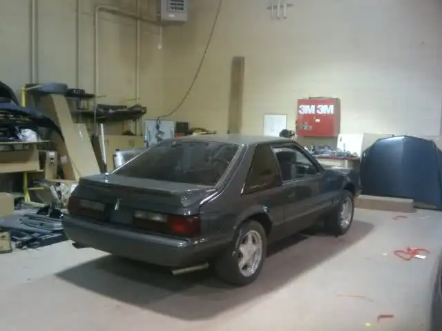

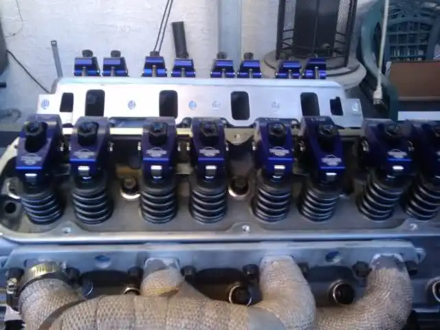

painted it complete during the downtime, heres some pics:

Did you take the heads to the machine shop? They are known for all kinds of issues, i didn't realize until recently they are the old pro topline.
30's will be fine, use any pump 155lph or bigger.
In a NA situation 30's will support over 400rwhp, and so will a 155.
I bought them bare and had them assembled by a cylinder head guy in town with comp and manley pieces. he also cleaned them up. only issue I had was the stock intake gasket not lining up with the water jackets.
