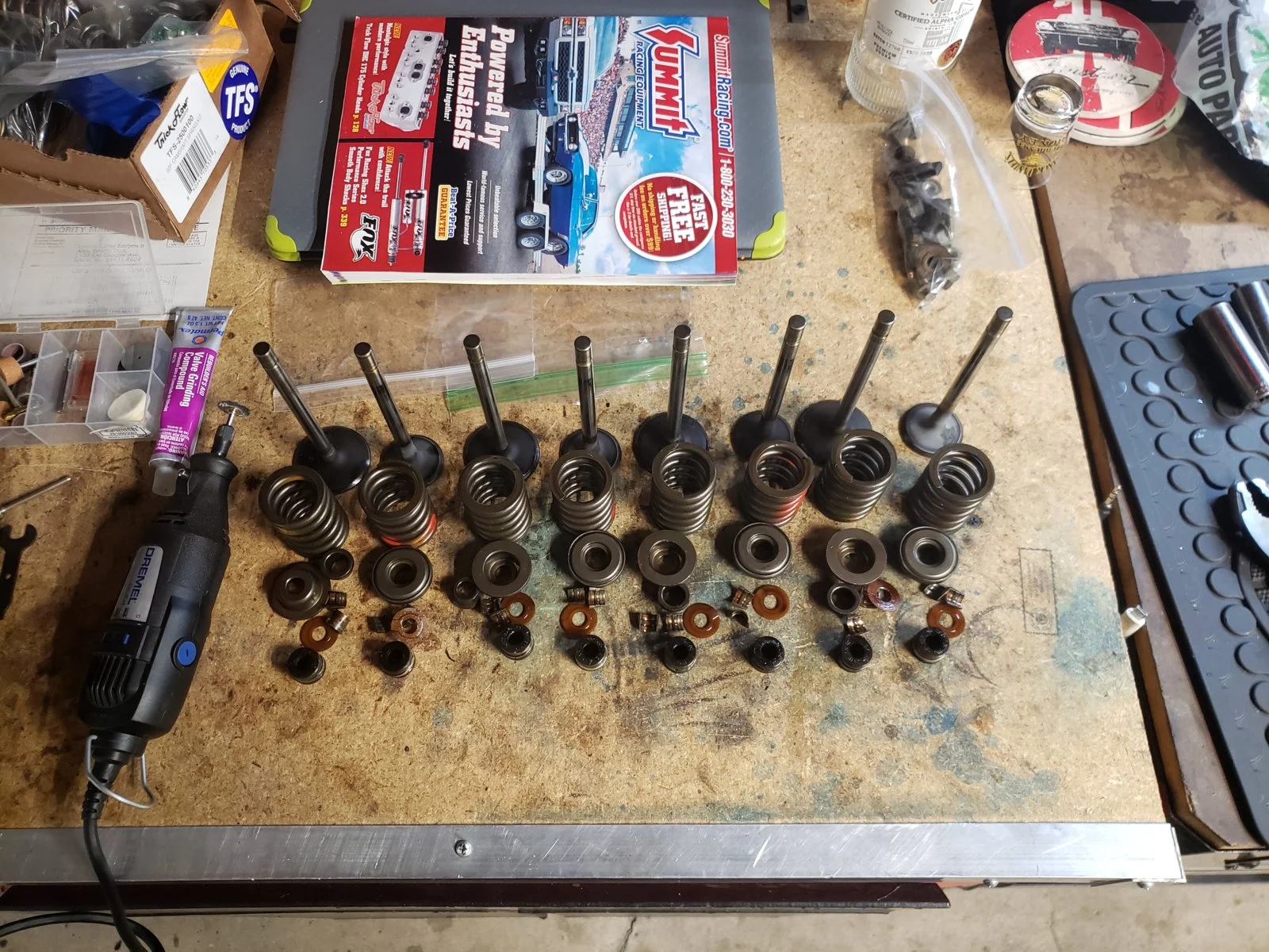

Progress Thread Project 302
With valves.

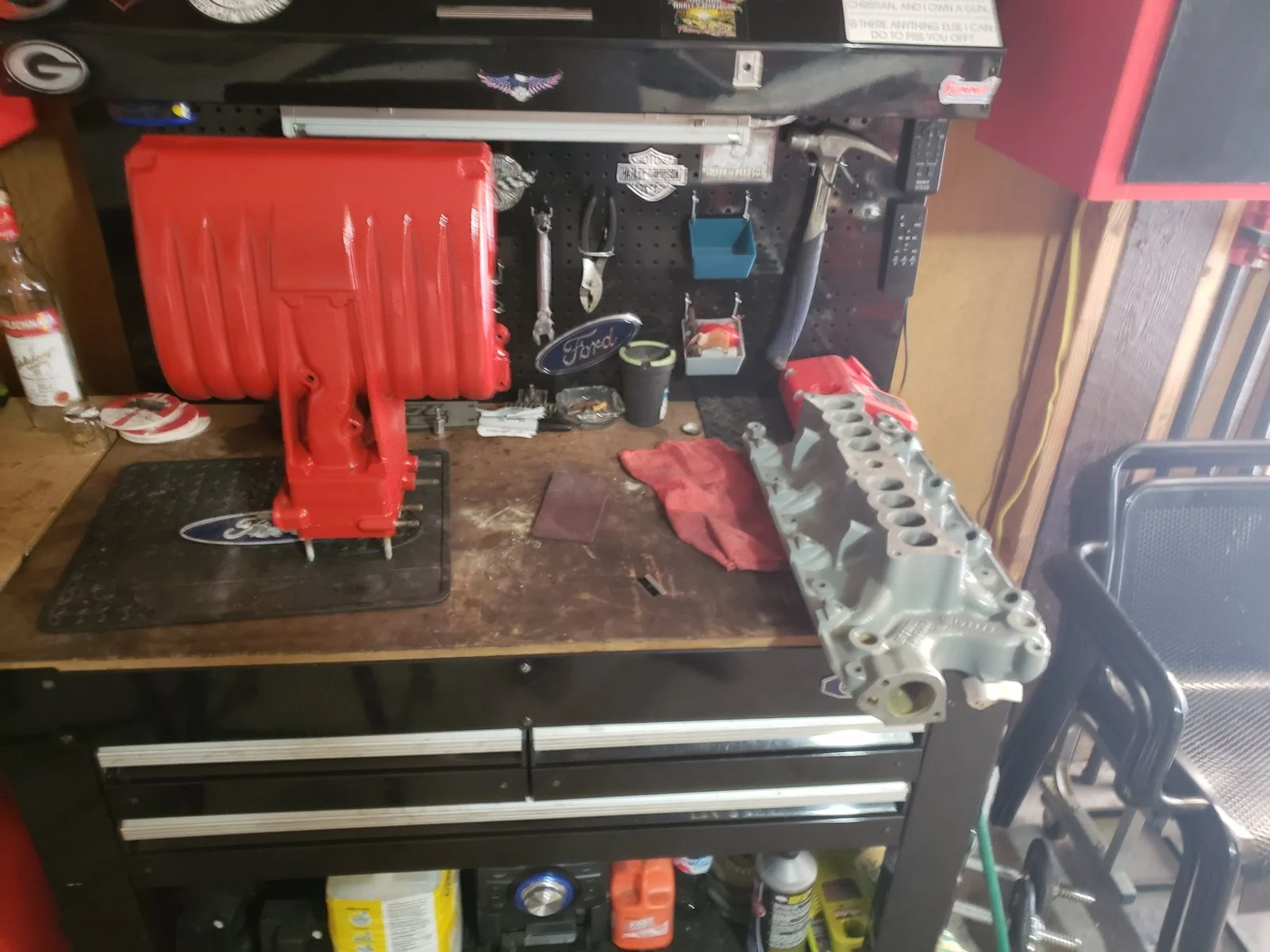

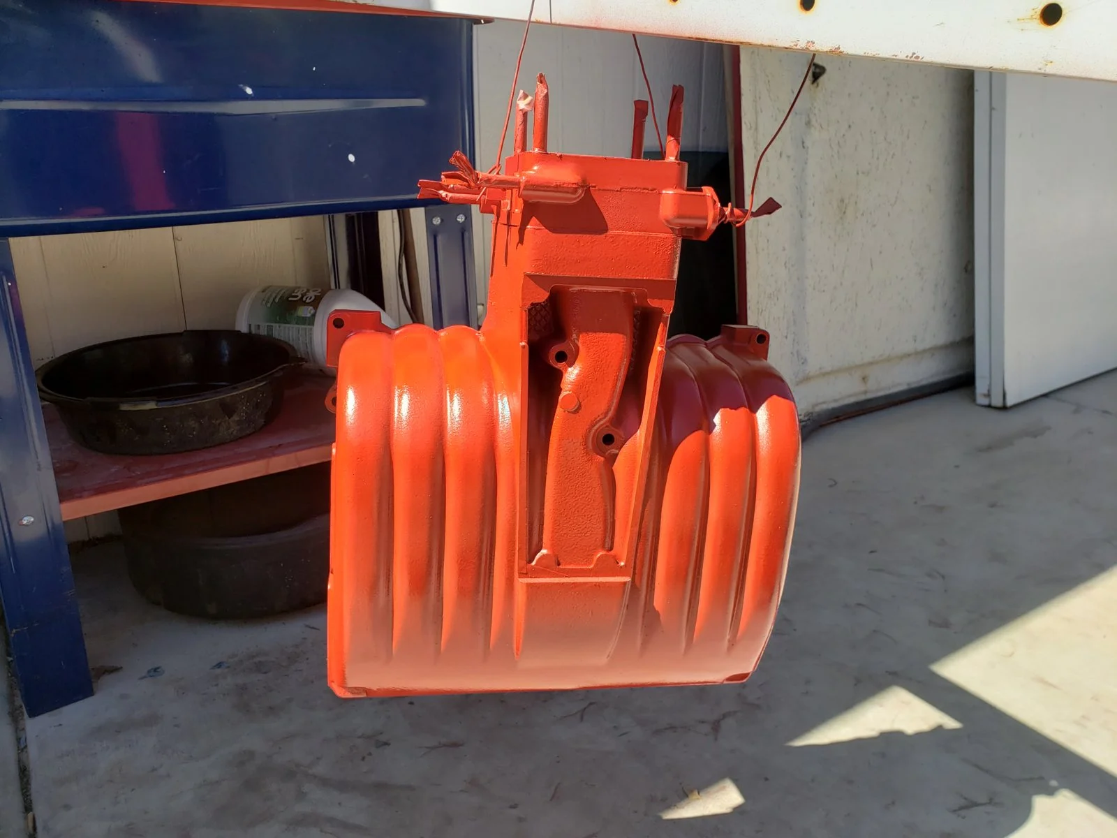

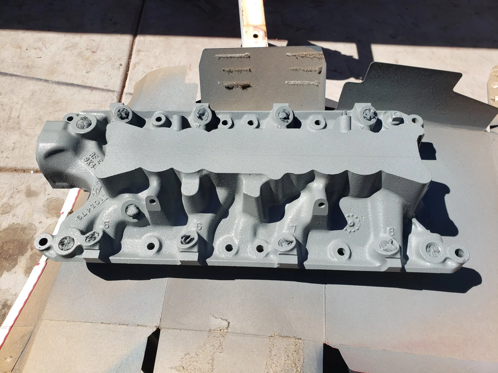

Upper and lower intakes are freshly painted. Ford red and Ford gray.
I never would have thought that oven cleaner would work so well cleaning out the intakes. Damn near spotless. I'm definitely keeping a can of that around.
yeah, I used that on my explorer lower, and my stock oil pan to remove all the tarnish... works great... BUT make sure you don't leave it on long on the Alum, and wash it really good, I heard it will eat it...
