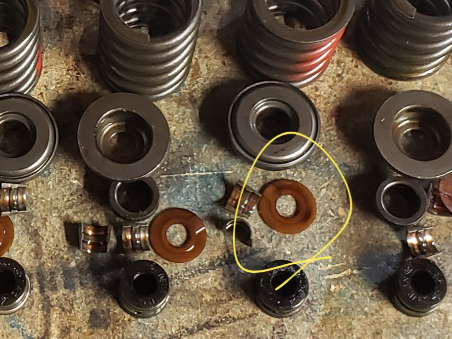

Okay so when I took the new (to me) heads apart I got these little brown disks. Any idea what those are for? And should I use them with the new springs?
Which brings up another question, the old springs were different sizes from exh. To int. And yet the new set from trickflow are all the same size, is this correct?

If it's the Trick flow spirng kit you bought for the GT40p heads... then yes, the springs are all the same size, it's the retainer that is different between the intake and exhaust. But make sure you did get right ones... when I was installing them on my reman gt40p heads... I found out I got all (can't remember which now) all intake or all exhaust retainers... which will make that valve spring retainer the wrong height for the (again either intake or exhaust can't remeber which). so I had to call them up and have them send me the right ones I needed... I guess I was the lucky one that got that screwed up set.
