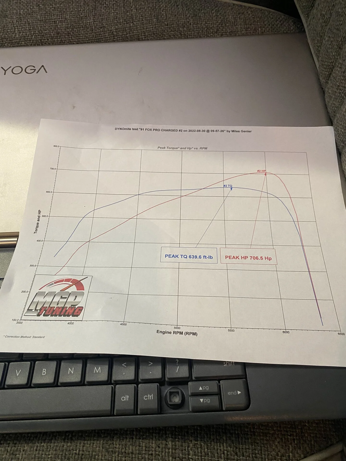

Dyno’d the car today.

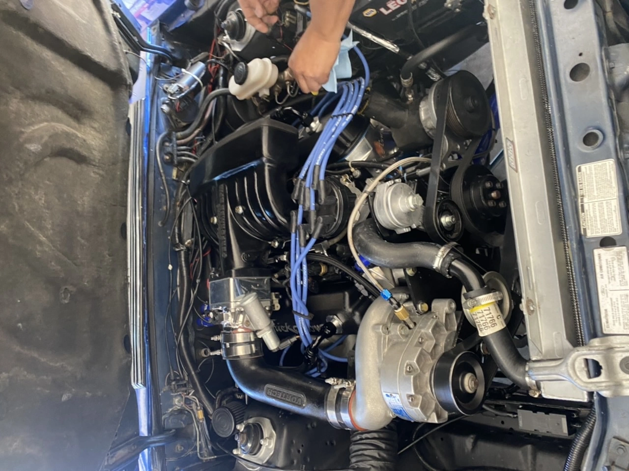

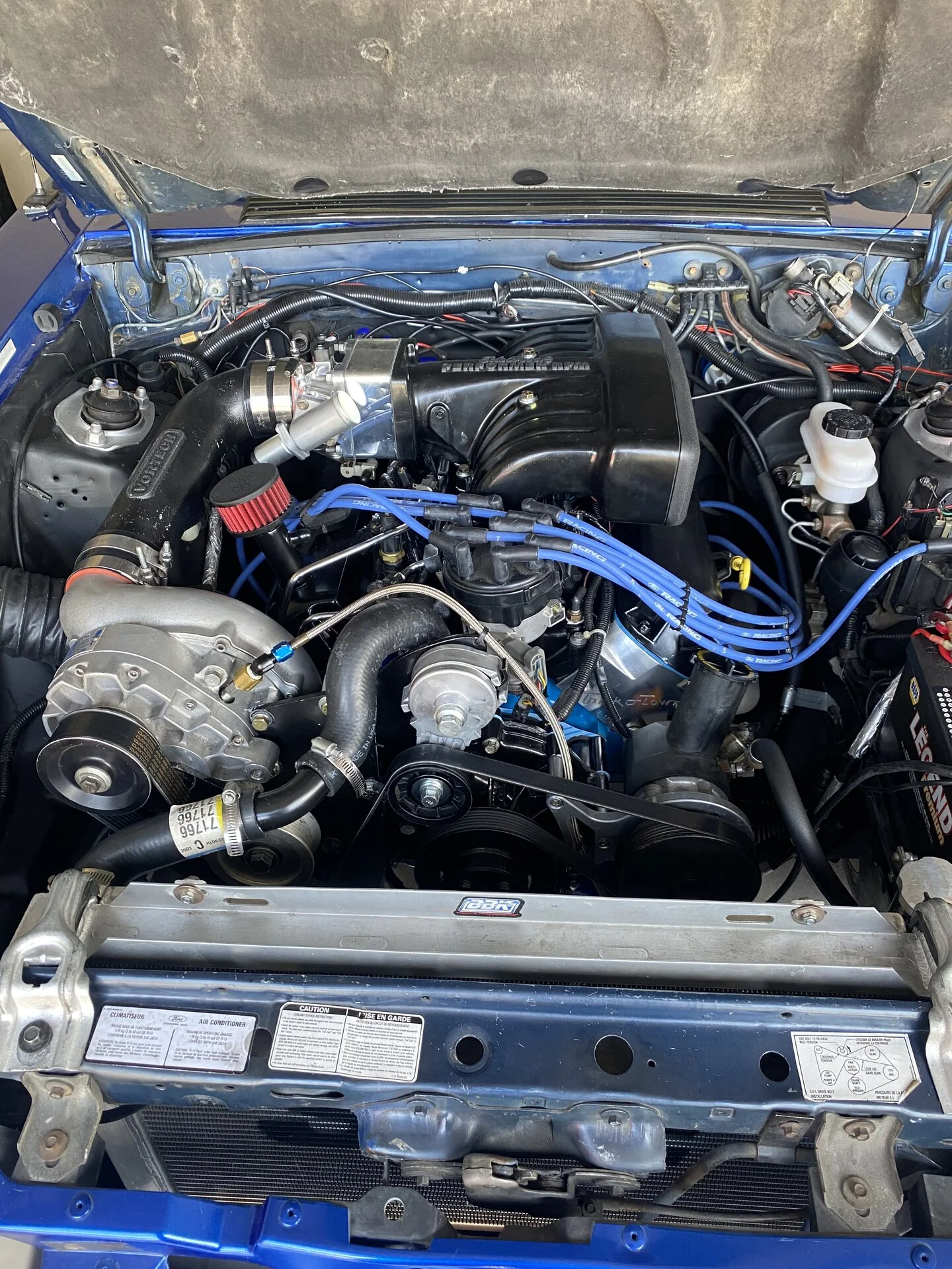

Got my friend’s vert all finished up. Did a performer rpm intake, 190cc 11r heads, and a summit e303 plus camshaft. Ended up having to retard the cam 4* to gain intake valve clearance, but wound up with just over .080 and miles on the exhaust. With the v2 on it, it’s a really fun cruiser. Running a pimpxs with 80lb injectors.

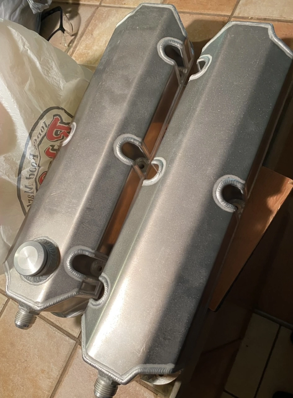

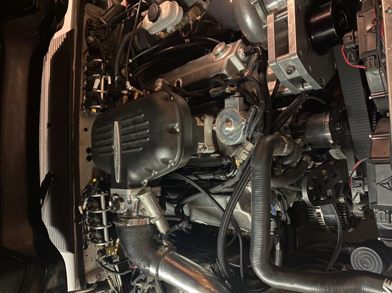

Got the bungs welded on. I like how these are about an inch shorter than the trickflow ones I had on. Gonna run them for a couple days and then take em off and send them to powder coat.

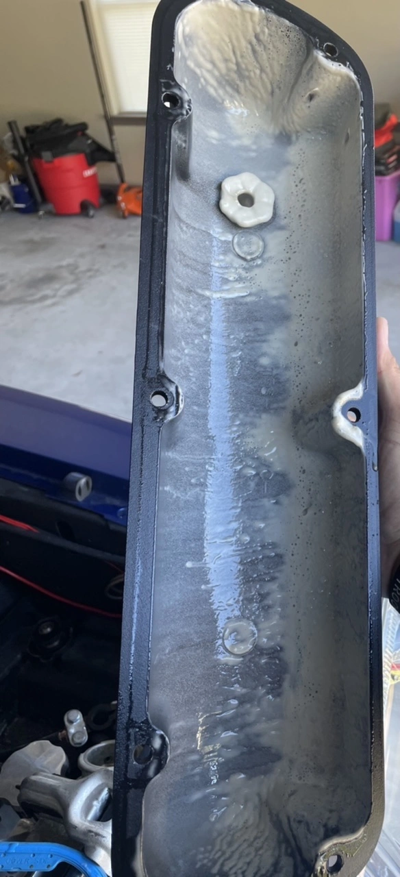

Got my friend’s 87 vert 100% done today. Did a motion breather can setup, and got some short trick flow valve covers on with some screw on an fittings. I’ve never used them before, but they seem to be nice.
306 with a hyper replacement piston, v2, 190 11r, performer rpm, long tubes, and a summit e303 plus cam. It’s a really fun cruiser to drive around. Plus it’s got some big ass flowmasters so it’s quiet as hell.

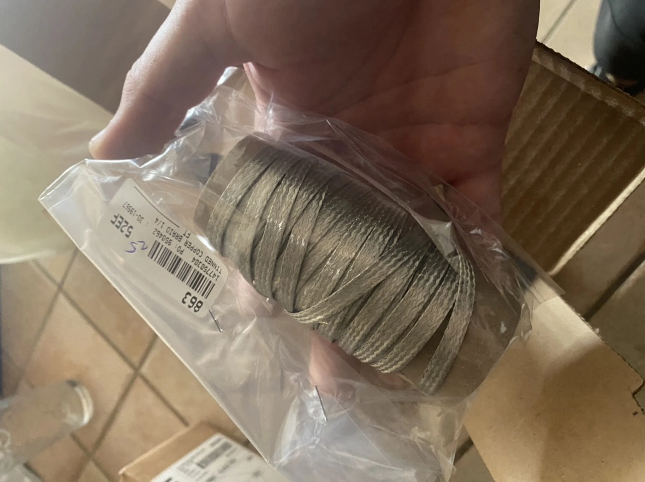

Also, got some sheathed wire as well as some alpha braid to get the traction control wiring setup. Will be using a front abs reluctor and the trans vss

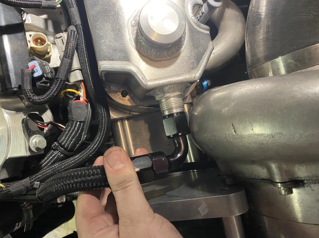

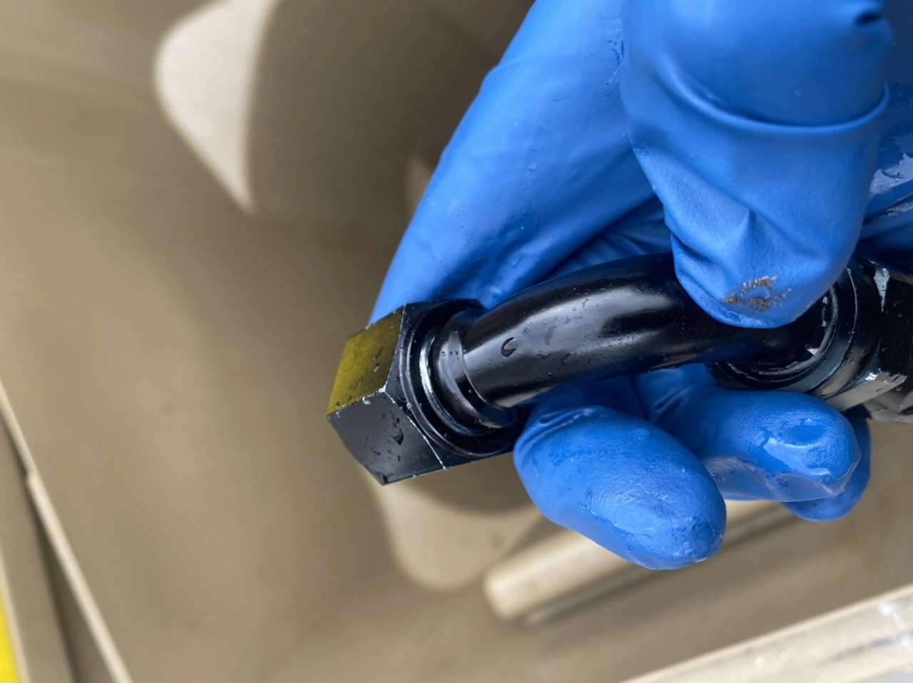

Little PSA for anyone running the evil energy brand of an fittings you can buy on Amazon: watch out. This one developed a crack on the neck after a couple miles. Luckily it was just on a breather line of a friend’s fox as I refuse to use them on fuel lines
I use them all over my projects, I have not had any issue with the evil energy brand personally. I suppose just like anything else it can happen.
The only fittings I’ve ever had issues with are the Amazon ones. I have friends who have used their ptfe stuff with good success, so it’s definitely possible it’s rare. I’ve just never seen a -10 crack like that.
maybe it was overtightened? or the fitting had weight applied to it [like a hand on it when leaning over the engine?? :shrug:
Nah, it was honestly barely even snugged since it’s just a breather tank line. Really you can put a decent amount of torque on an fittings without issue. It was only a couple days old and no maintenance had been done on the car, so it wasn’t leaned on.
:poo: just Happens sometimes.

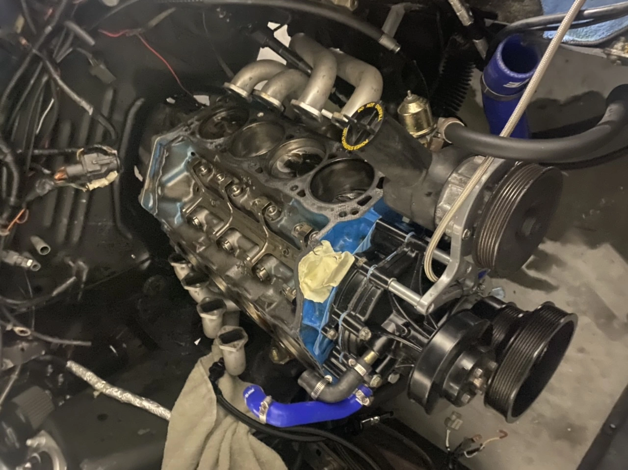

Unfortunately, George drove the car around, and his coolant temp sender is really finicky. Long story short is the thermostat decided not to open, or the water pump impeller failed because the engine got HOT. Cooked a head gasket on both sides. Smoke starter pouring out the tailpipes, we pulled over and the radiator was stone cold. :leghump:

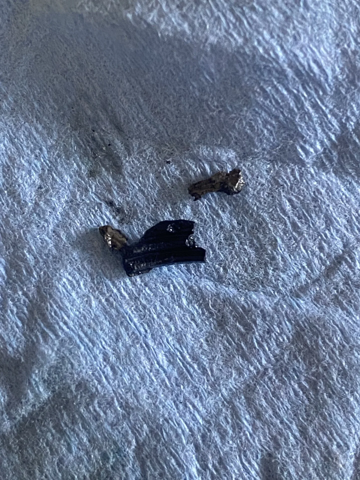

Been roughly 3000 miles so it was time for an oil change. A bit of an alarming discovery again on the drain plug. This was on there.
I’m talking about the large black piece that is. It kind of looked like a piece of metal, but it turned out to break apart like plastic. I’m concluding it’s loctite that fell into the pan when I removed the flywheel a few months ago, so it’s all good.
