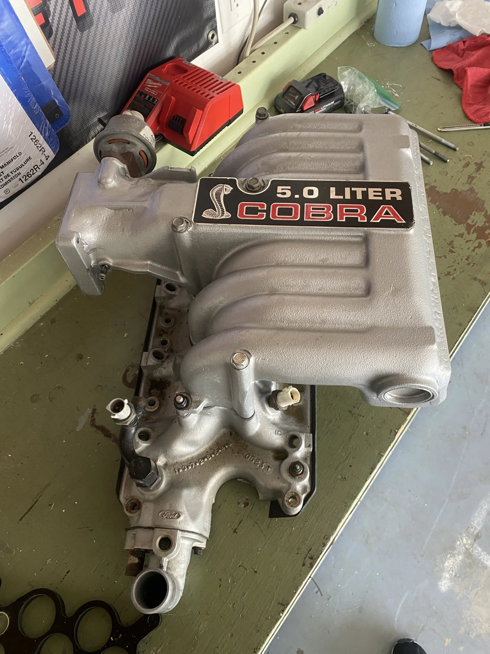

Let’s see what this ported cobra intake does. A nice fella sent me this to try out

Saw the thread over on the Corral...them boys are not fans of Bigdogs Porting. Be curious to see what the results are.

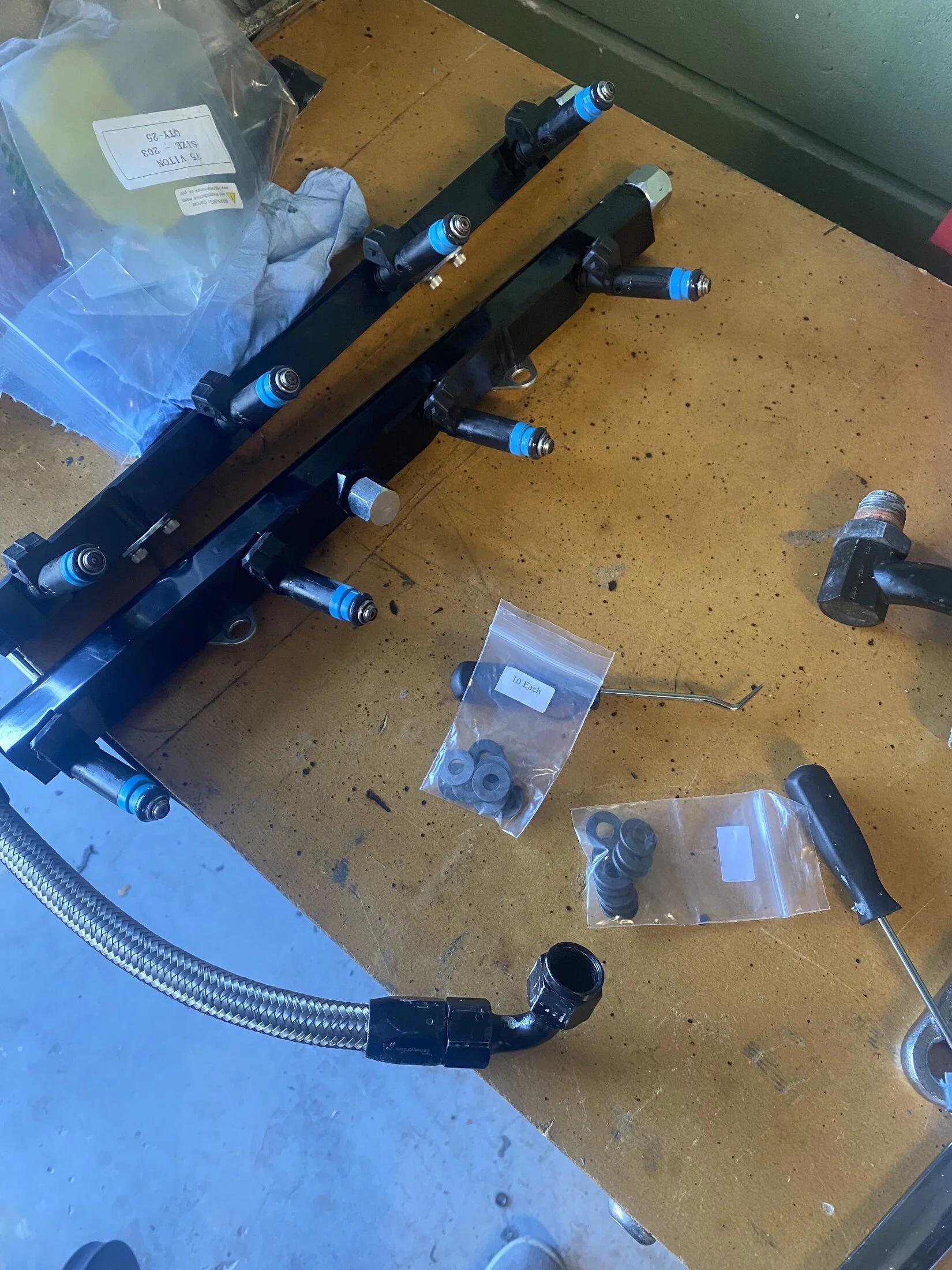

Took the time to change injector orings. Also have some hard composite washers for spacing the fuel rails out. Help from them beat soaking.

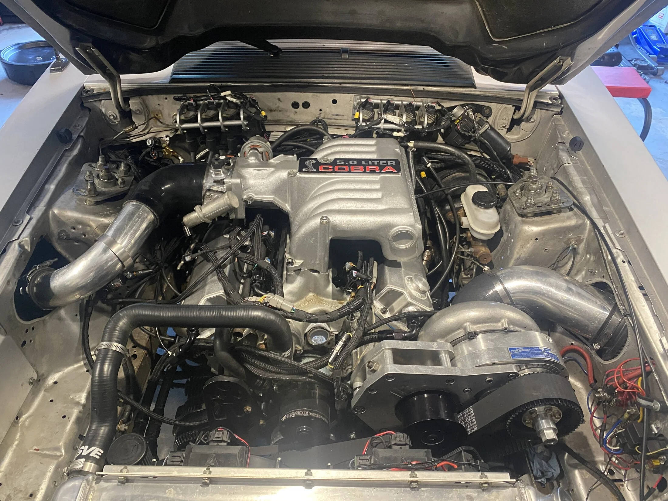

Got the upper on, barely fit with the coil mount brackets. Kind of cobbled together the vacuum lines, but they’re not permanent so I don’t really care. Also had to make a new tube inside the fender well since intake is so damn short. Moved the fpr a little too.

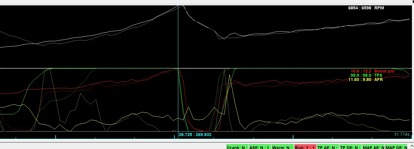

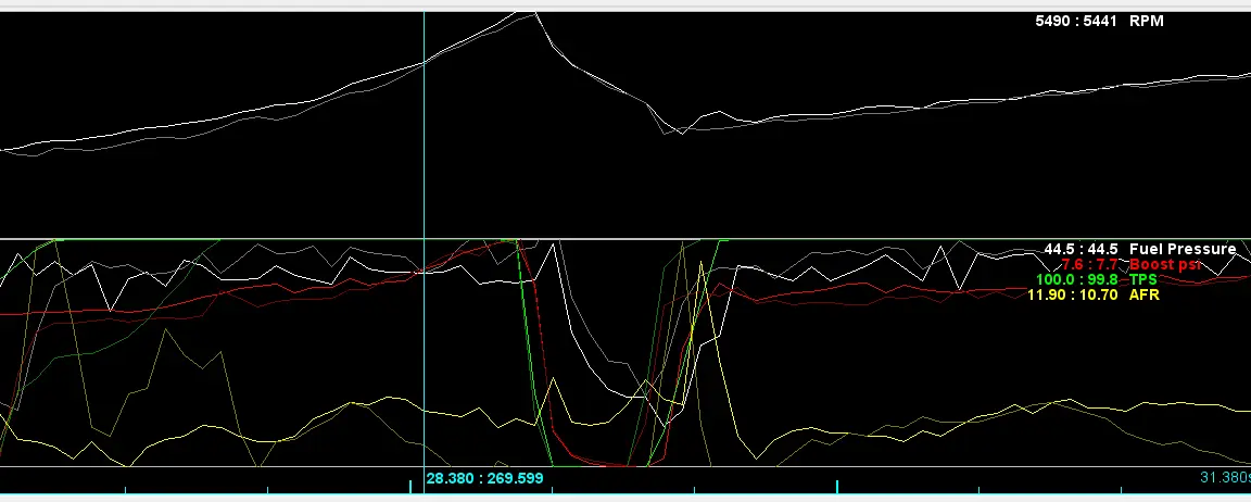

Took the car out with the new intake. In the datalogs the box r values are on the left hand, ported cobra on the right. After about 5500rpm the cobra starts to make more boost, so it would be a bit of a restriction. Blower doesn’t really care though. Seems to be a bit richer with the cobra intake, I’ll have to change some of the ve table.
Honestly the cobra feels really similar to the box, like it’s not like it feels like it makes loads more torque or anything.
